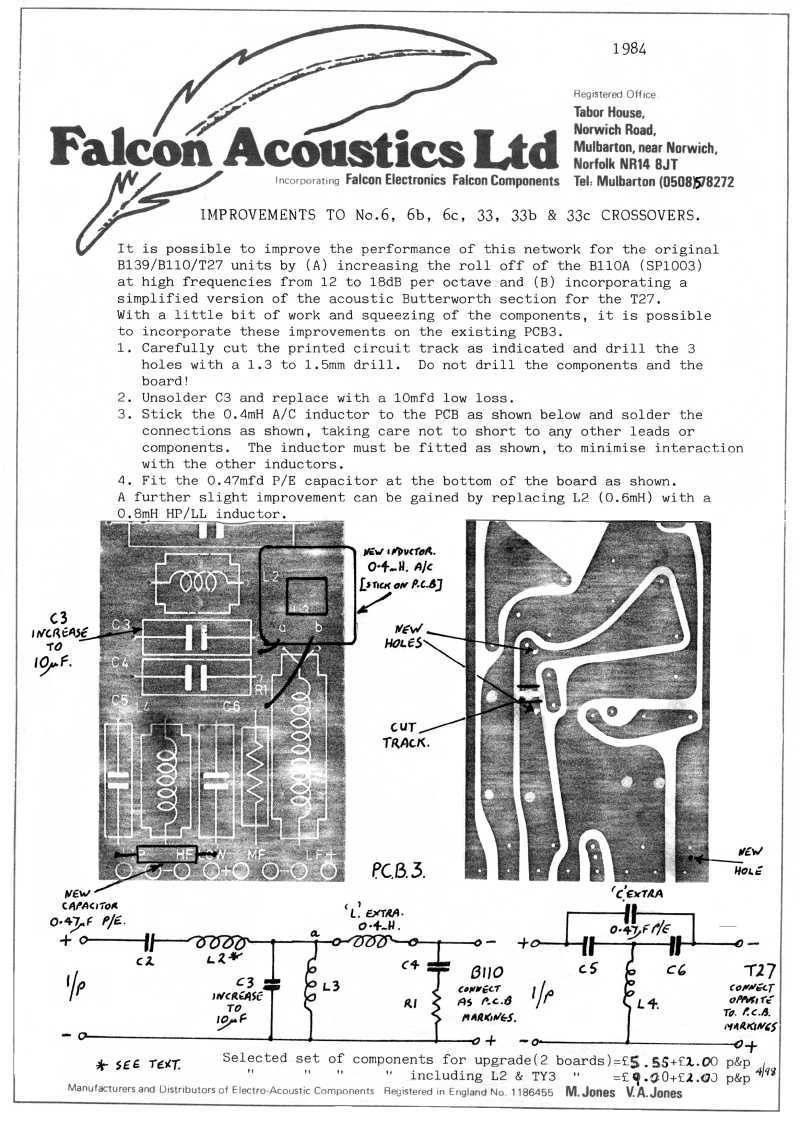

don't give up on Concertos, they're great and worth investing some time/money on them but IMHO they DO need the acoustic butterworth variation and better inductors. Check https://www.diyaudio.com/community/...d-dn12-crossover-with-full-ab-circuit.370666/
I used Eschenborn schematic on post #1 and couldn't be happier, he was very pleased as well... however I changed ALL components 😅and made new boards to accomodate inside the cabs. What follows is product of my layman guessings:
-Thicker gauge air core inductors for tweeter (0,7mm) and mid units (1mm)
-Iron core 1.6mm thick inductors for bass units, changed value from 5 mh to 4.7 mh (*check below)
-Polypropylene 82uf for bass units (probably not neccesary but didn't want to remain asking myself "what if...?)
-Polypropylene 33uf for mids, 3.3uf, 0.6uf (two 0.3uf in parallel) for tweeters
I also modded the inside of cabs, but if possible try at least filling the mid woofer tube with lambs wool (or similar synthetic), use spiked stands and small silicon rubber drops (the ones you get at dollar-euro shops) between stand and speakers.
You mentioned bass... before the mods I felt a lack of lower mid bass*, now it's there, and low bass is deep, physical, no need for subwoofer
It's been a year now since the modification and whenever recordings are up to par I still get the jaw-dropping effect, everytime

Hello Mr. Marintz.
Sorry for my late answer. But thank you for your input.👍
I already read about the acoustic butterworth variation from Mr. Eschenborn .
This modification would make a big difference.
The only problem is that I'm afraid to get started.
Unforunately , I don't have the technical know-how of specialists such as Mr. Eschenborn, system7 (Steve) , etc..:ashamed:
OR , and MAYBE, when I should have a simple, but clear manual of all the different steps to take.
As well as , and most importantly : a clear listing of the different components… then maybe …
Another problem for me is the (technical) language.
Mostly I have to use Google-translate , but even then, it stays very difficult for me to understand all what’s been written.
A lot of DIY-audio-members gave me their advice about changing these COs in the past.
Also Mr. Eschenborn. Who I respect very much.
At some point I was advised to do a simple modification (please see example in attachment).

Hi Eric,
I still believe that you can upgrade the Concertos to extremely pleasing speakers. With the right amplification (high quality solid state) there won't be much more to wish (although the upgrade lust is always lurking). They also need to be on low stands. The T27 is still a pleasing tweeter and the original B110 has a nice midrange. Think of the Concerto with the adequate crossover as a full range LS3/5a. No need to look further – if only for curiosity.
The old Falcon drawings you posted can be used in order to upgrade the DN12 board to what Falcon calls their "improved" version. I tried this simplified aB circuit and found it unconvincing. The Falcon website in your link however shows the whole thing on a new board which cannot be mounted on the baffle. Lots of more tinkering work. Not a good idea. I have not been convinced by all crossover designs Falcon offers, neither by all the cap choices they made for their model-specific recap kits.
I found a picture of another improved network (by Falcon? by KEF?) in one of the last Concertos sold, already with the newer B139 bass driver, see here: https://www.aussieaudiomart.com/det...o-speakers-with-new-crossover/images/1360155/
I think we could walk you through modifying the spare crossovers into "my" version. They will still fit in their places but it is better to turn them around – component side facing outwards. Also the covers will still fit, but the tissue might be pushed a bit outward by the bigger components on the crossovers.
