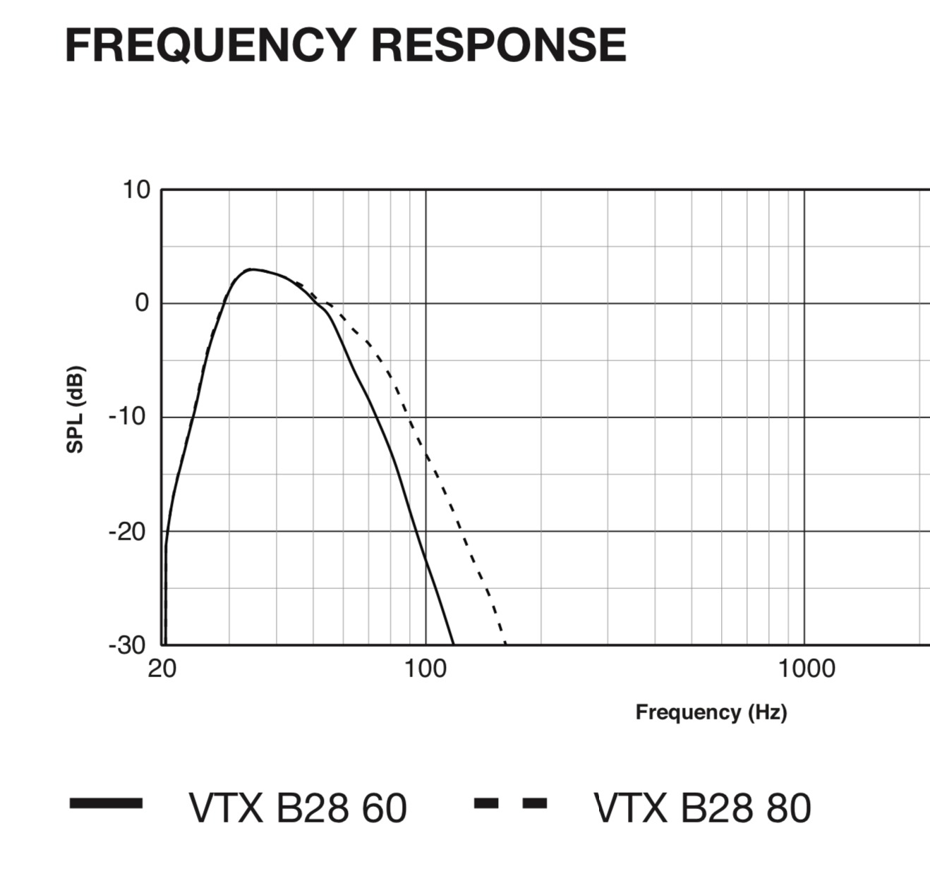

And this is what’s relevant, from an engineering and acoustic perspective, when I’m designing (I’m no industrial designer)
for instance, all those arrayable subwoofers- designed for concerts, nightclubs or theatres?I’m talking about 2-man lift type that used in pairs to half dozen. They “only” go to 30Hz.
eg. JBL VTX B28:

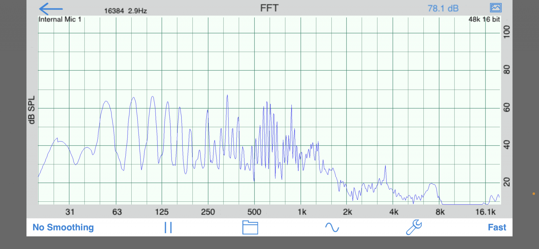

even the lowest note on the piano contains very little 27.5Hz content:
FFT of lowest note on my Yamaha U3 (2021 model):
so chasing 20Hz may be fun; but once you’ve experienced it, you realised it basically a cone flapping in the wind. So you stop chasing 20Hz, or 16Hz or 12Hz like some of true bass audionutters amongst us.
