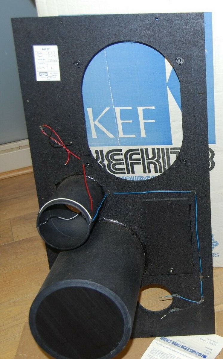

You'll need to close the back of the midrange tube if it doesn't touch the back wall. Or extend the tube. Regardless, it needs to be sealed up so the woofer doesn't push it around.
EDIT: Looked at the photo more closely... it's already sealed. 🙂 🙂 🙂
The large tube is the mid enclosure, the smaller one is the portThank you for the great suggestions. There are no separate enclosures, they are the tubes for the mids and tweeters. Please see photo.
And shows how to add a wooden block to the rear of the midrange tube in order that it can be supported by the back of a deeper cabinet.As a matter of fact KEF recommends to screw the back of the tube to the back panel.

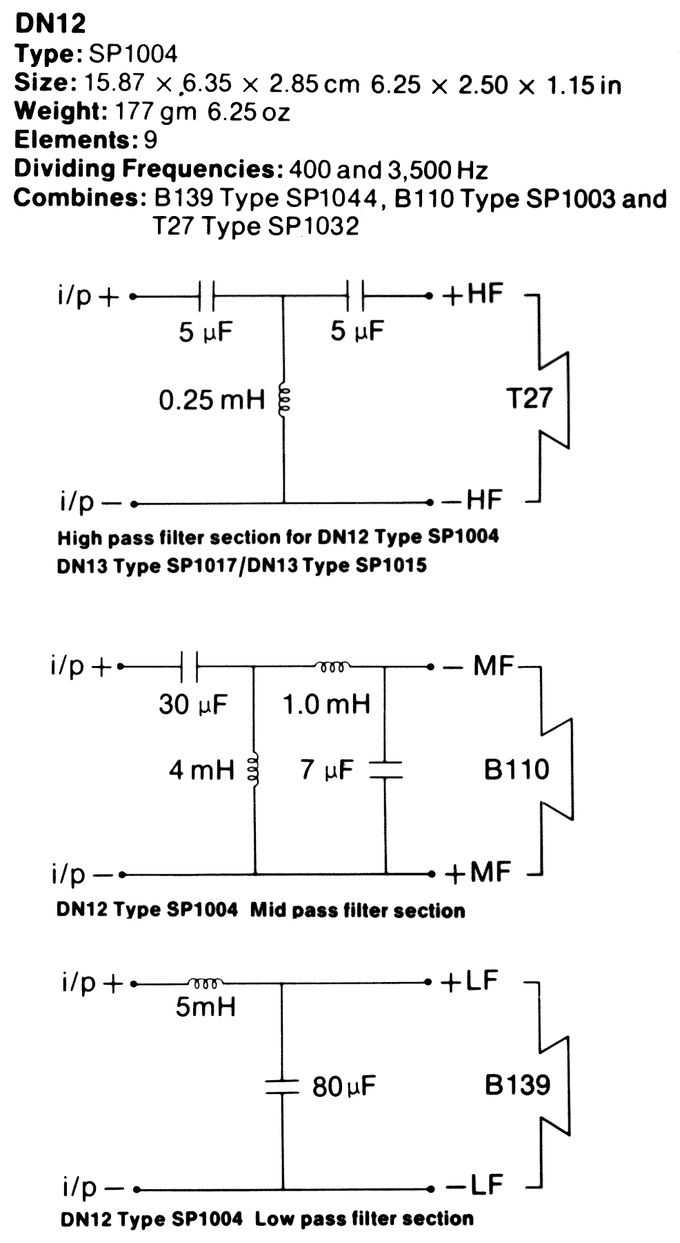

The XO is the weakest part of this kit. The simplest, and likely best recommended box is the sealed one. I would abandon the included baffle and look to build a modern TL and at least bi-amp.
dave
dave
Here the DN12 XO used in the KETKit 3:
If you were to bi-amp you could use the later AB XO on the tweeter and biamp the B139/B110 below 250 Hz (making the nasty 1kHz resonance less of an issue):
Me, i’d biamp and substitute something like the Alpair 5.2eN for the b110/T27.
