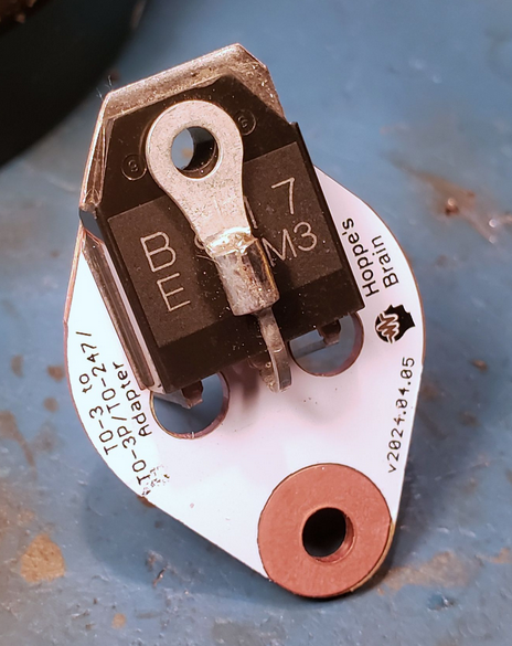

I could use much faster outputs if I could find a way to fit TO-3P parts.
These adapters exist, but they wouldn't fit as the positions for the TO-3 transistors are recessed. I'd have to have some risers machined.
https://hoppesbrain.com/product/to3-to-to3p-adapters/
You should ask restorer John over at ASR about this: https://www.audiosciencereview.com/forum/index.php?members/restorer-john.1308/
It's possible to belt-sand off the over-hanging parts of the TO-3P so it fits the profile.I could use much faster outputs if I could find a way to fit TO-3P parts.
Will that decrease the device power handling at all?
I thought of that but wasn't sure I could do it without taking too much material off.
If I can make that work I can use 30Mhz parts instead of 4Mhz parts. Not quite the 70 of the originals but a lot closer...

In the video I posted in #13, it shows how to use TO3 transistors in the L07M II...........I could use much faster outputs if I could find a way to fit TO-3P parts.
@claudio Nice! I should have looked more closely at that.
I see you used the MLCCs in place of the "black flag" capacitors. How are those for temp stability etc compared to the silver mica parts EchoWars recommended in the thread I linked in post #24.
I'll have to look again to see if there are new TO-3P that are 70Mhz. The 2SC5200/compliment I often use are 30Mhz. But I might have enough TO-3P Sanken pulls around here from AVR units to make a full matched set.

No problem shaving them off a bit. It's still more mass of copper heat-spreader than a regular TO-3 has, and the copper of the transistor's heat-spreader sandwiched with the adapter is 3.2mm thick; it should actually move heat slightly better than a TO-3.Will that decrease the device power handling at all?
I see you are the vendor. It is cool that you made these.
The issue with simply bolting TO-3P's to a TO-3 heatsink, is that the copper contact patch of a TO-3P heat-spreader is only 1/3 the size of a TO-3. Copper conducts heat twice as fast as aluminum, so the more the heat is spread out in copper before it gets to the heatsink, the faster that heat is transferred to the aluminum.
