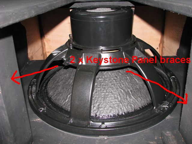

Hey Art,

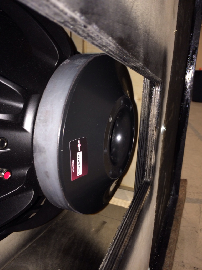

I've finally got around to making some sawdust on this build, I have a quick question about the baffle cutout. The plans posted by tb46 indicate an opening with a 16" diameter, the diameter of the gasket on my 18TBW100 is closer to 16.75" and I worry about the surround slapping at high input levels. I reckon that a opening of 16.5" would allow the driver to move without hitting the baffle, but will still allow the gasket to seal, do you happen to recall what your experience was?
-Thanks
-Thanks
The plans have a misprint, the B&C spec sheet indicates 16.6 inches, (422 mm) as the baffle cut out diameter for their 18" speakers.
Fired up my 18TBW100 loaded Keystone, mo measurements but referenced against a SRX728 I was quite impressed. Now for the fun part: truing/rounding corners, sanding, painting. Fun.
I know it came up but not sure if anyone answered, lots of clearance between the magnet and baffle.

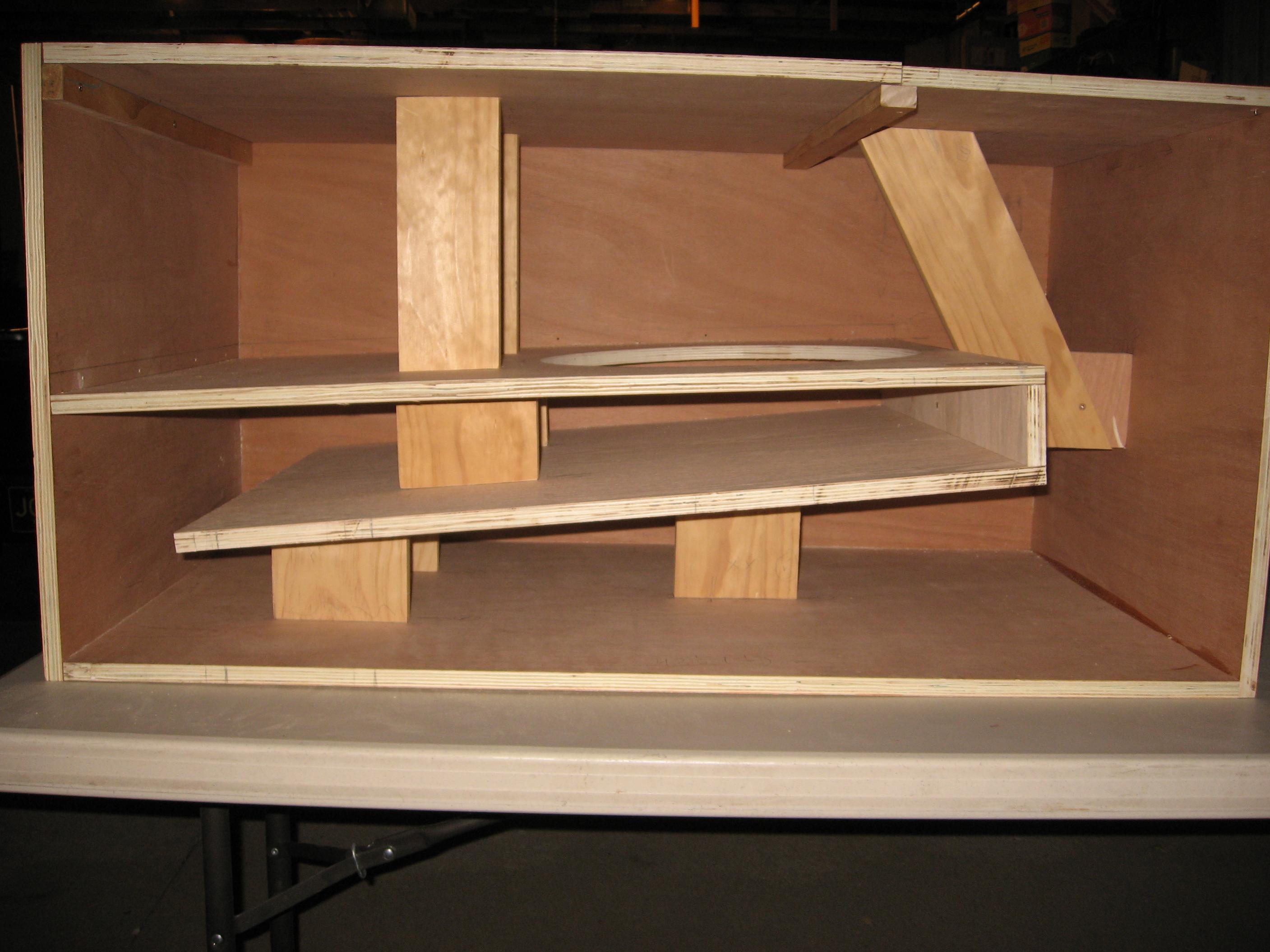

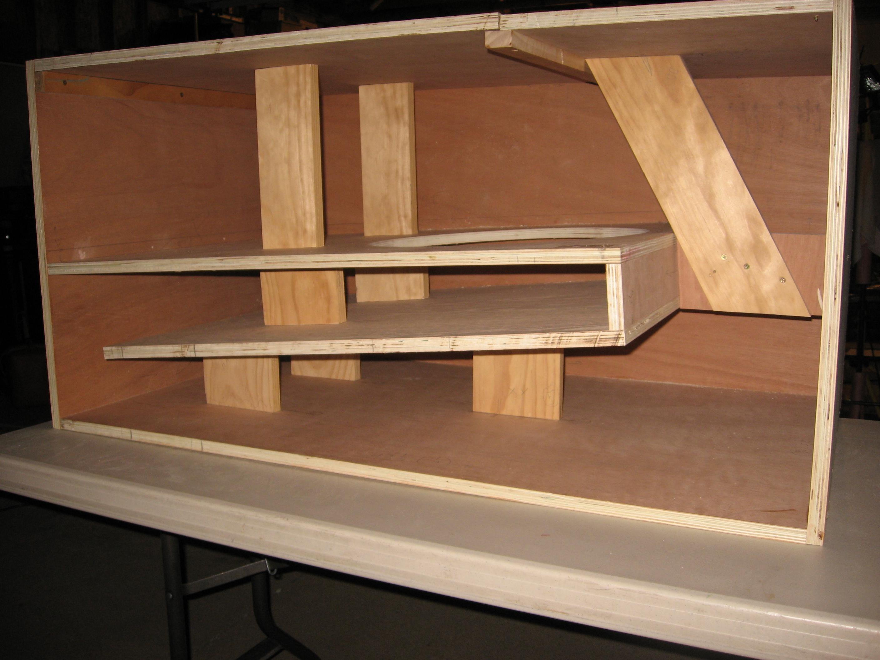

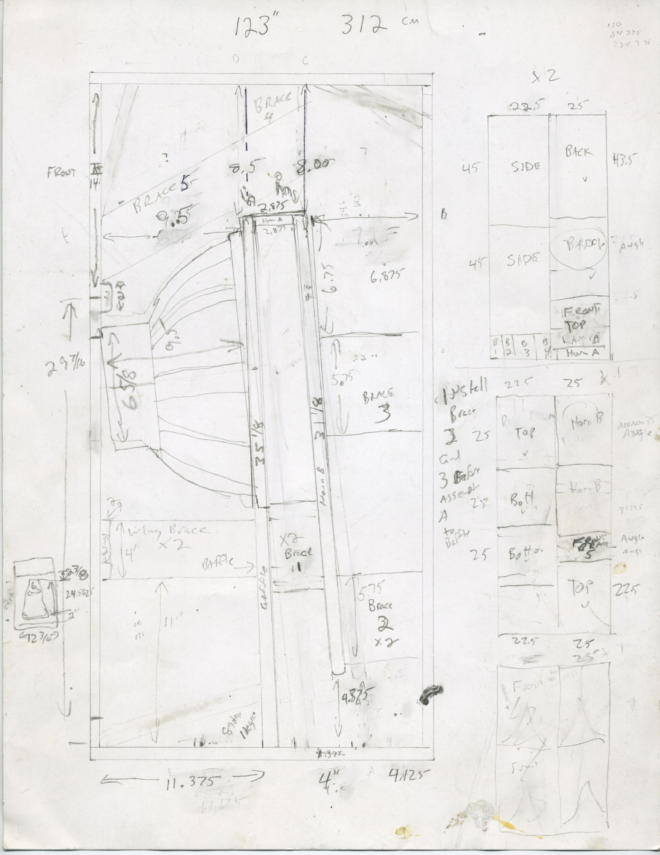

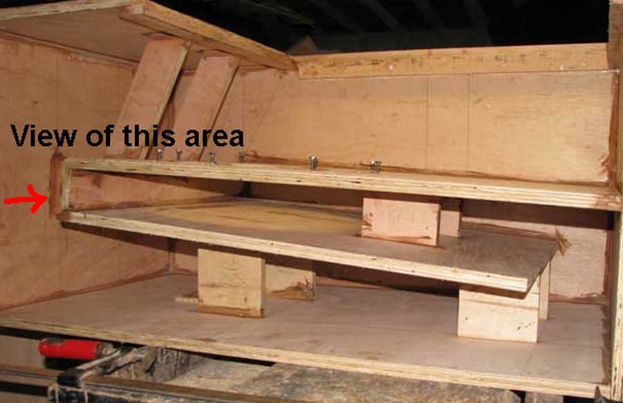

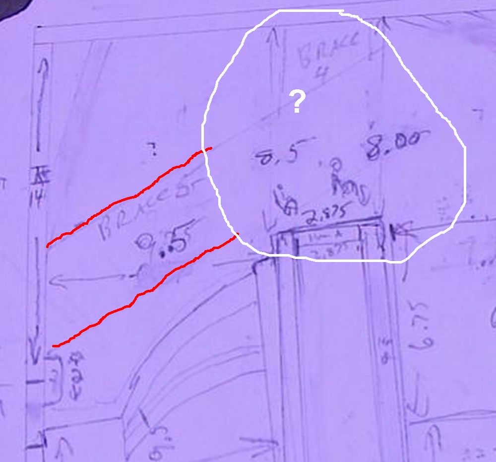

Keystone bracing
Art,
Can you clarify the bracing you installed near the Keystone exit panel. I’m unsure of what the layout is with the angled brace/s from your original build sketches.
Our build photo shows the other side compared to PASC’s photo.
Build is well underway :> cheers
Art,
Mars,Art,
It appears PASC doubled up on braces #3 and #5. The original plan has a single brace # 5 (which you outlined in red) attached to the vertical brace #4 and the top front piece.
Only the braces that say "X 2" (times 2) were doubled in the original plan.
In the photo below you can see brace #4 centered between the 2 x 12" speakers, brace #5 offset to the right connecting to the front panel just above the Keystone exit.

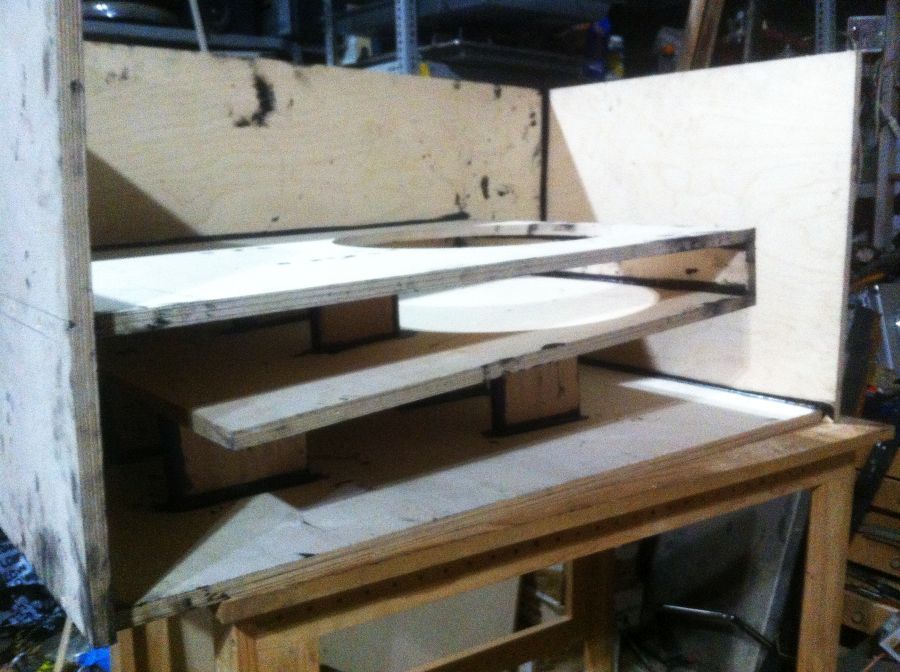

My First Keystone Build
Getting closer to test of my first build. This is what I have so far. All my internal dimensions are within 1/8" to 3/16". The braces sure took me longer to fiddel in than I would have guessed....🙄
I am going to try it out with a Peavey Low Rider 18 that I have on hand and see how it does.
Braces are a pain, but make a big difference.Getting closer to test of my first build. The braces sure took me longer to fiddel in than I would have guessed....🙄
Looking forward to you and Spenser's test results!
