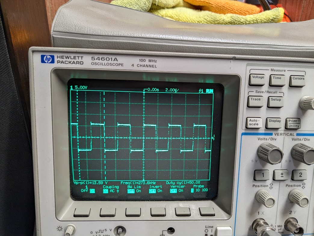

Lift D26 & D27 (1N4148) and check for Rail to Rail output on Pin 13 IC4 and note any Vdc differences on IC4 Pins 1 & 2 and around IC5.
Bumping this thread...

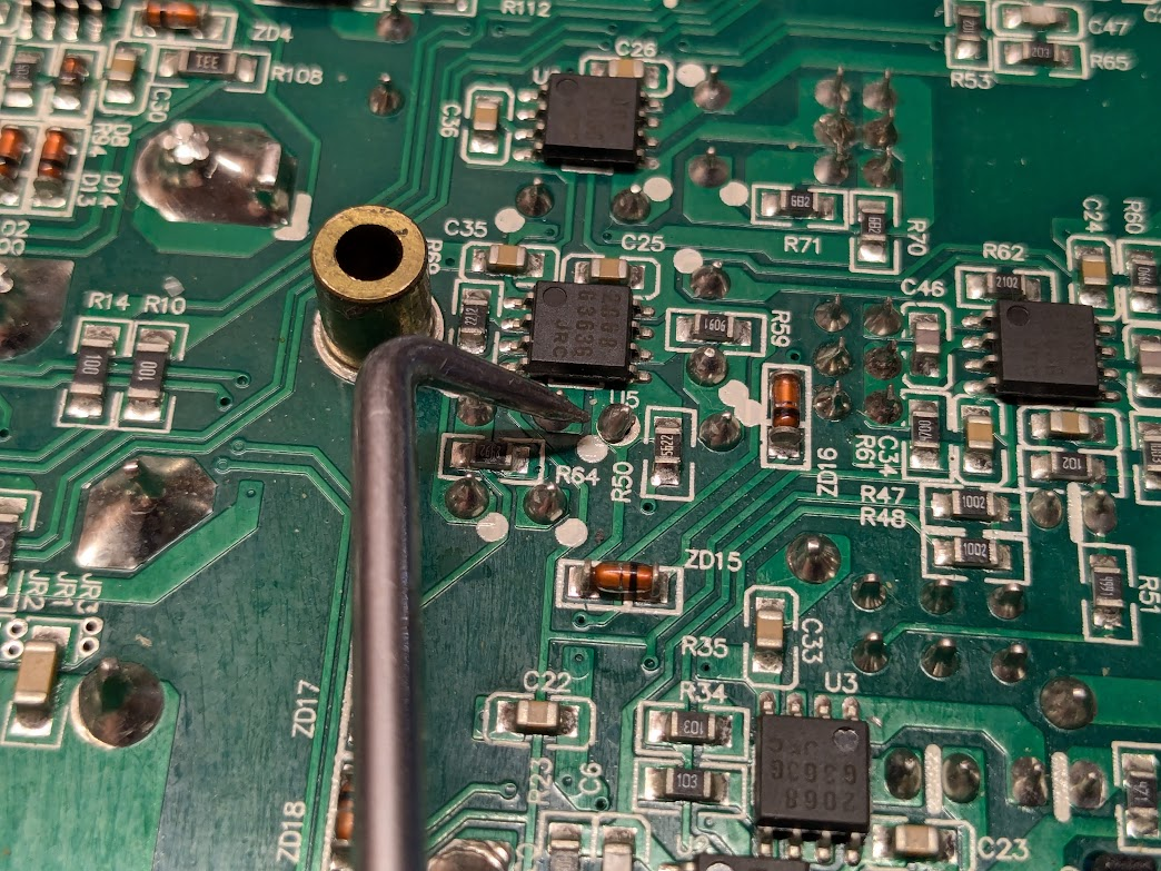

So, I removed those two diodes. The amplifier will start and idle, I attached a scope shot below of what I am reading on Pin 13 with the scope probe in X10 mode, so its 50V per division. However, it will not start with the speaker attached, it just pops/cycles. So, I measured the speaker output while starting, and theres a few volts DC offset there during first-start and then it goes away.
Pins 1 and 2 are both at 10.3V
If I were to fathom a guess, the condition thats causing the amplifier not to start with the speaker attached with loud popping, is probably the same condition thats triggering the protection circuit.
Once the amp starts an idles, I can connect the speaker but there is no audio.
That fixed the audio problem. The amplifier is now producing proper audio. I did have to ground the RCA ground to the main ground, otherwise I get RCA buzz...
Still does not fix the startup problem with the speaker attached (10A current limited PSU) and the protection problem.
