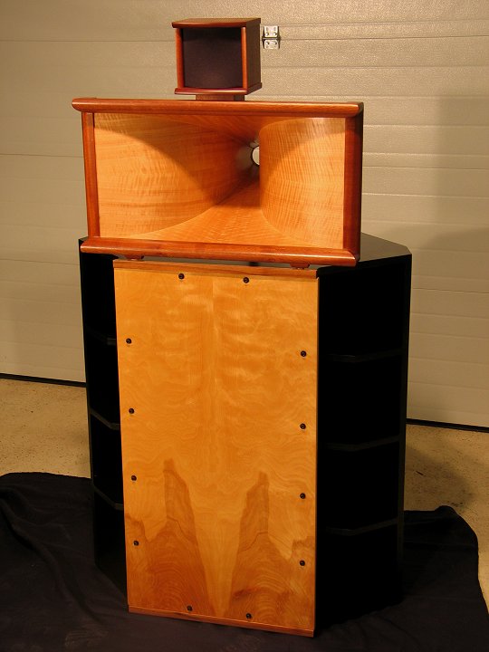

Check also Greg Roberts from Volti Audio....he's developed a variation on the Jubilee called Jamboree. As a builder of horns, I think the Jubilee would be at my pic for a large room/big output bass unit. Andrew
Volti Audio - NL11 - New Horn Speakers - Klipsch Upgrades
...Greg Roberts from Volti Audio...he's developed a variation on the Jubilee called Jamboree.
Actually, to give proper credit where it's due I believe that the Jamboree is a Dana Moore design. Greg R built a pair a long time ago and didn't apparently like them. The Jamborees have the same basic folded horn design as the other "W" section folded bass bins.

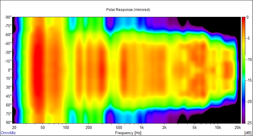

The K-402 doesn't have a "cutoff". The present K-402s are limited only by their 2" compression drivers, most of which don't sound very good below 400-450 Hz.
...Would be using multiple subwoofers below the midbass (I suppose upper midbass is more accurate) horn. There is one design I've seen where there is excellent directivity match with the K-402 around 500 Hz.
The K-402 has clean polars down to below 100 Hz:
