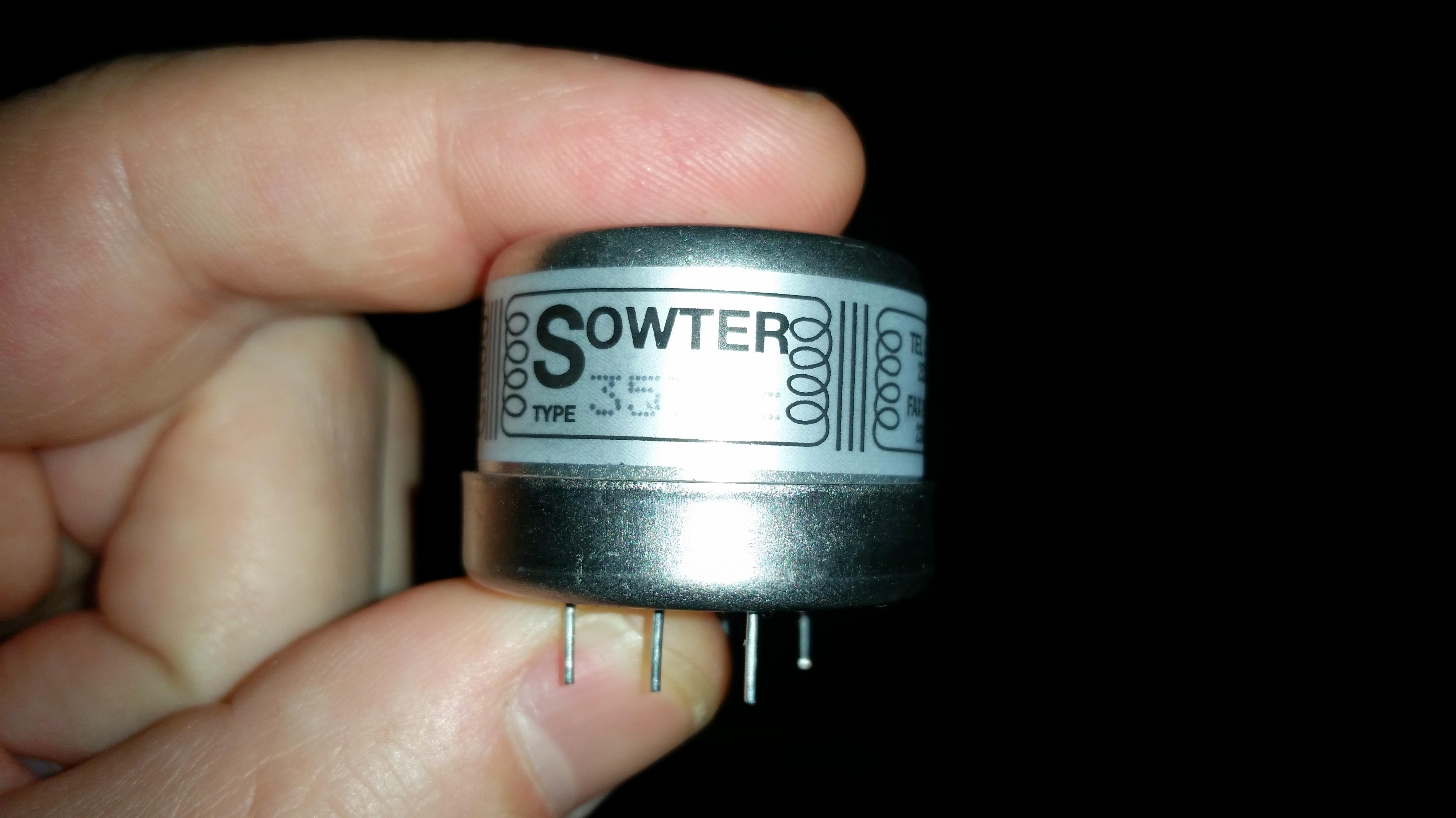

OK, folks. We're in the home stretch here, but still some problems to solve.
First, I added a 580pF cap across the input transformer secondary to kill some ringing from the input transformer. I found that value by using a capacitor substitution box and a 100K pot and twisting / selecting until the front-edge of the square wave flattened out. It was flattest when I dropped the resistance to zero, so I left the resistor out entirely.
Maybe it's a mistake to exclude the resistor?
Whatever happened, it resolved a lot of the high-frequency hash I was experiencing, but I'm still hearing some sibilance and harshness in the higher frequencies. For example, I'm listening to 'Birdland' (Patti Smith - Horses) as a test (not only is it one of my favorites by her, but she sprays 'S's around all over the place so it's a great sibilance test) and sometimes her S's tweet and leap out of the speaker.
Once you start hearing sibilance you can't stop, so it's possible that I'm mentally over-emphasizing their presence but I feel like the high-end is harsh. That could also be the result of single-ended ears tuning in to push-pull highs but I don't think so. Maybe there's still some oscillation to attend to?

The resistance of the winding may be about right.It was flattest when I dropped the resistance to zero, so I left the resistor out entirely.
Thanks for responding. I get it. So the secondary of the transformer may be providing enough resistance.

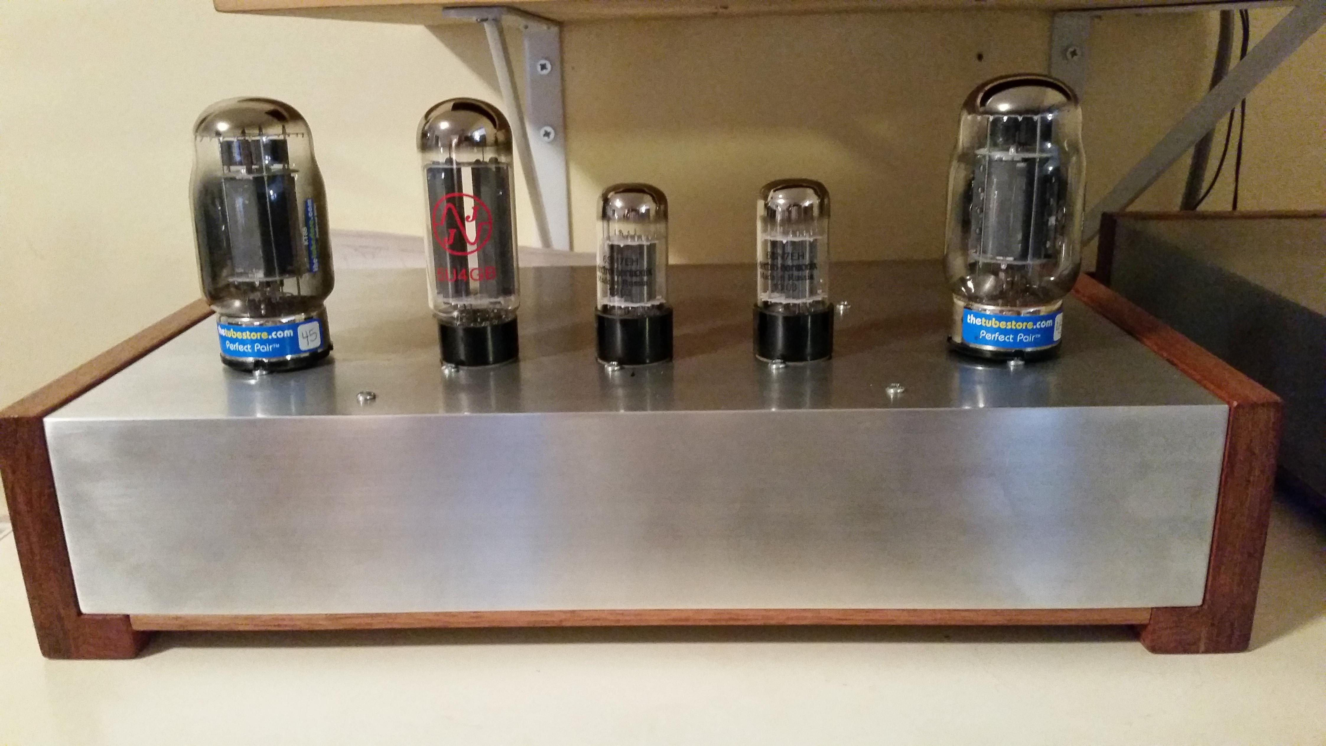

OK-- so I changed out every variable today. I first listened to records that I found to have excessive sibilance on my single-ended 300B amp and noted that the sibilance was almost gone. I changed speakers, turntables, room positions and everything else I can think of and I'm still experiencing the effect with the Uniamps.
It could still be the speakers, of course, but I'm starting to think a filter would help. It could also be oscillation, but I need to figure out where it's coming from.
I've read through a number of posts and it seems like I could apply some resistance across the speaker terminal or perhaps come up with a zobel to attenuate the offending frequencies.
For the record, the highs sometime spit and other time whistle at me, so there's a lot of energy at what I'm assuming is the 5K to 8K frequency band.
Any DIYers have experience with a filter or another solution that might help?
