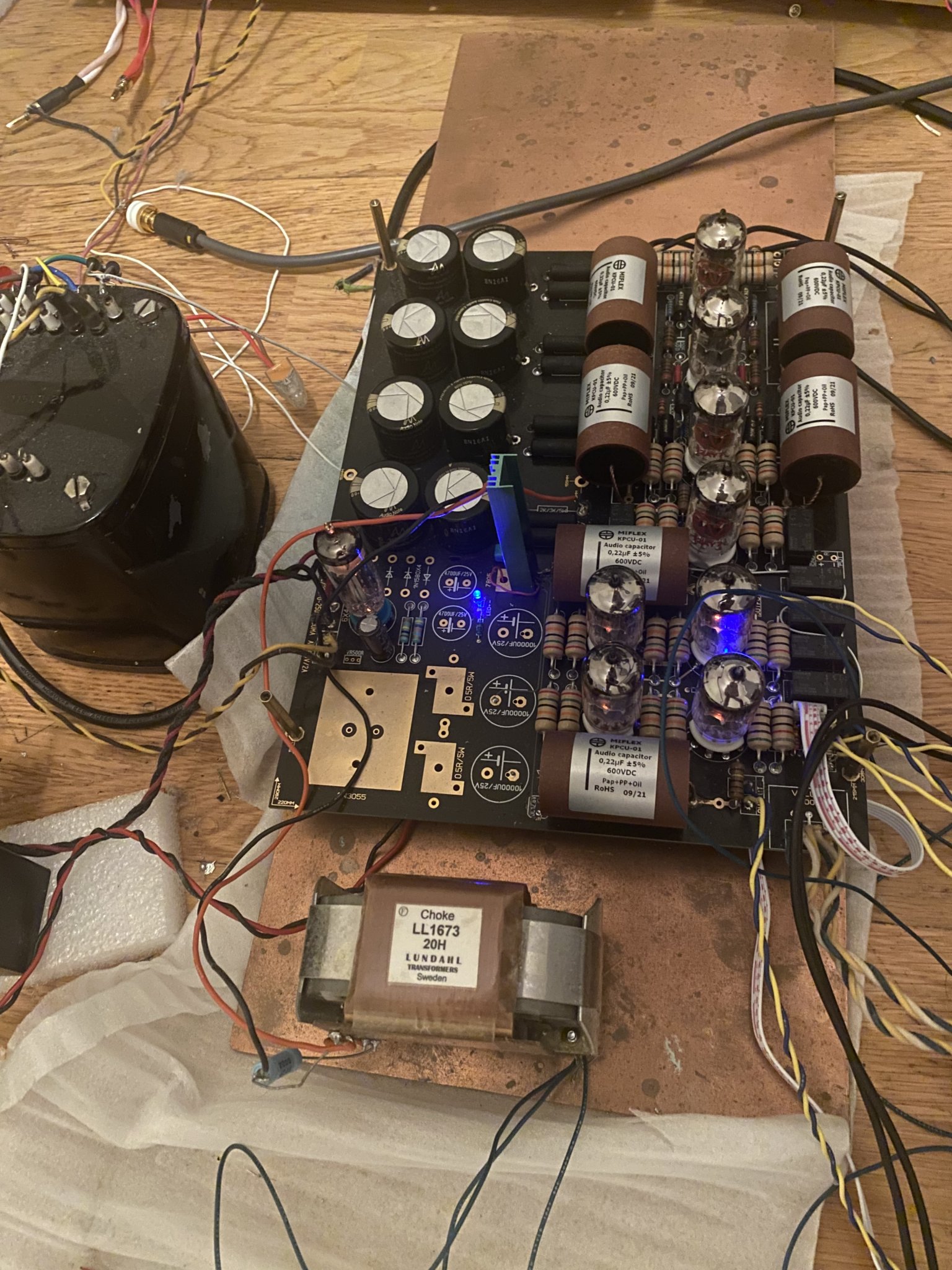

What current is flowing through the linestage parallel 12ay7 tubes ? I just wonder if 2W (2 x 1W parallel) are needed or 1W will be enough.

In the original, it is 1mA in both tubes (0.5mA per tube), so the resistor sees around 140mW. Reducing the resistor to 28k as I have done in my linestage increases the total current to 4mA and power dissipation is 820mW, no problem for two 2W resistors in my case.What current is flowing through the linestage parallel 12ay7 tubes ? I just wonder if 2W (2 x 1W parallel) are needed or 1W will be enough.
Thank you ! I thought there is some mistake in the translation and the current can't be that small.

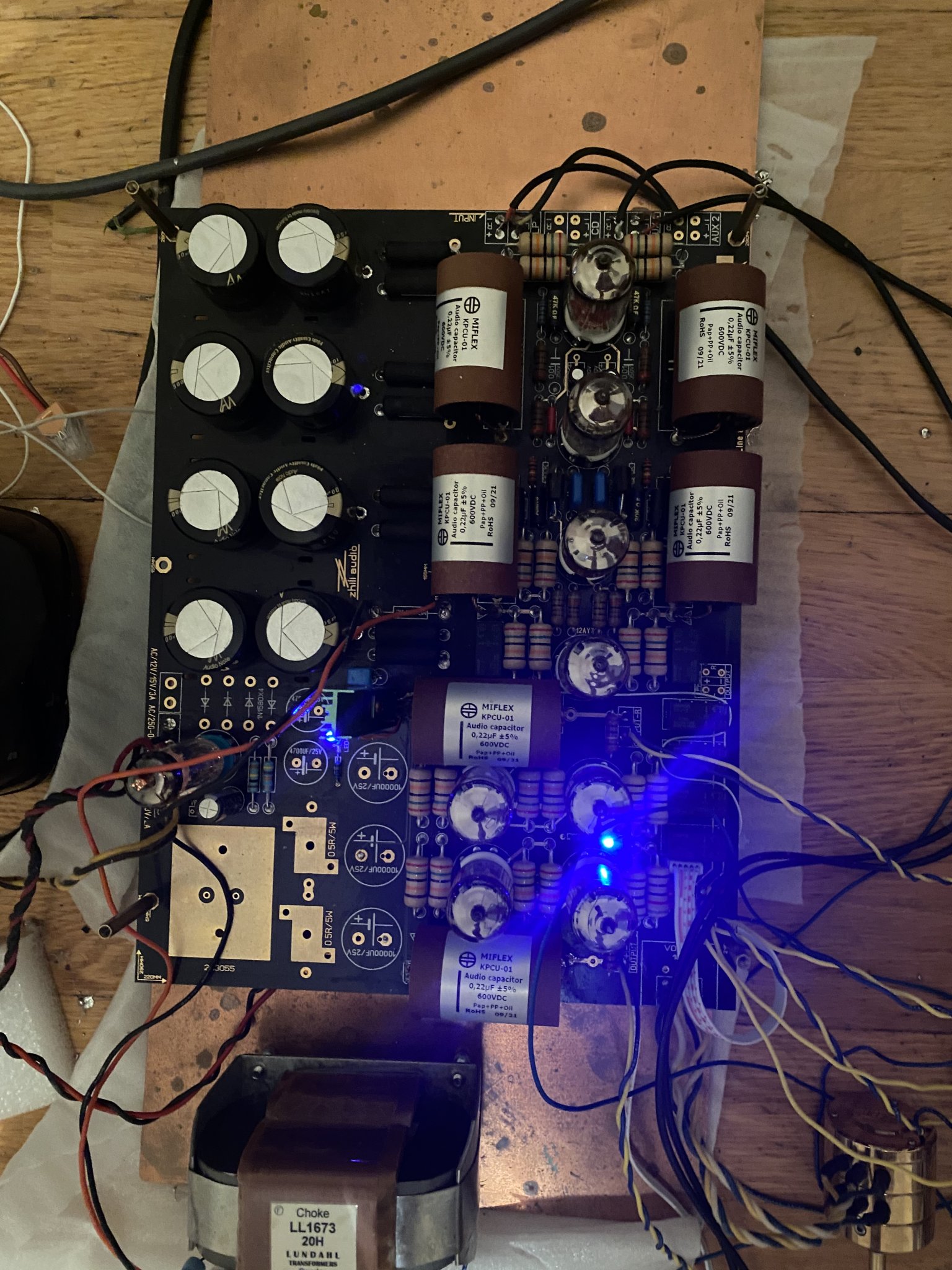

Can you help me with cap is good for M77 ? I use 6X 0,22uf MIFLEX for my preamp !Some folks like the sound of the original M77 as "organic" and "soft", others think it lacks punch and is too laid-back. Whatever floats your boat 😀

You may want to increase the output cap of the line stage to 1uF (depends on your power amplifier....), and using good caps definitely helps. I used Jansen Silver Caps. Checked out MIFLEX and the website did not tell much about them, what kind of capacitors are they?
HiYou may want to increase the output cap of the line stage to 1uF (depends on your power amplifier....), and using good caps definitely helps. I used Jansen Silver Caps. Checked out MIFLEX and the website did not tell much about them, what kind of capacitors are they?
I use MIFLEX Copper Foil Paper / Polypropylene in Oil Cap ! My amp is Jadis JA30 monoblok with KT-88 +lundahl output transformer ! I have have normal bass now ! All tube on my Kondo is 12AY7 JJ matchat. With tube recomed you ?

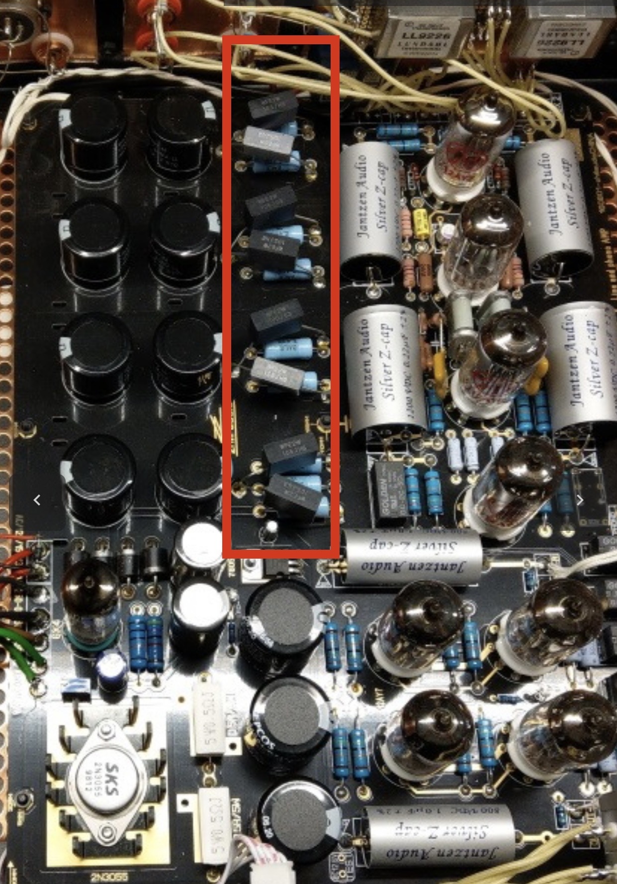

I have questions about power supply ! Use you 0.1uf on power supply ? I have 0.1uf how i must use they on my M77 ? Must i use one 0.1uf cap for each 100uf cap ? See photo please
In my build, I added 0.1uF in parallel to the electrolytic caps, and I think it was helpful but I did not check the sound before / after. So , frankly speaking , I cannot tell you if that makes a huge difference. Probably good when your power grid is noisy.

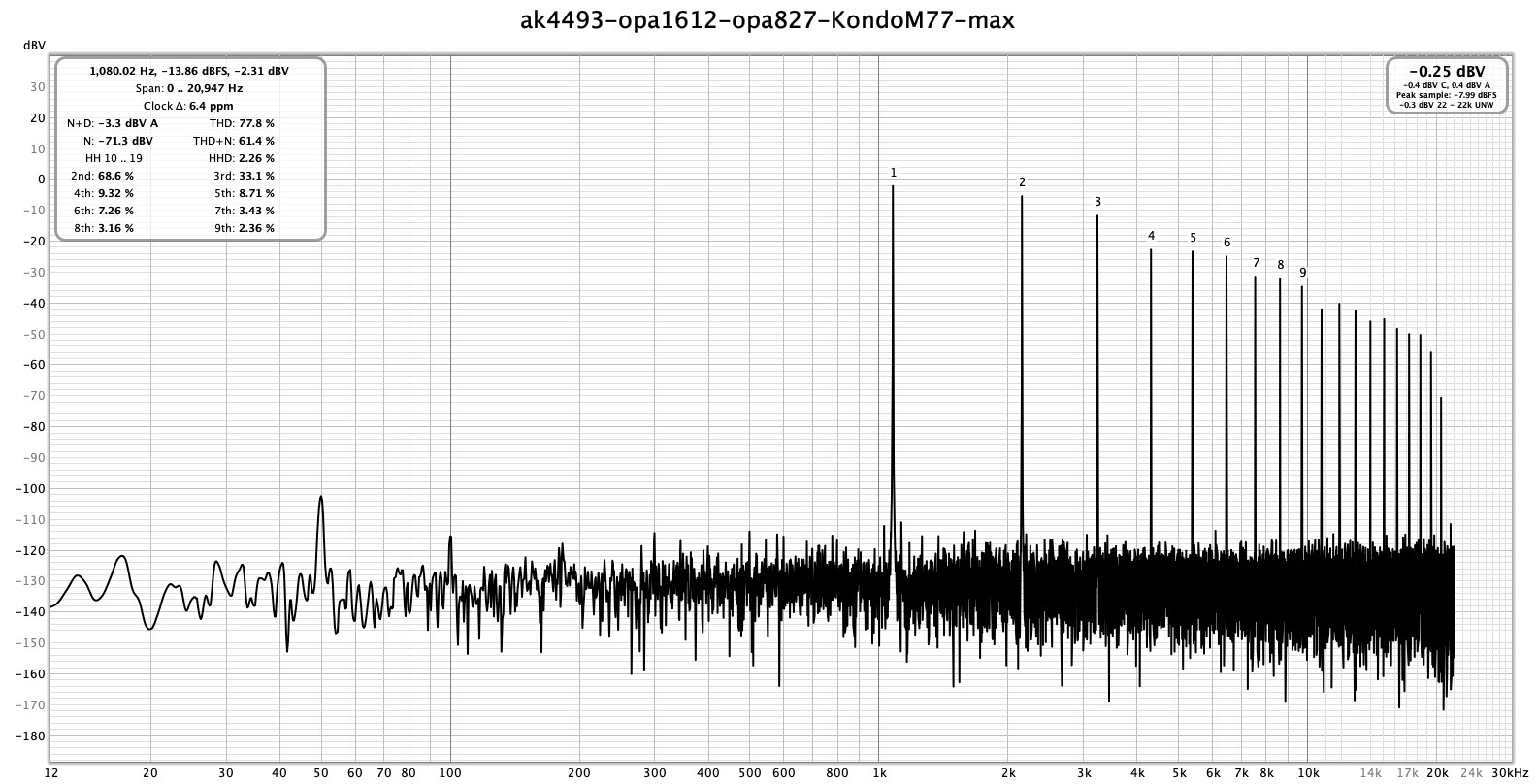

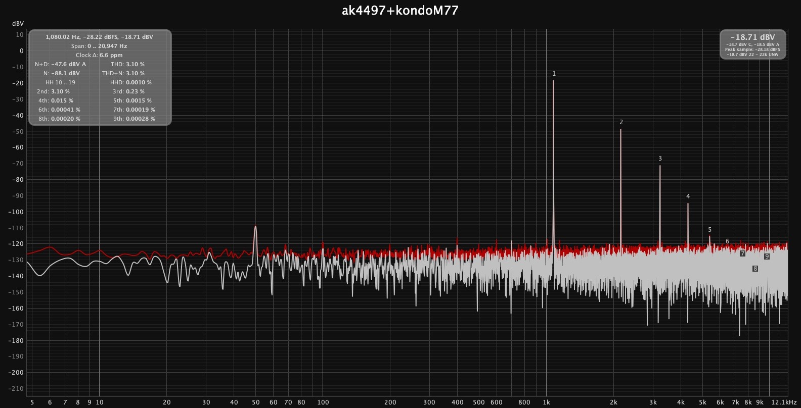

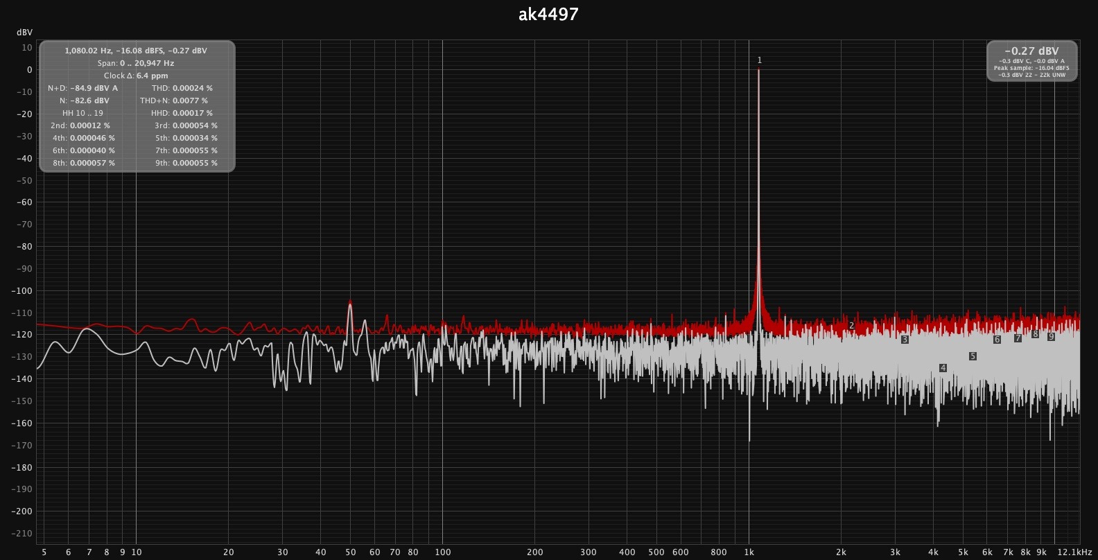

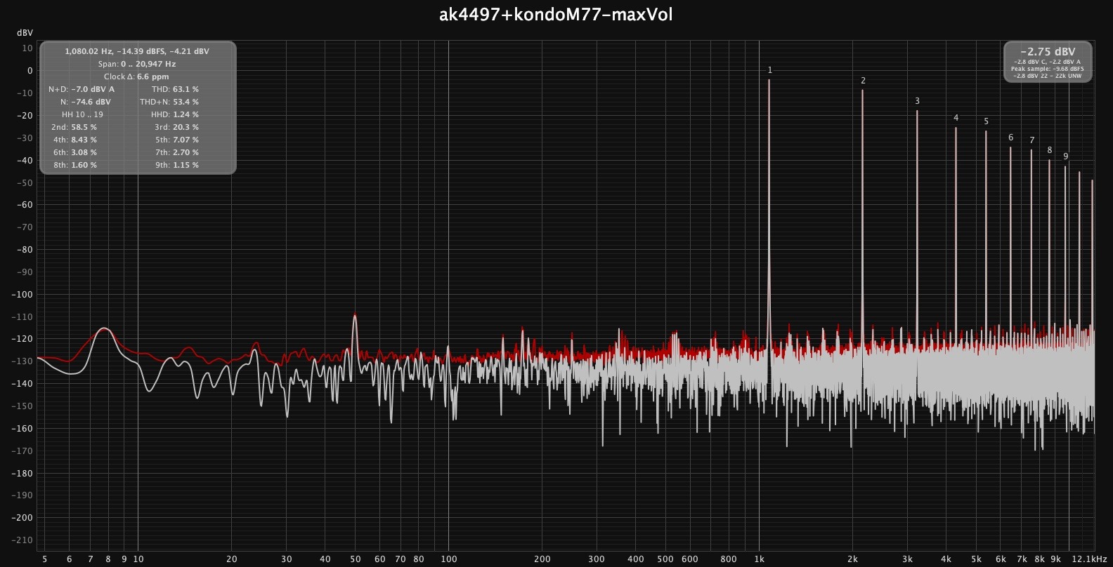

No. On a lower level the distortion is lower.At what level did you measure? Same picture at lower volume?
Dac output on max level is above 2V
thanks.Looks good, these are the harmonics the tube lovers crave 😀
