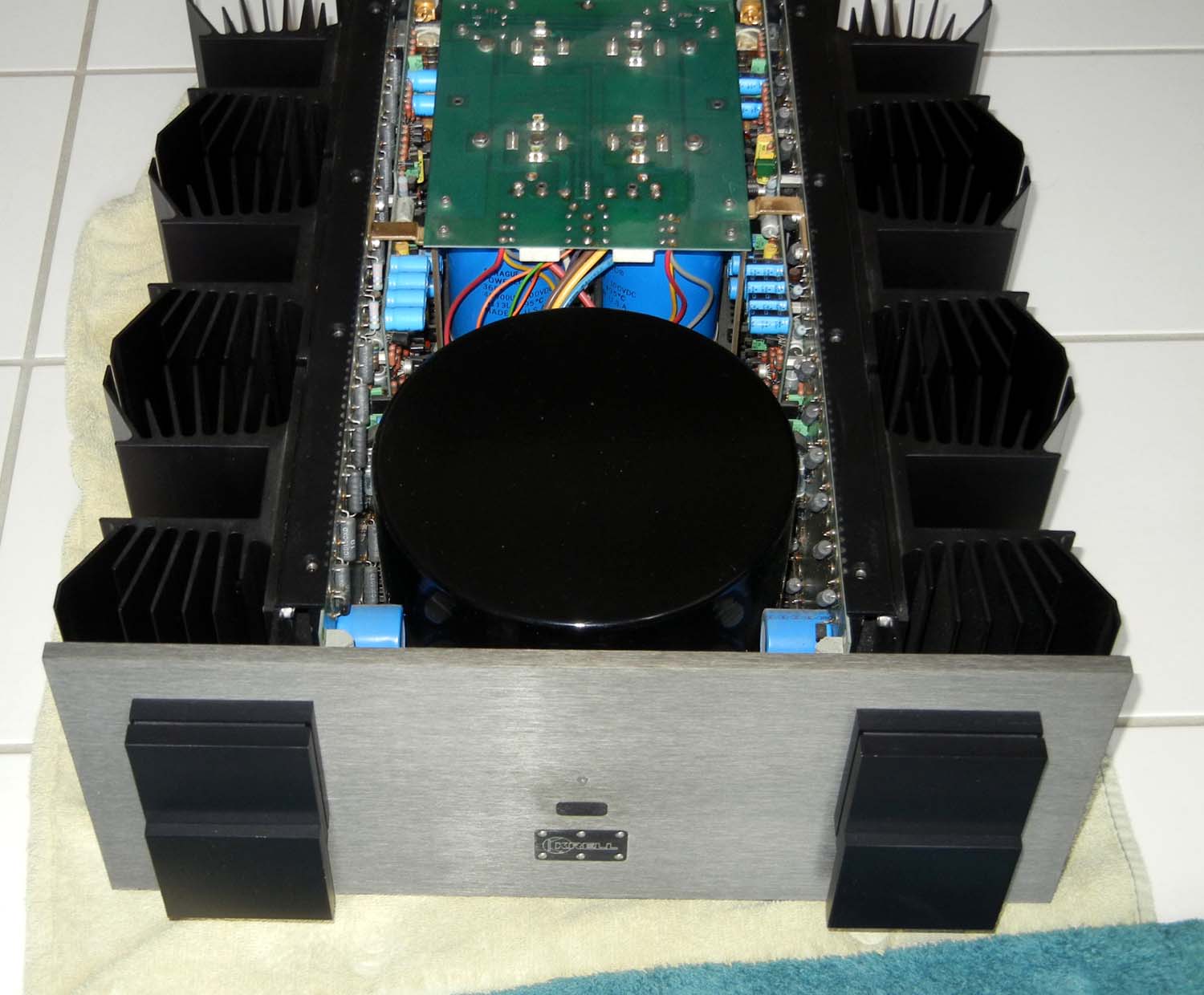

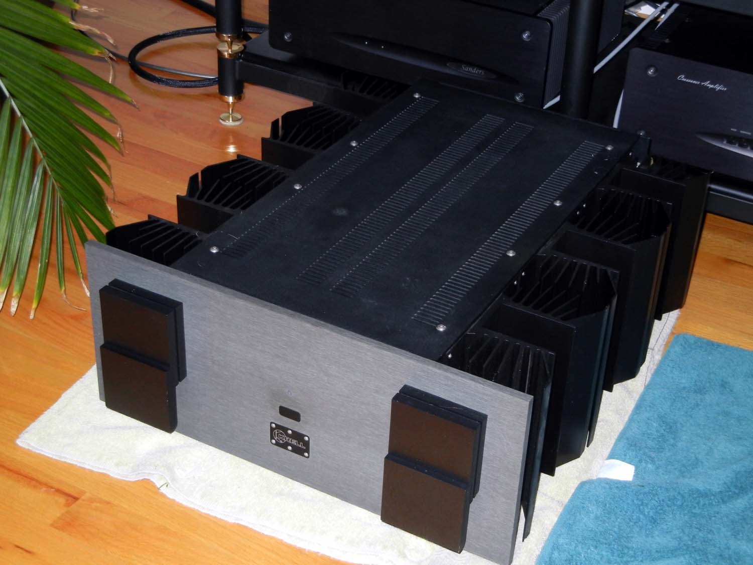

Finally picked up my KSA-250. Looks pretty good on the inside (nothing burnt or toasted) but I'm sure I'll be recapping it in the future.

Hi SCompRacer,
In this forum Heavy Metal just hums at 60Hz 🙂
From the pictures, it looks like you have a very clean and lightly used KSA-250.
I'm sure you have read about the main areas to carefully look over and test.
If you can borrow or purchase a capacitor tester you will get better data than with just a resistor and multimeter setup.
Big Electrolitic power supply Caps.
Caps and relays on power up PCB.
Heat damage from soft start resistor on power up PCB.
DC offset ... DC servo.
Loose screws on output transistors.
Loose SIGNAL PATH screws between main input PCB and Output Heatsink.
Carpeting that can block bottom air flow.
Cursed Cats.

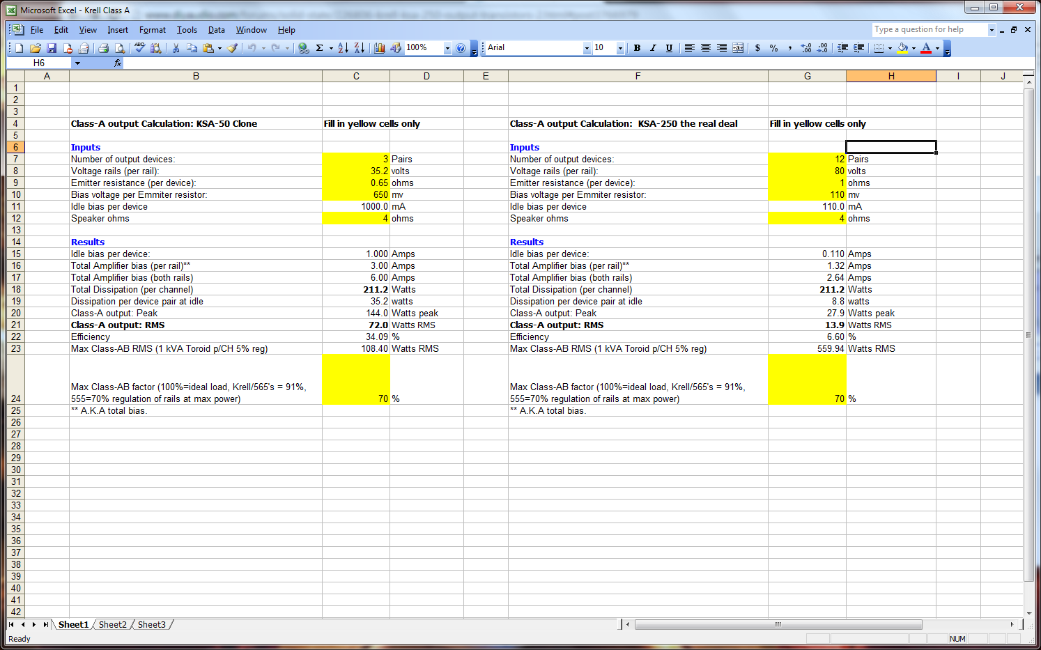

OK, confused. I read this about the ksa-250...
Krell KSA-250 power amplifier When is Class-A Class-A? | Stereophile.com
So I decided to look at my amp a little closer. Popped the hood and took some readings.
KSA-250
Rails - +/- 80VDC
Voltage across emitter resistors - 100mv
Emitter resistors - 1 ohm
12 pairs output devices
Amps from wall - 8.3 amp (actually a lot closer to my Krell KSA-50 Clone than I thought...)
Anyway, had to verify if the article is true, is this not a full class A amp like the KSA-50?
Maybe that's why its a bit dull and not as vibrant as my KSA-50 Clone? I have that bias up the hilt
KSA-50 Clone
3 pairs Toshiba 1943/5200
+/- 35VDC rails,
.648 ohm emitter resistors,
650ma across them giving 1A per output device
Am I actually getting more Class A watts out of my Clone? Is this just a great Class AB amp with monster heatsinks?
