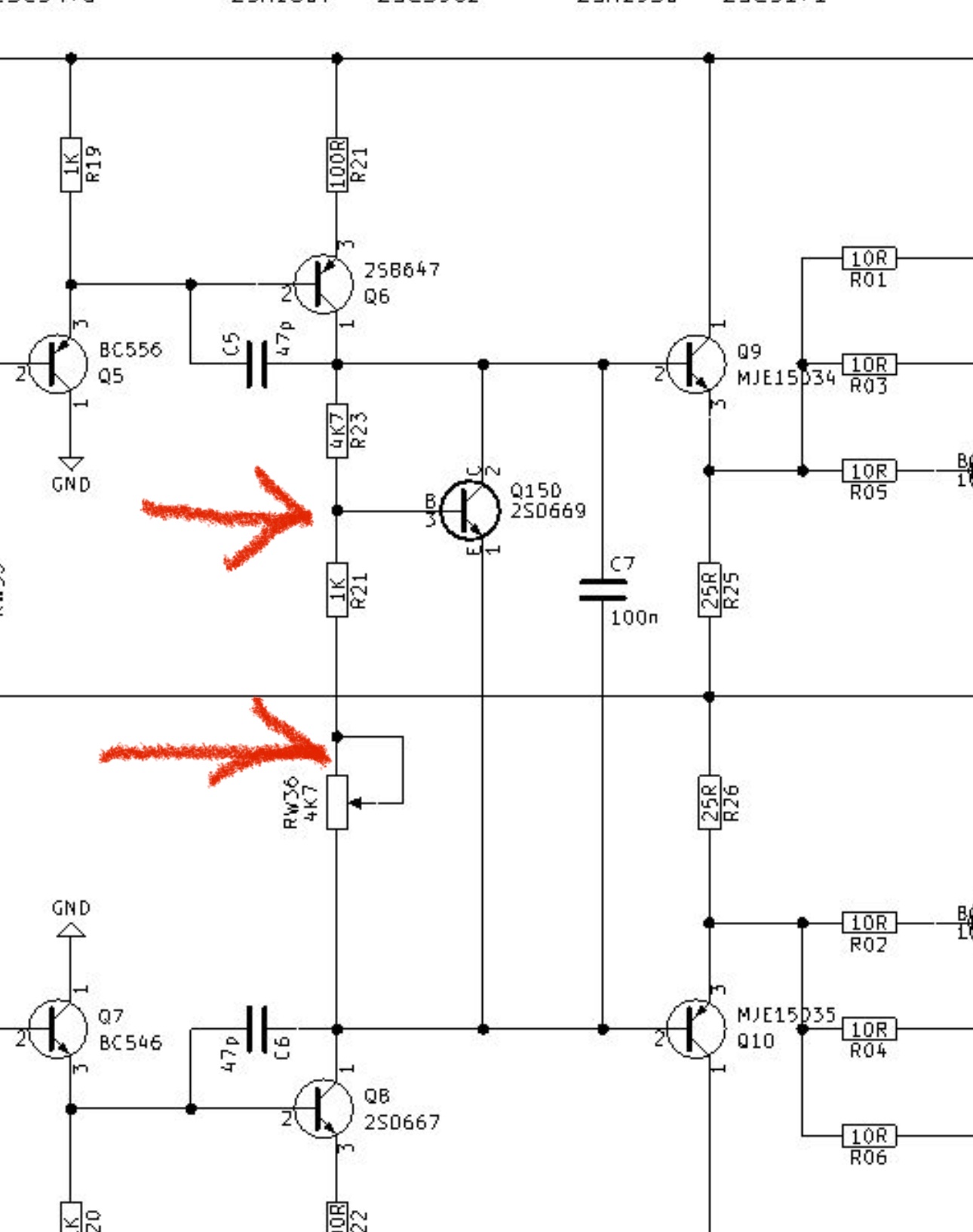

Few more questions, what is the function of VR1 and VR2 ,which one is Bias and which one is DC offset?

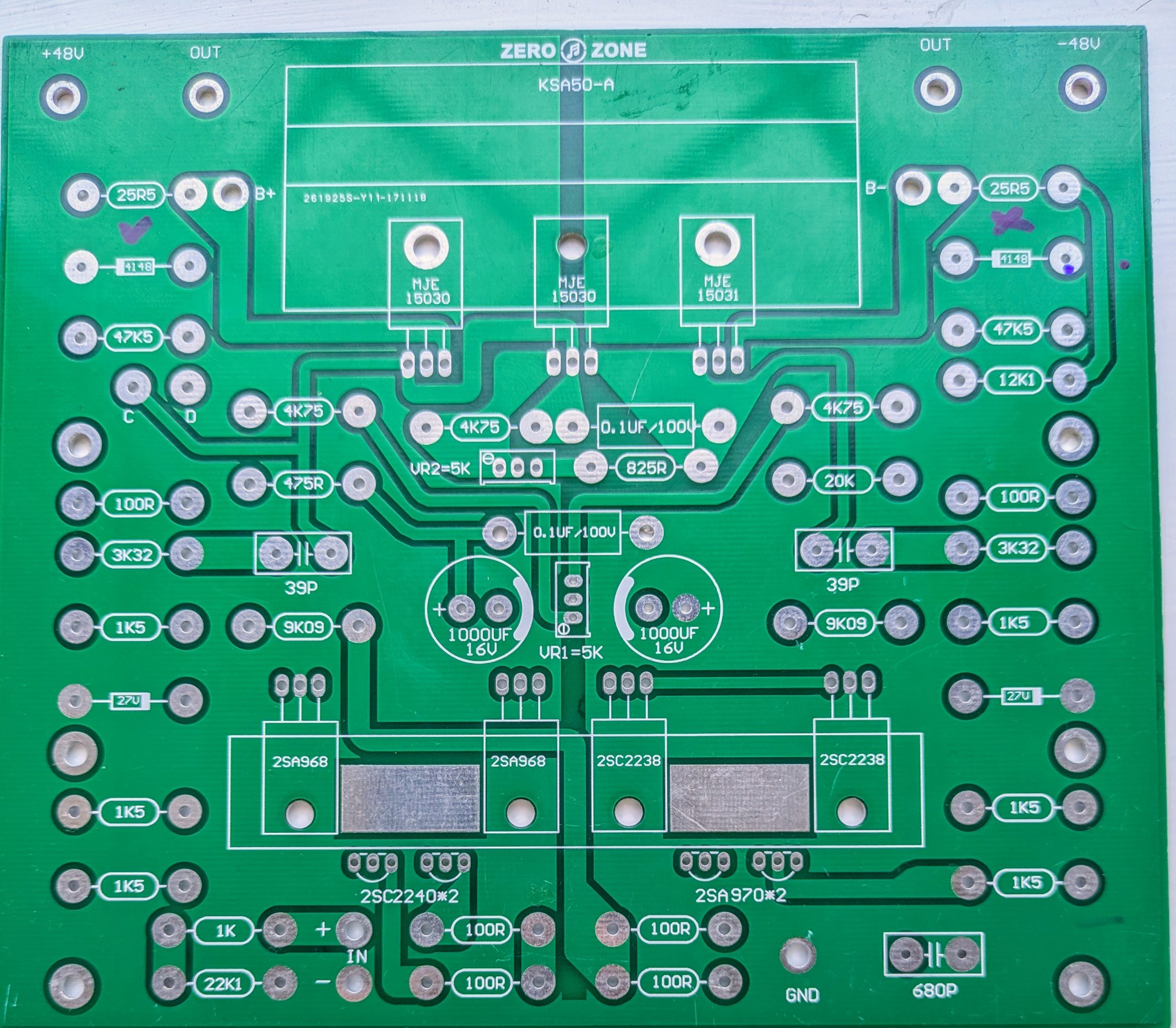

What the points C and D on the driver board?

The bias pot should have 1k ohms from the base of the Bias transistor (Q15) to the common two legs of the pot. The other pot should be dc offset.
Post 9542 above specifies all these bjts and subs.

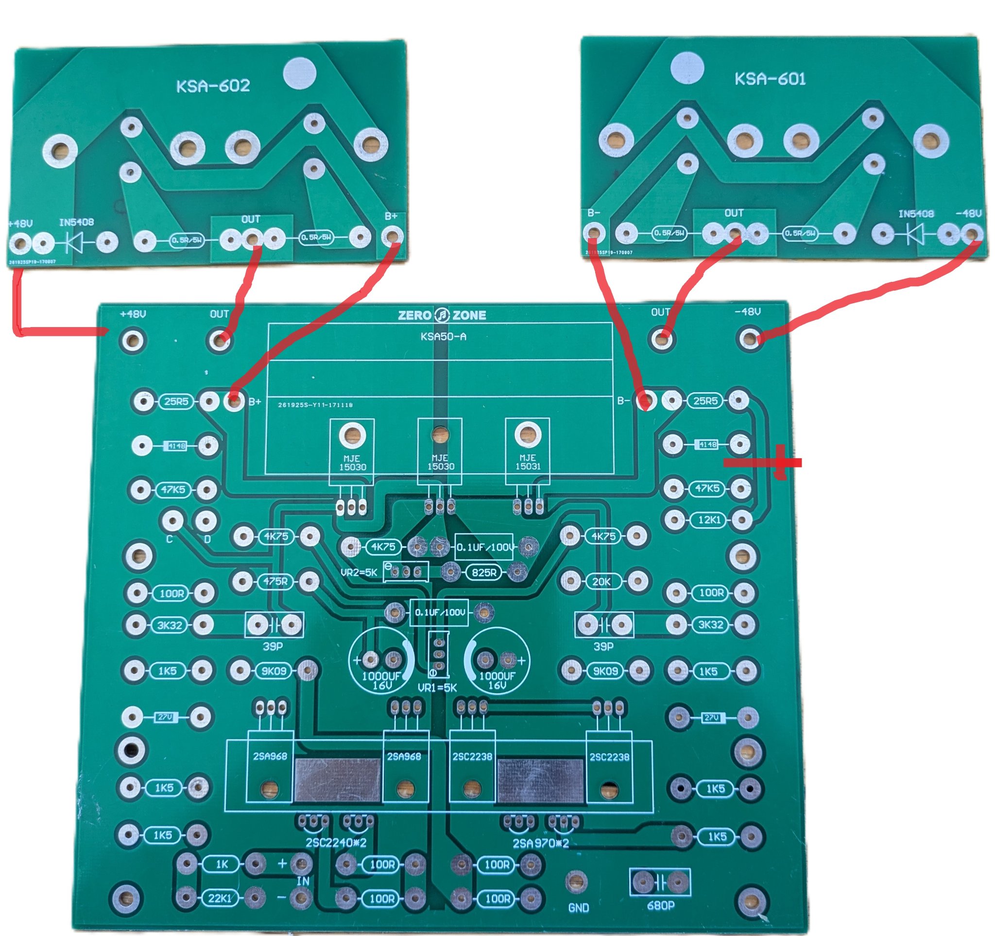

I bought these boards in 2018 but haven't worked on them due to confusion about the connections. Since they were purchased from eBay, there is no support available.
I need help clarifying the following:
Many Thanks in advance for your help
- Are the connections between the boards correct? Should one cable connect the + and - supplies to both the output and driver boards before going to the power supply?
- I read in this thread that my board has an error and that one leg of the 1N4148 diode should be connected to the ground plane. Can someone confirm if my correction shown above is accurate?
- Can 2SC2240 and 2SA970 be replaced with KSA992 and KSC1845?
- I couldn't find substitutes for 2SA968 and 2SC2238. Can anyone suggest alternatives? As a last resort, I might try AliExpress, but I’m unsure if the transistors there are genuine.

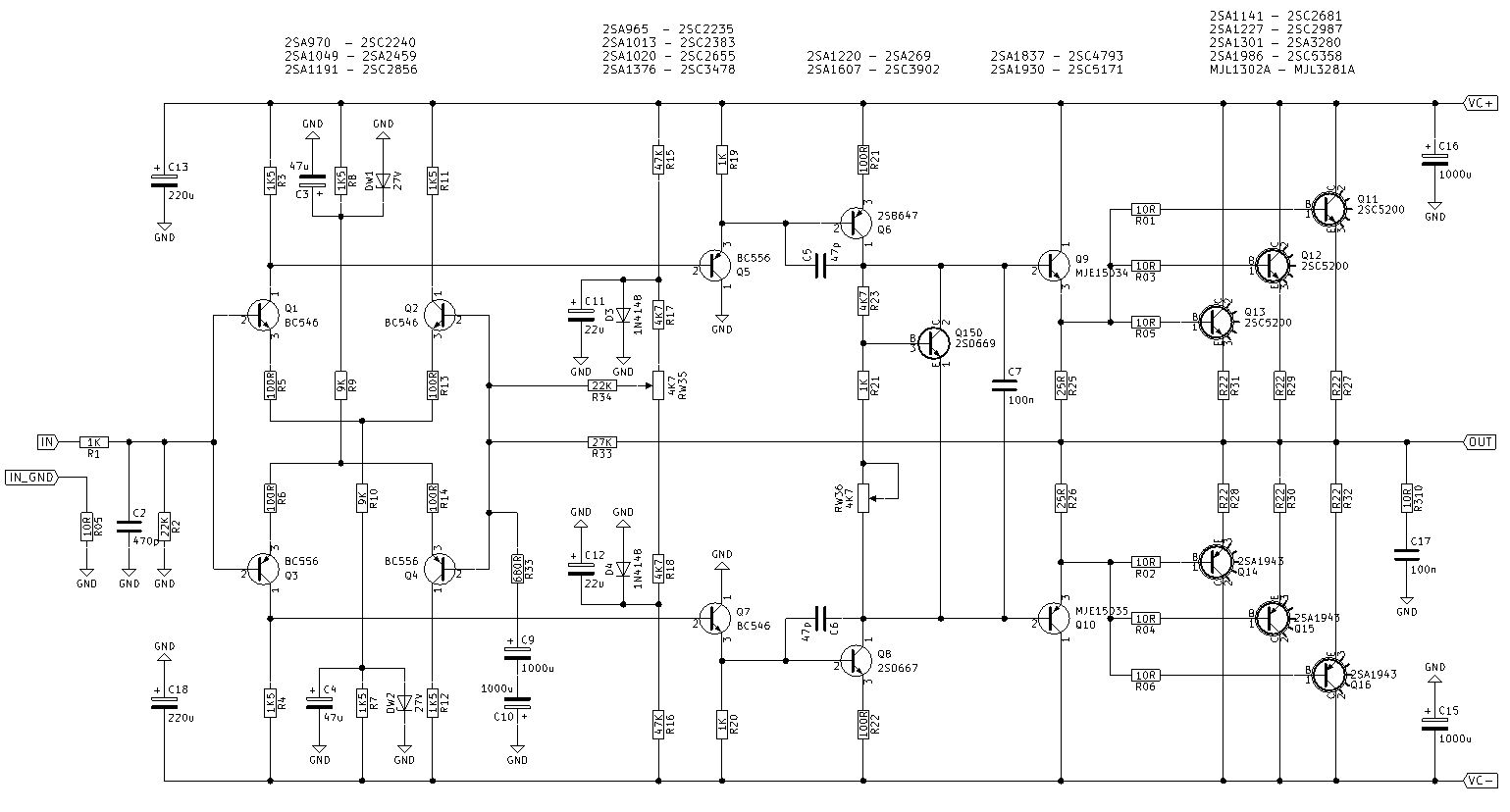

Here is my schematic. Parts used work perfect in my amp build.
Both 4148 diodes need to be grounded to ground (ground plane) for the circuit to work properly. The other end of each diode goes to a 47k resistor then to the + and - power supply rails.View attachment 1432417
You should be able to visually check to see if the diode is grounded or use a meter to check continuity.
Thank you for your help
Like you said above, In the picture below, diode under the tick mark - one end is connected to ground and other end is connected to 47.5K resistor.
However the dioder under the cross mark, one end is connected to the 47.5K resistor and other end is connected to nothing. It needs to be connected to ground plane. The two blue dots on the picture need to be connected
@Dave murrey sussed it out after having a fault on his board.

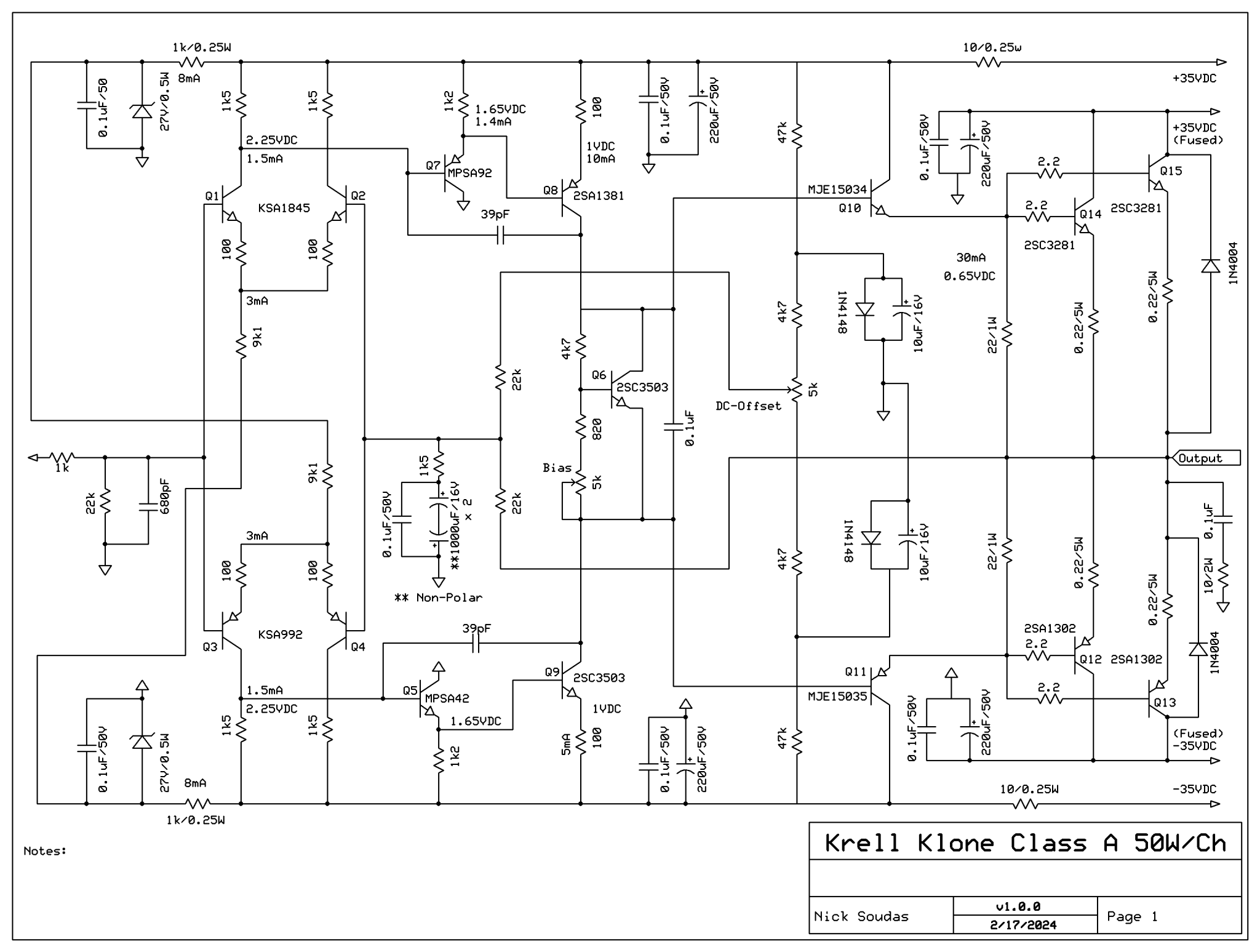

The 968/2238 transistors are VAS transistors in this design. These type of transistors are usually used as drivers, but obviously they can work as VAS transistors too.
I think the KSA1381/KSC3503 are a better choice for VAS transistors. Also, the "middle" MJE15030 is the bias transistor and a KSC3503 would work better here although almost every DIY version of this amp probably used a 15030.
This Class A design is very forgiving in a lot of areas with some operating points and component substitutions.
The Zener references for the push-pull diff amp can be just about any voltage value; 10V~27V. Just have to scale the Zener dropping resistor accordingly.
The 3k3 emitter follower resistor can be reduced to allow more "drive" to the VAS. I think 3k3 is a bit low especially if you use the original transistors (MJE15xxx). I use 1k2 with MPS42/92's.
Even MPSA42/92's have been used for the diff amp with excellent results.

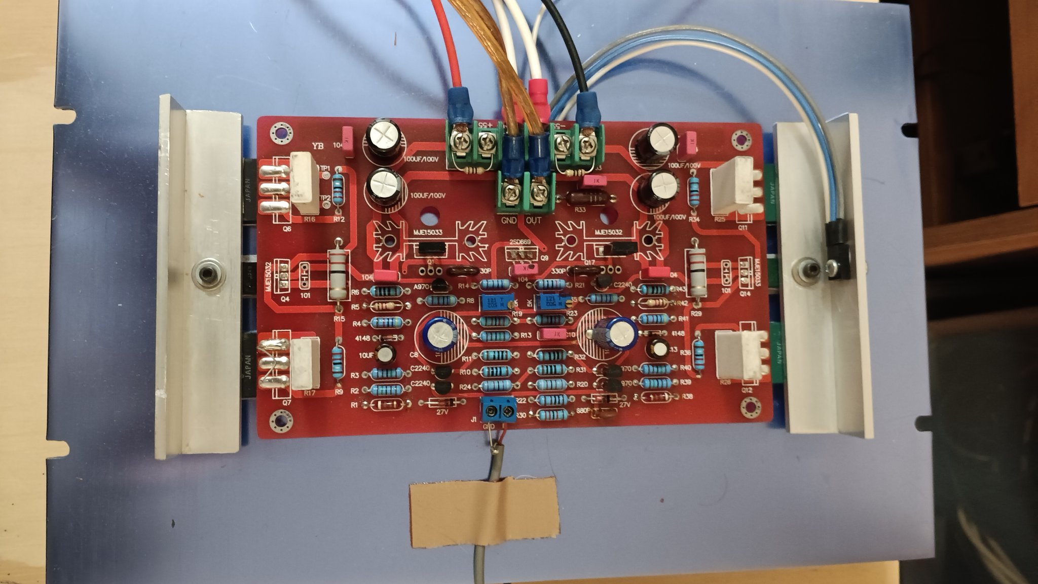

Here is one channel of mine. Still have not put it into a chassis, but works great! Dead quiet and exceptional performance.
On my version, I am tracking the output transistors for bias instead of the drivers. No issues.
