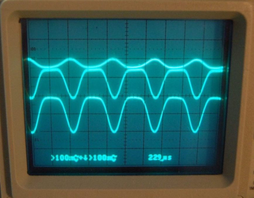

syn08 said:
- Connect a small resistor R (1ohm will do) in series with one of the output transistor collector, say between the upper transistor and the positive power supply rail.
- Connect one probe (CH1) at the collector.
- Connect one probe (CH2) at the positive power supply rail.
- Select proper ranges for CH1 and CH2, to allow both traces on the screen.
- Power up the amp.
- Press INVERT on CH2 and watch the trace go down to minus the supply rail.
- Press ADD. The single trace on display shows the collector current and if R is 1ohm, the indication is in amps.
I tried this. I have a .82 ohm resistor between output collector and the positive rail. Done on my Krill facsimile.
This look about right? top trace is (inverted) channel 2 at the positive rail, bottom trace is channel 1 at the collector and middle trace is both added.
All there traces have to be directly coupled and the offsets spot on (zero)
It would be much easier to just use one channel by floating the CRO ground on the amplifiers positive rail. You can do this by by either floating the CRO mains earth (preferably with an isolation transformer) or floating the amplifiers earth/ground along with the signal generator. What are you using for a signal generator? If it is a battery powered unit the latter would be the easiest test method.
Hey Glen,
Are we not getting an idea though? The flat area?
My function generator is not battery powered (grounded IEC). I don't have an isolation transformer for my scope either.
MJL21193 said:Are we not getting an idea though? The flat area?
We do.
