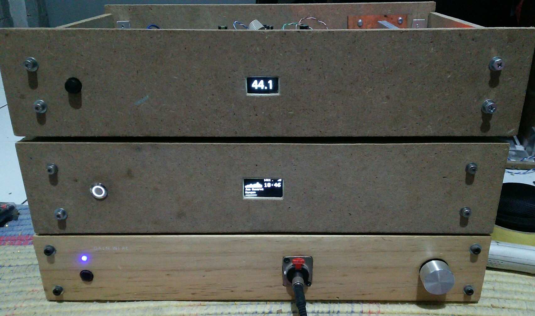

Finished my Dual AK4490 Dac. Heatsink almost hot, i thing input supply too high 12vac. But overall it good. Thanks Salas

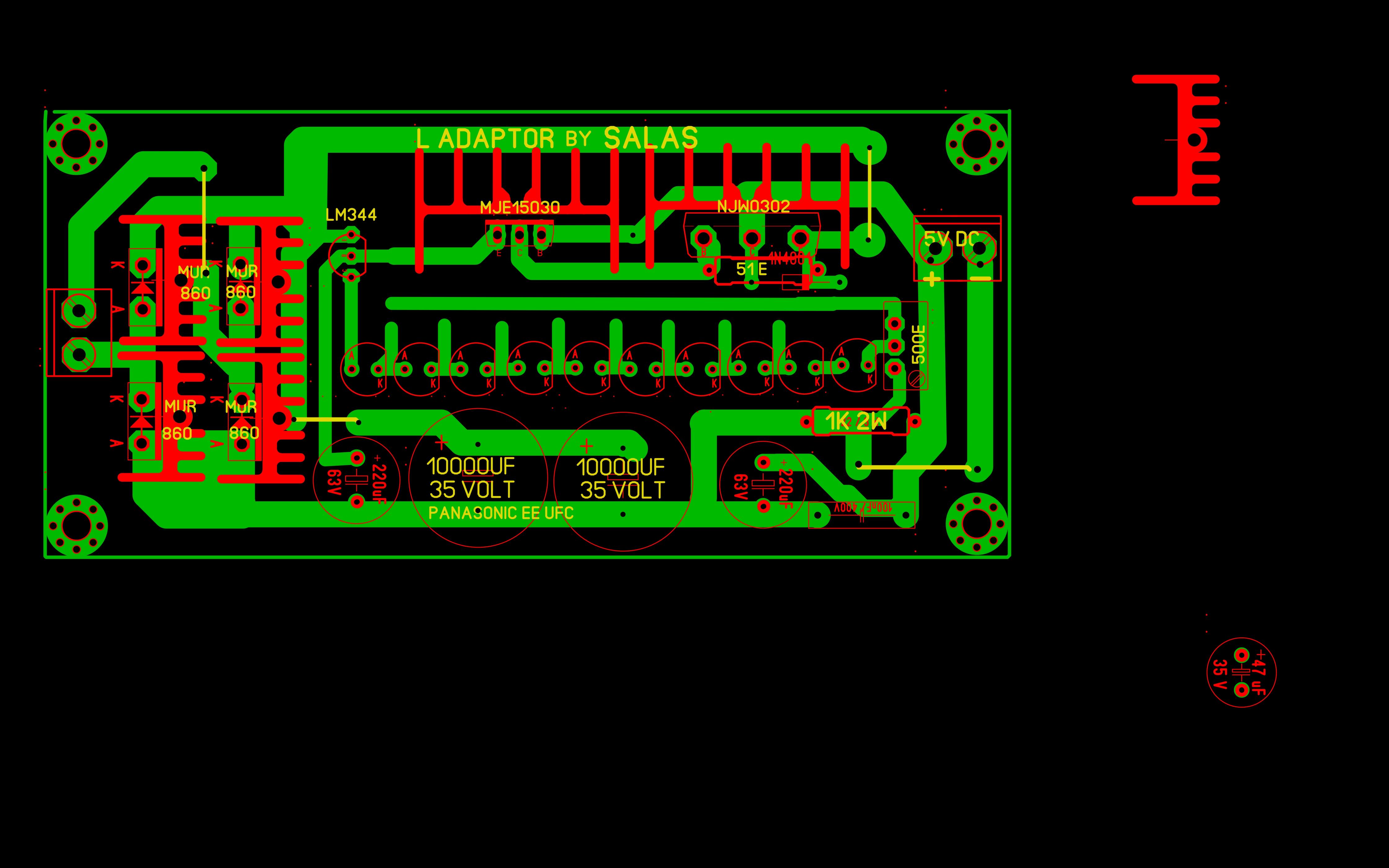

A circuit I tried and liked is this, using npns instead with its benefits. Might be an idea to modernize.

The guide recommends 9VAC Tx for 5VDC. Your drawing will not work well because it misses Rset for the LM334.
It has wrong LM connection too and misses a practical way to easily set a number of active LEDS.
An unofficial board should also have the "clone" indication. Because some people make copies of wrong things they see on the internet and then refer to me for problems.

Hello Salas
greetings and sorry for posting pcb i am only hobbyist i am making
power supply for small rasberry pi dac player i dont see 12 ohms
resistor in the schematic but its in the BOM is it possible to guide me
warm regards
Andrew

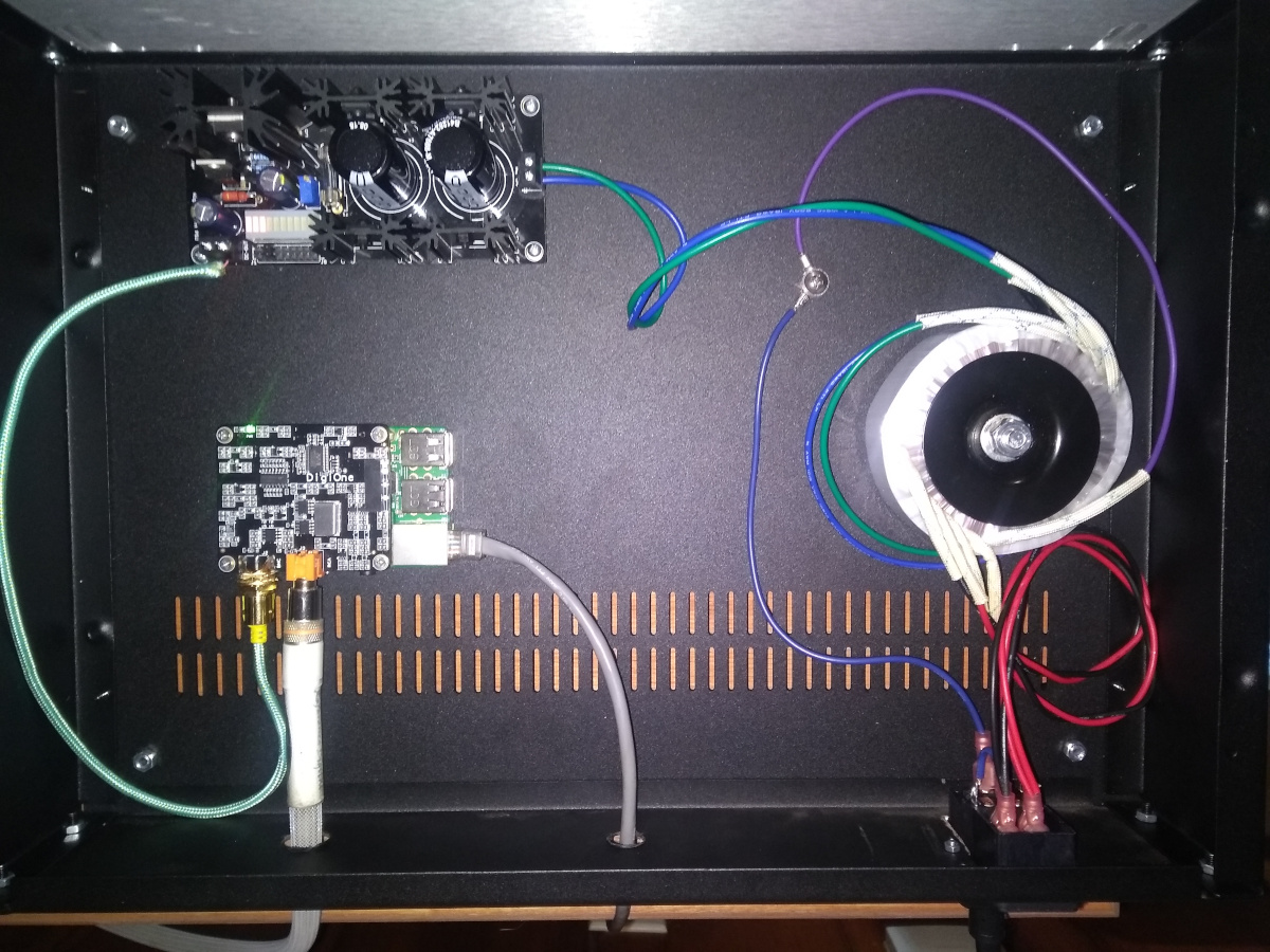

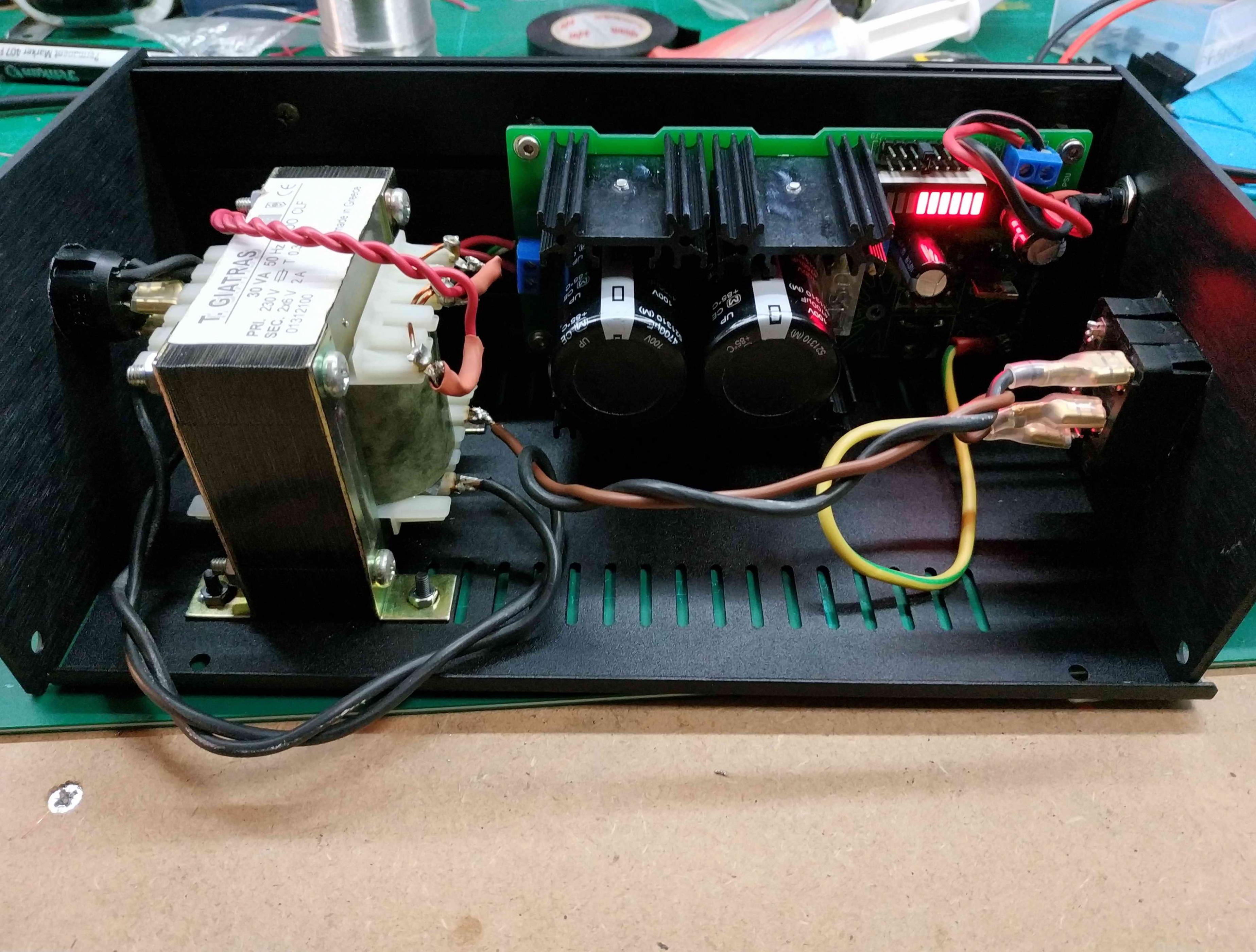

I had built an L-Adapter a while ago to power a Raspberry Pi and Allo Digi One. I finally ordered a transformer for it. The Pi was being formerly being powered with an iFi power supply. I put it all together yesterday in a way-too-big chassis. I wasn't expecting a change in sound because the iFi didn't sound any different to me than the cheap switcher that I had originally for the Pi. I'm not sure if it is only the power supply, or if putting the Pi in a big metal shield helped too, but it sounds quite a bit better now. The highs lost a little ouchiness they had, and the overall sound nice and warm. I'm quite pleased with the results.
