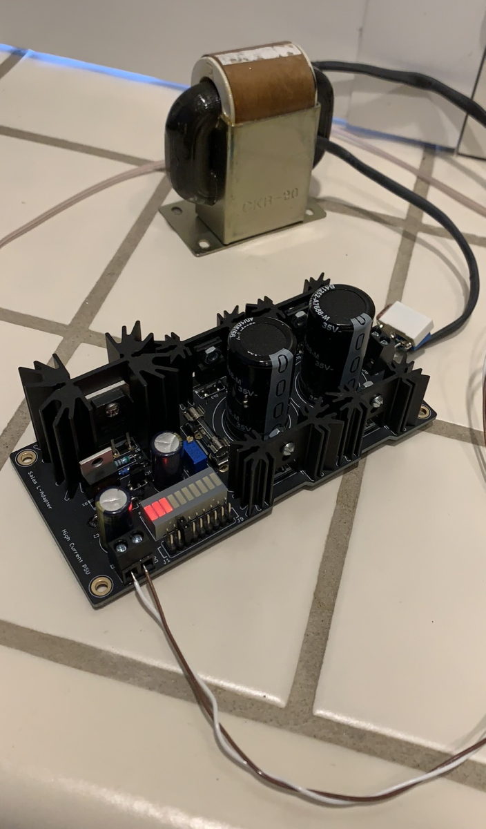

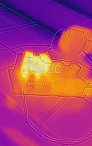

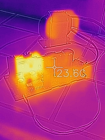

OK - I've now hooked it up to just the Sonore Microrendu. Feeding it with a 6.3v 3A R-Core transformer. Rectified DC voltage is 9.6v and the output is adjusted to 6.1v. The Microrendu wants a 1A power supply, so the pass transistor should be dissipating up to 3.5W, depending upon the actual power draw. I took a few pictures showing the thermal profile. At this power level, temperature rise is pretty modest.
I added a snubber to the transformer and also played with the polarity of the transformer secondary. In various digital projects, I've found that one orientation of connection from the transformer secondary to the power supply sounds better. This was true for the L-adapter, so I'd encourage people to try swapping the 2 AC leads connecting to the board and seeing if one sounds better.
And now I've hooked up the Khadas Tone Board DAC, which draws another 0.5A from the power supply. Rectified DC voltage drops to 9.14v with the added load and the temperature of the pass transistor rises a bit. Theoretically the addition of the Khadas adds another 1.5W of thermal power for the pass transistor to drop (9.14v - 6.1v)*0.5A. But the drop in the rectified voltage means the base thermal dissipation is a bit lower. Temperature of the pass transistor rises from 32.1C to 39.2C. Still quite reasonable. But the pass transistor heat shink might be marginal for a full 8A load.

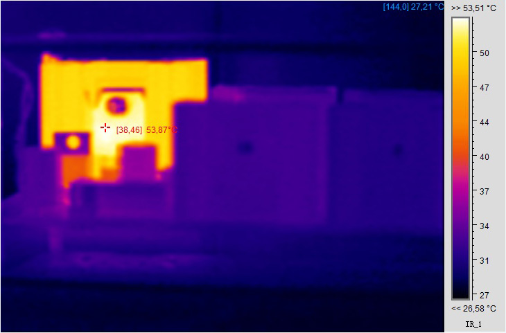

Few more volts to drop... heat! Side note on measurements (on an IC), with the thermocouple on my DMM I got a surface temp of 48°C when the IR camera shows 58°C on the hottest spot of the IC! Scary! Maybe the IR sees "inside" the IC... On a heatsink they are in the same ballpark.

That temperature difference computes for Watts burned and RθJC?
No way to know, RθJC not given as it's a SMD DAC chip on a class A output stage. Heatsink side: 56/56°C, other side with spacers // DAC board: 48/58°C... Maybe I'll stick with my Fluke thermocouple and will not borrow the office IR cam anymore, troubles my mind 🙂 No clue at all! Sorry for digressing...
. . . Side note on measurements (on an IC), with the thermocouple on my DMM I got a surface temp of 48°C when the IR camera shows 58°C on the hottest spot of the IC! Scary!
I think that Salas has it right. Transistors or ICs on a heatsink always have to be hotter than the heatsink - that's what causes heat to flow from the device to the heatsink. The temperature difference should be the thermal resistance of the interface (degrees C/Watt) times the power being burned in the device. So a device burning 6 watts with a thermal resistance of 1.5W/C will see a 9C temperature difference to the heatsink.
10°C difference depending on the measuring device.
Any way to calibrate them both?
No, if I measure something else there is no difference, these 10°C are only when measuring the IC. On the output stage heatsink they are within the same °C.
But you have a point, the Chauvin Arnoux camera can behave oddly sometimes, as there is air and reflections around, can it be that more IR waves are seen?
Sorry Salas that was just a side note! 😉
