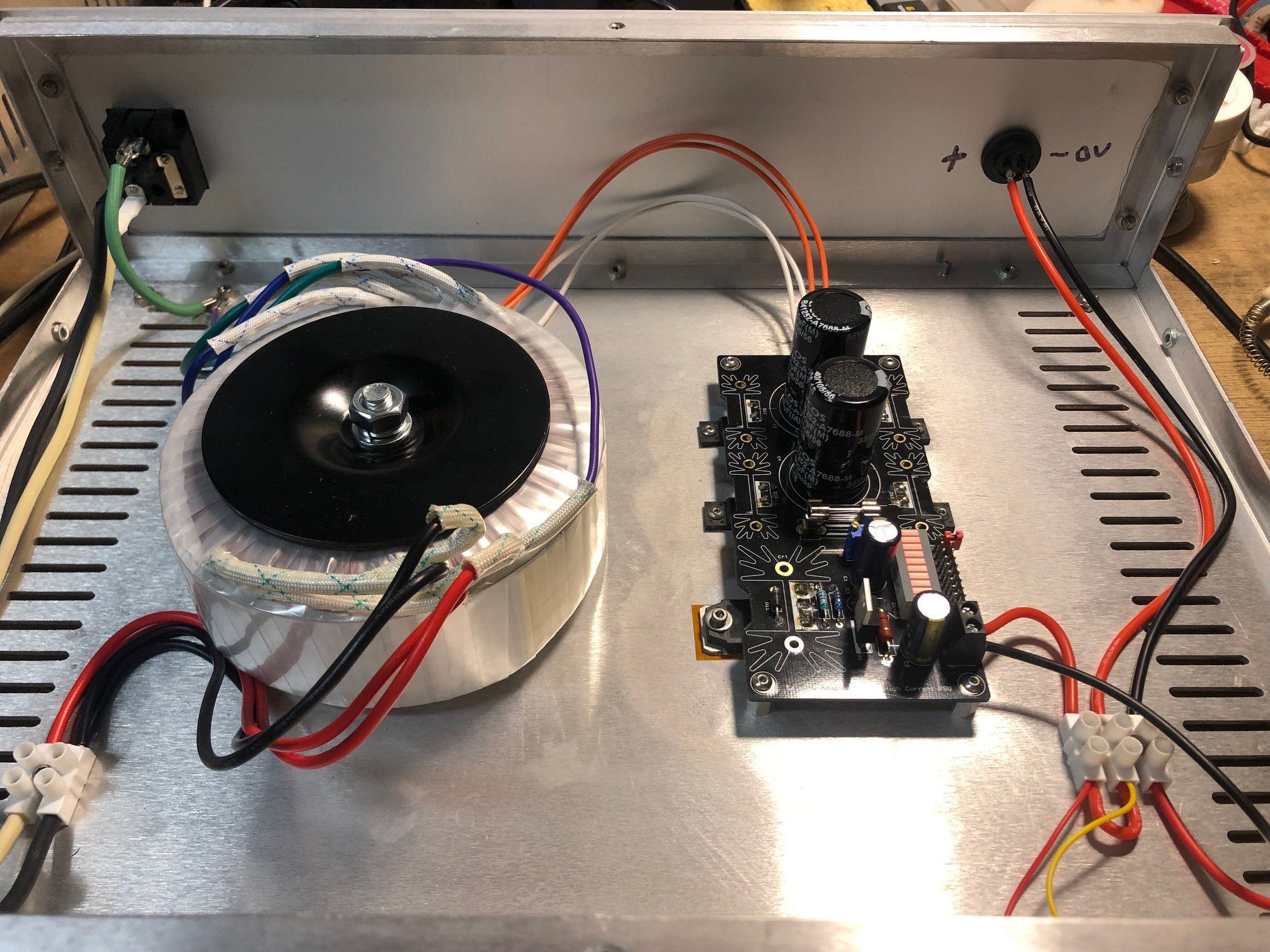

I'll put in a 5A slow blow and try againTo properly fuse a 300VA 120VAC mains transformer it takes a 5A slow blow on its primary side. To withstand its momentary magnetic buildup inrush.
There's substantial reservoir capacitance on the L-Adapter pulling charge up inrush current for a little bit longer too.
26VAC secondary maybe too plenty for 19VDC 3.5A reg out. Can add some unnecessary Q2 dissipation. See how much raw DC is made across the reservoir caps and if they are well rated for it.
Why you only saw 7V+ initial DC output I am not sure since you didn't find something obvious in the rest of the circuit yet. Try set J8. Check if healthy Vbe on the driver and pass transistors first and also see not to have oriented any caps or the diode (D11) wrong. R3's value should be checked too.
I checked and the secondary is 24 VAC and what I measured was unloaded. But I agree that may be too high. I will switch the transformer to 22 VAC secondary. Is the 300 VA too high for 3.5A DC?

24VAC unloaded is more manageable than 26VAC and you may try with that for now. If loading and sink temp are happy keep it. Transformers nominal is a bit all over the place for various reasons, there are 22VAC that could give 24VAC unloaded and so on. 150VA-200VA would also work without much strain for 70W DC (20V*3.5A) and 300VA will run coolest.
There is not a too much VA problem when you already have it. Except if creating a transformer size fitting problem in a given enclosure. Electrically its just like using a higher power resistor than the lowest rated.
What you want is good (>2.5V) DCraw-DCout margin after ripple deduction at peak load consumption. What a DC meter shows is always after ripple.

I realized C3 and C4 are only 35V so I ordered 50V versions and will swap them out on Saturday. I also ordered another set of components just in case I damaged something. My guess is those 35V caps saw 37V for a minute or two. Not sure if they're toast or not but replacements are on the way. Even if I switched to a lower voltage secondary (22V) they would be right at the limit.

You know, there are silicon losses increasing with current, and there is AC ripple riding on DC increasing and eating some of it too, so its more practical to measure what DC levels you get at various points in your own application before becoming a theory expert. You want to strike a balance between enough but not excessive DC voltages for manageable Q2 dissipation sinking temperatures, still with ease of load drive. A certain load of your interest.

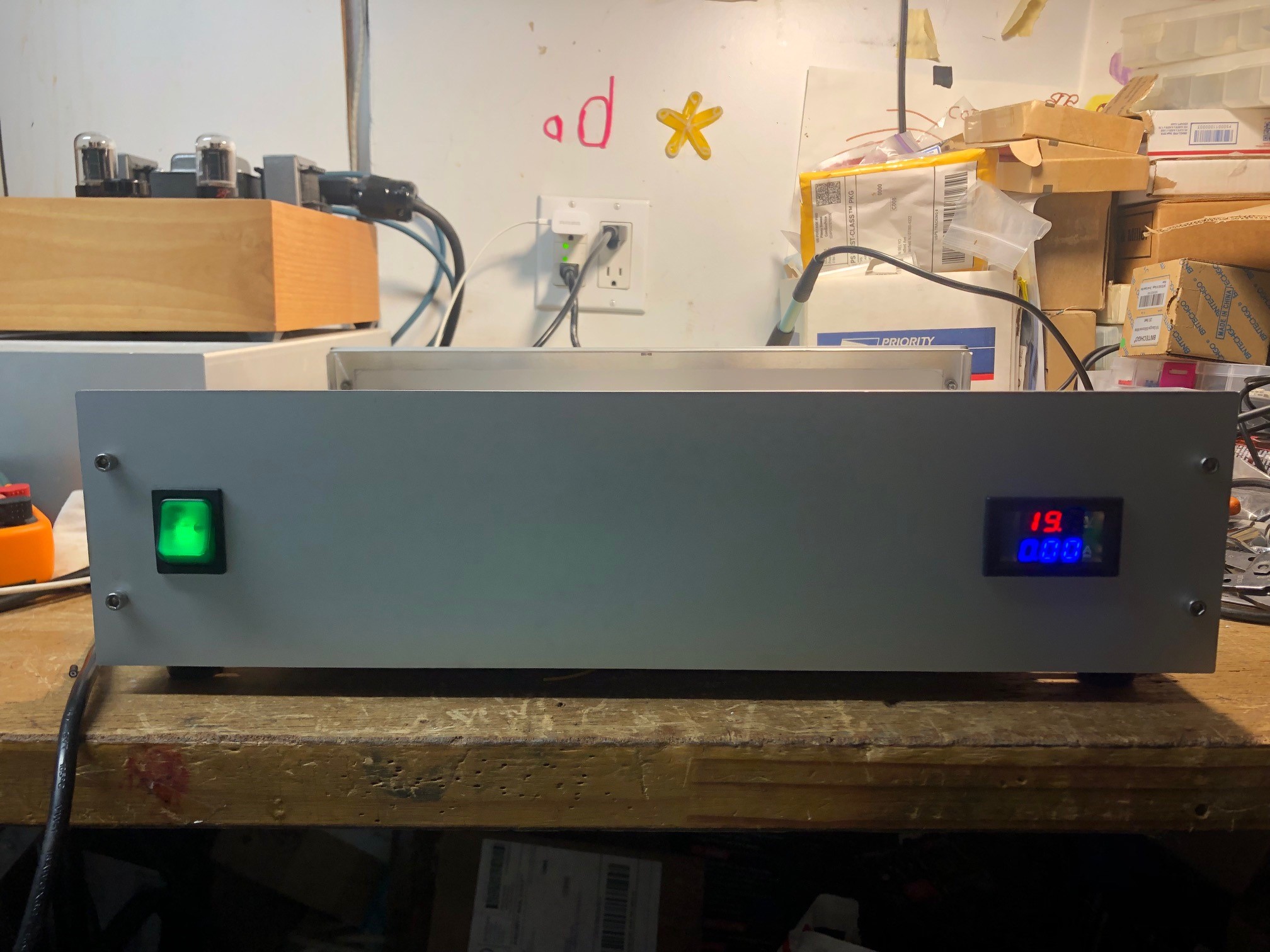

I reduced the VA to 200 and used a 3.25A Slow Blow fuse.5A slow blow trafo primary fuse in the end? What is the capacitance of those Epcos? Nice touch the front panel meter.
The caps are 6800uf 35V
I probably should've used 10,000uf I have some just is case it's an issue. I just didn't want to desolder them.
