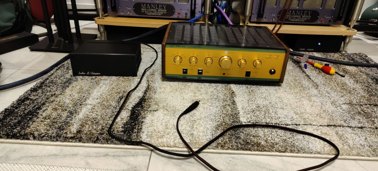

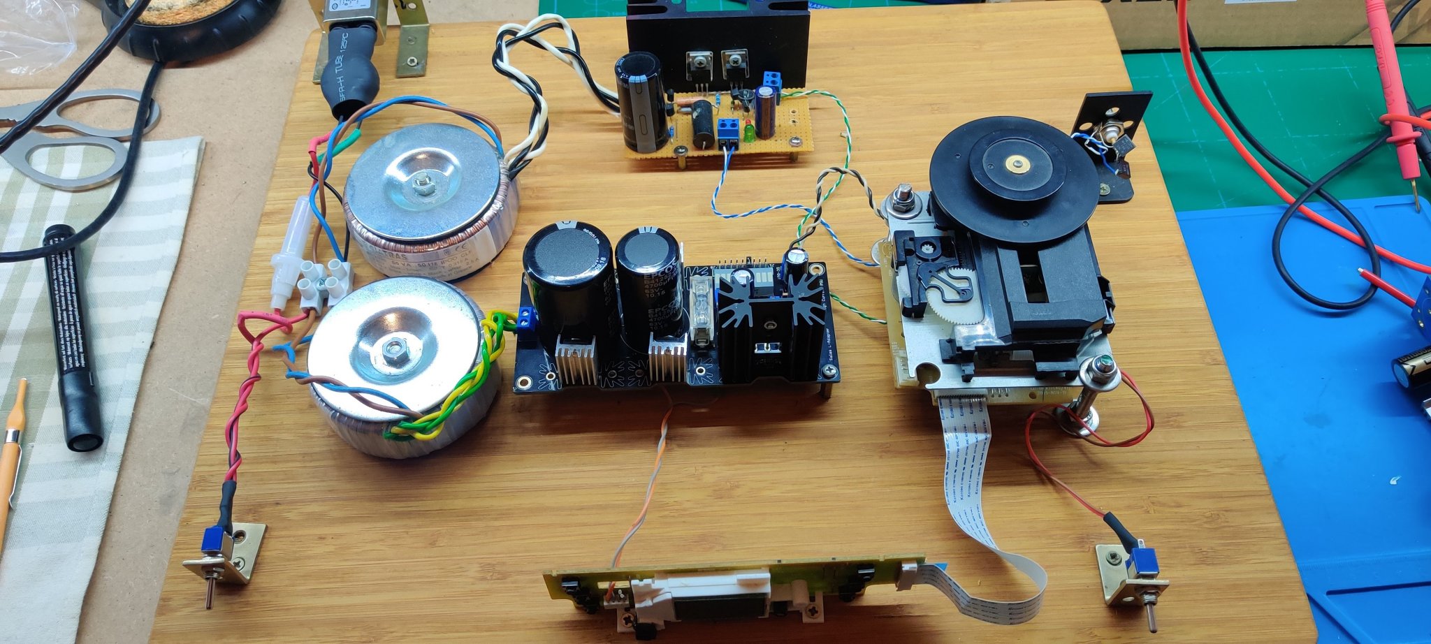

A couple more L-adapters, one for the 8 volt supply on my, still after many years, brutal Shigaclone cd player (the other is a Reflektor) and a 19 volt supply for my NUC i3 pc, doing playback duties with foobar.
I can say unexpected improvement of my digital playback. More depth, naturalness and a sense of less digital glare. It seems easier to listen to digital for longer, which was not easy for me, spoiled by my LPs.

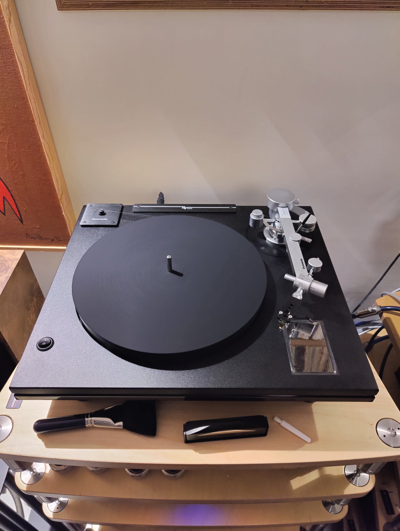

I decided to build one more L-adapter,after having two more(one for my Raspberry pi 4with volumio,and one for my Logitech squeezebox touch),for my dynavector dv 500 turntable, which is a well tempered Amadeus GTA with dynavector dv507 mk2 tonearm.i wasn't expecting so much improvement,I already had an lm317 linear psu.i was wrong.more black background,less grainy sound.thanks Mr Salas!

Interesting. I wouldn't as well expect a small DC motor to be helped out further when already on linear PSU. But the proof of the pudding is in the eating. Yet another successful L-Adapter application then. TT PSU! Nice output cable dressing by the way.

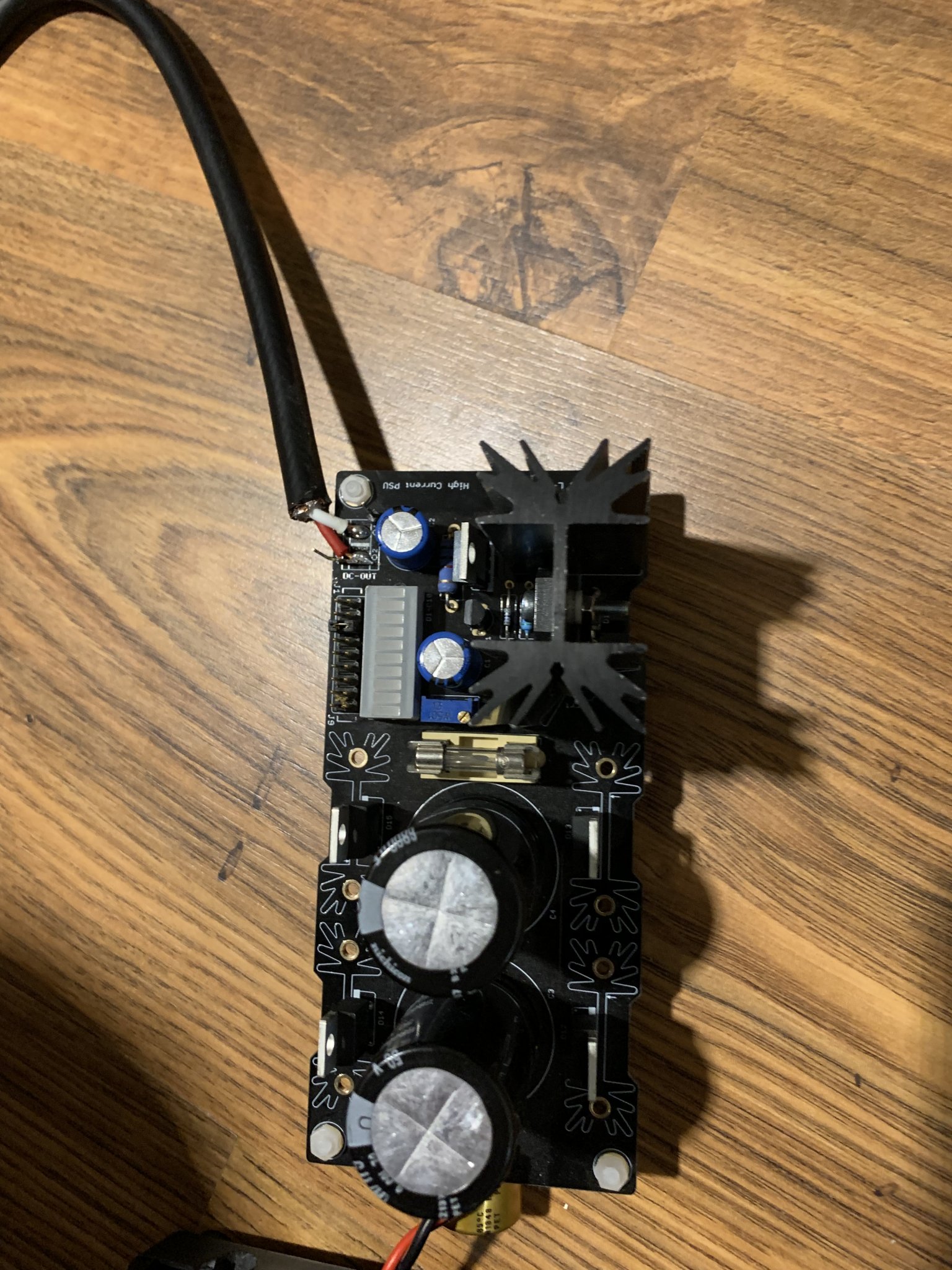

Ive been using a couple l-adapters for various 12-15v needs with great success. (Thank you!!) The other day I tried to replace the smps brick on my NUC i3. The smps has a rating of 19v/4.7A. The NUC runs just fine on 18V so I picked an 18V transformer. The transformer is 100VA, which is less than the 1.5x suggested in the guide but long term tracking showed that the NUC never goes above 10% CPU load shuffling music files around so I didn't figure I really needed more than 5A from the transformer. (I probably should have just directly measured it but I was being lazy)
Anyway, I'm getting nearly 27V after rectification. Which means I'm burning off more than 7V. I've got the heat down to a steady 36C. but it took a lot of sinking to get there. Far more sinking than what is needed at 15V.
Just wondering if all of this heat is normal or if I miscalculated something along the way?
The guide says to stay >2.5V difference but "not much higher". What would be considered "much higher"?
