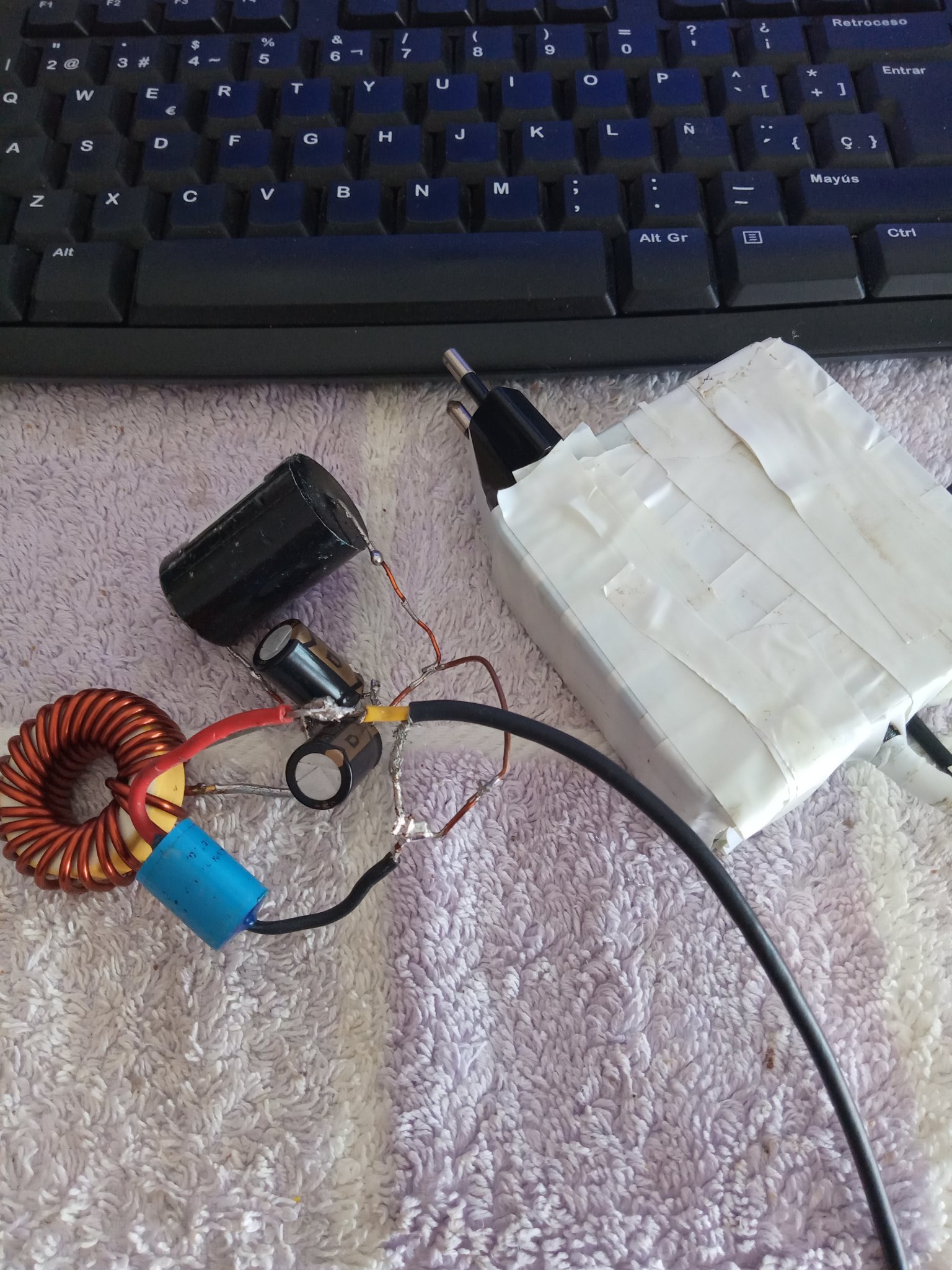

Testing, it seems works ok.

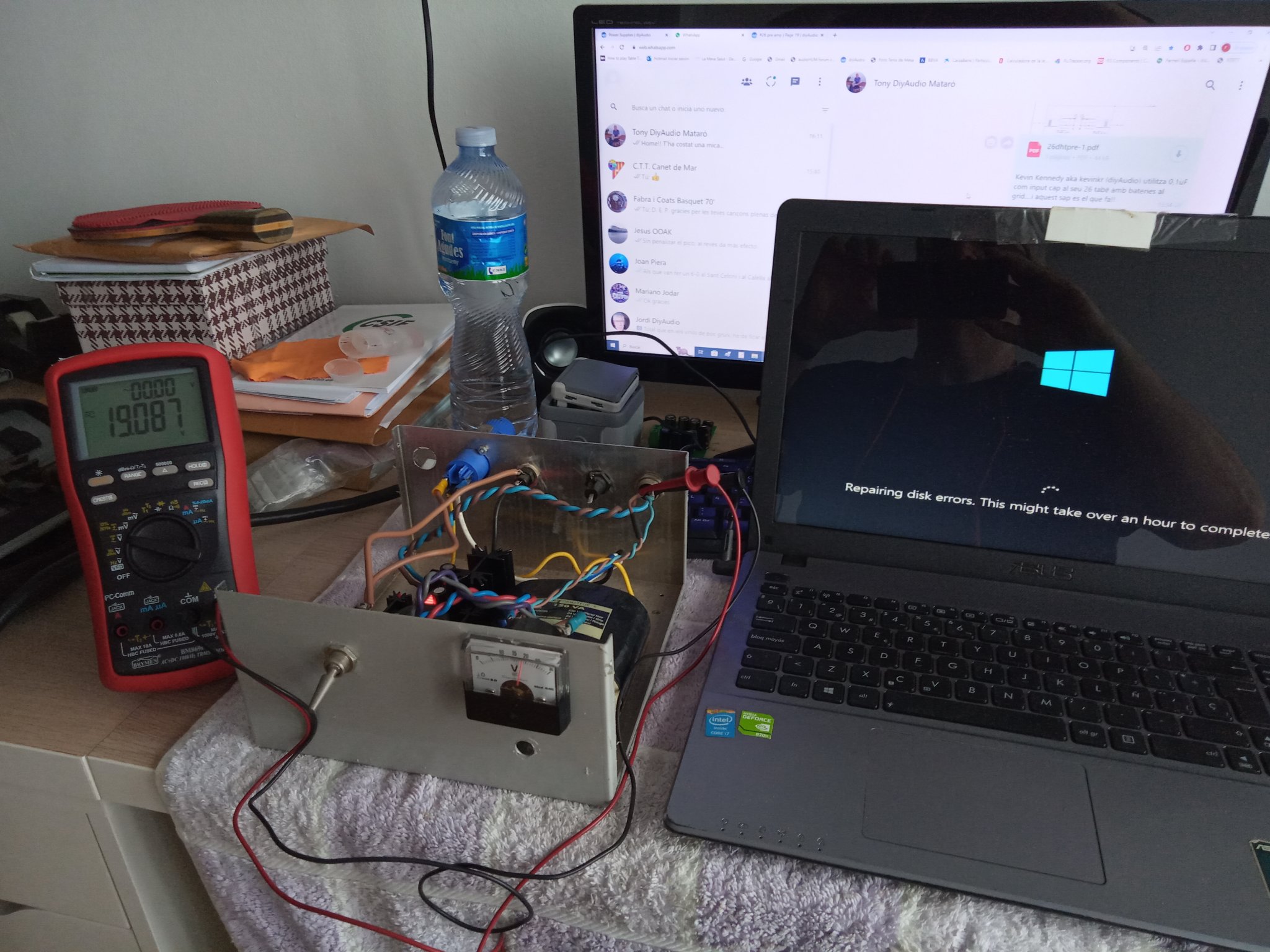

Changed the heatsink for a bigger one.
Yesterday all night listening music using the L-Adapter powering the laptop without issues.

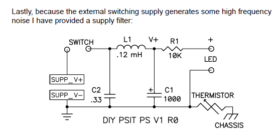

Not a big change to the sound, possible due to the fact using a SMPS filter.
Now can use the Daphile DSD256 upsample without a lot of degradation of signal.
