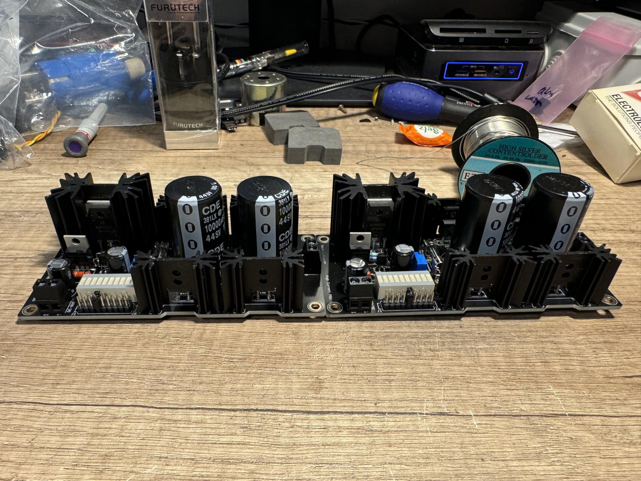

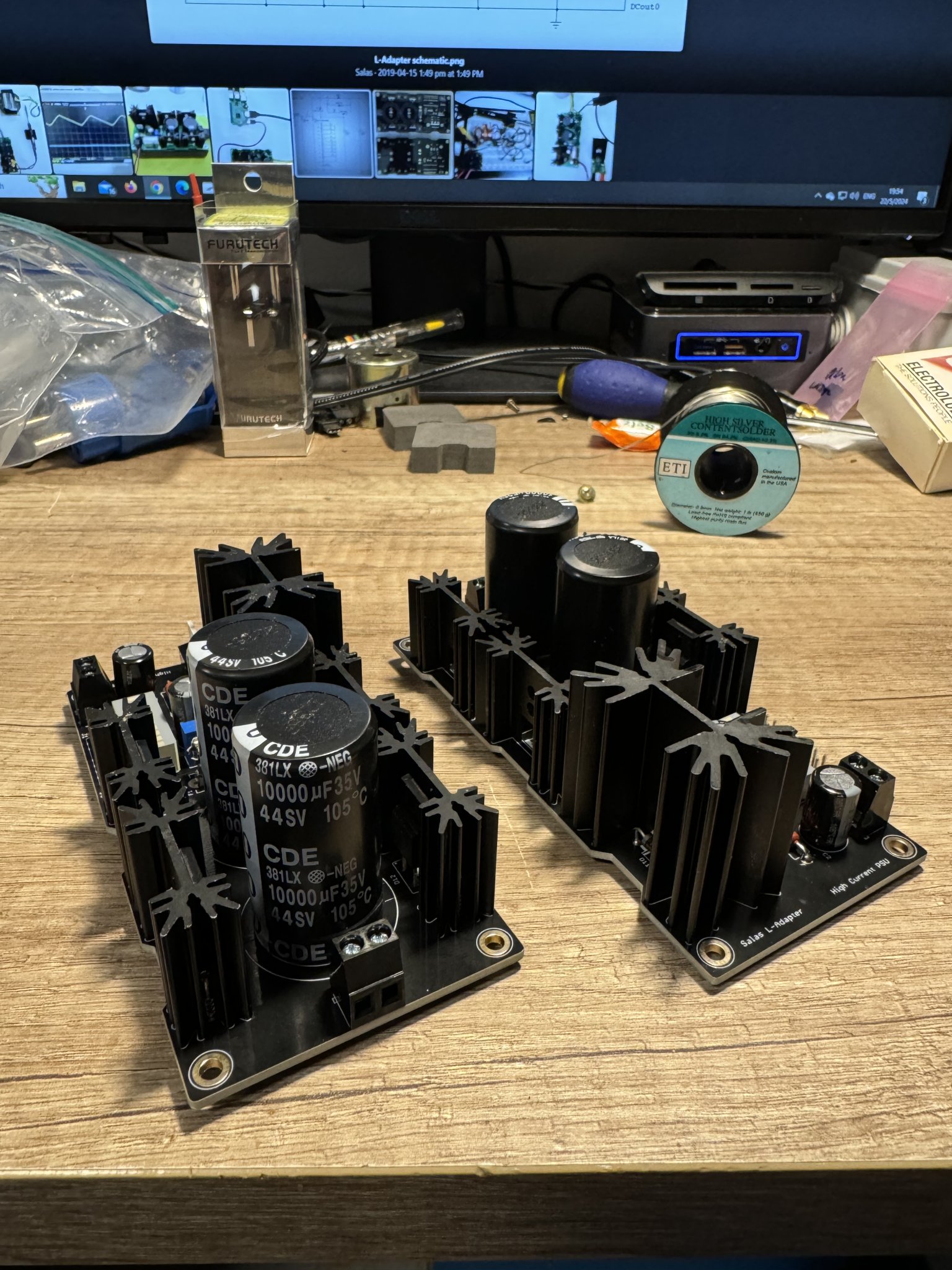

I've soldered most parts except for a missing IC1 regulator. But I also realized I forgot any thermal pads or paste between the heatsinks and rectifiers/transistor(Q2). I only want to confirm that I really need the thermals, then I will try to arrange it without desoldering...
EDIT: just read the guide again and understand that it is not needed when sinking is done on board. Correct?

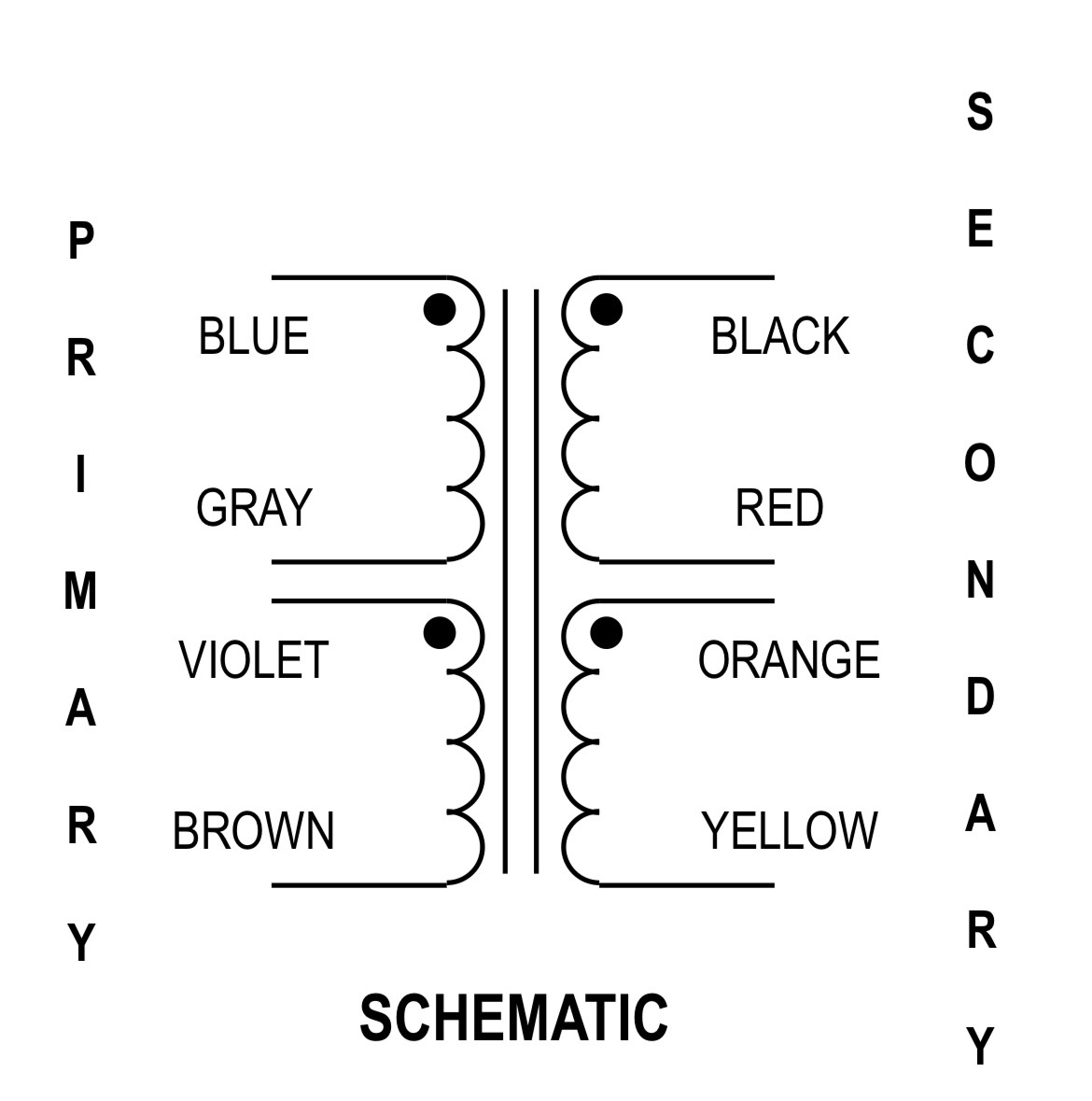

A question about transformer wiring. I have a toroidal with 2x9v secondary, which I will wire in parallel. According to the schematics that means wiring together black/orange and red/yellow. Correct?
My simple question, does it matter which connector each pair is connected to at the input of the l-adapter?

Got the L Adapter working for the 24 volts supply for the SOTA Condor turntable motor and I have another one of "those questions".
Using the HLMP-6000 leds I found I needed more than twelve so I added two more. I think 15 would allow using minimum resistance to have 24 volts. I put them on a small perforated circuit board and have them connected at the first led position.
The question is: Is it best to use as much "led" as you can or is it good to have resistance in addition to the leds? I am guessing I would only need about 100R with another led in the chain.
Does it matter at all?
