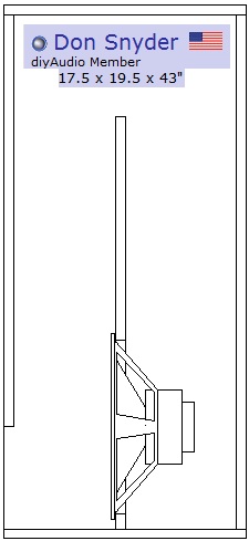

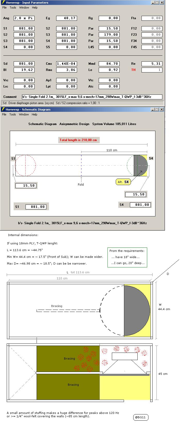

I was looking through old posts yesterday, and I re-read justint's build thread (http://www.diyaudio.com/forums/subwoofers/185836-3015lf-th-35-40hz-but-only-20-deep-help.html) . This straight-pipe build was 44" tall.
Seems like by substituting the LAB-12 driver an even smaller enclosure could be designed.

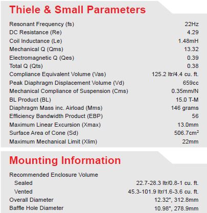

I am attaching info from justint's build and the Thiele & Small Parameters for the LAB-12.

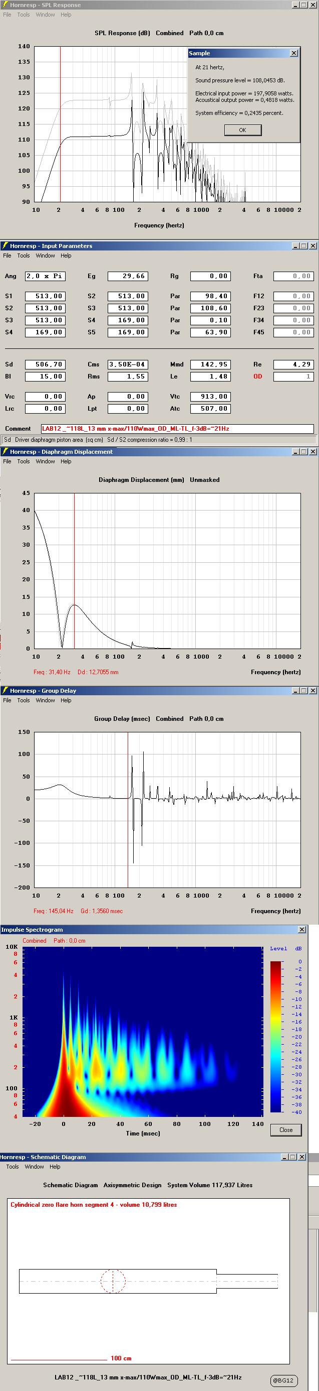

Submitting an OD-ML-TL that can be XO:d at 145Hz using a LR4 LPF (250 Hz= -20 dB down)= max Rec. frequency for to not fall
b
Submitting an OD-ML-TL that can be XO:d at 145Hz using a LR4 LPF (250 Hz= -20 dB down)= max Rec. frequency for to not fallinto localization problems.
b![]()
Bjorno,
What is an OD-ML-TL? The data looks perfect for what I want. I cannot believe it extends down to nearly 20 Hz flat. Wayne Parham (Pi speakers) recommended running flanking subs up to 120 Hz, seems like this would not a problem for this design.
Thanks once again for your assistance! I was really hoping you would weigh in.

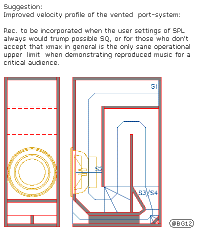

Hi Y'all,
Sitting here w/ minor chemical burns on three fingers (stupid, stupid, stupid), and can't really do anything usefull, so here is rough try at it:

Hi Y'all,
I feel your pain on the chemical burns...in organic chemistry class I set my hand in a puddle of concentrated phenol - the skin was sagging 3" on the side of my hand when I first felt the burn (still have the scar today, 20+ years later).
Thank you for the folding of the design, now that I see it I can make sence of the data presented by Bjorno. Very nice compact enclosure, looks relatively simple to build.
To my untrained eye, it looks a lot like a slot-ported enclosure, how does the performace differ (I am sure that it does)? If you raise the driver does it change performance (not that I want to, I am just curious)?
I like the looks of this build!!!

Hi NWCgrad,
Post #15: "... it looks a lot like a slot-ported enclosure, how does the performace differ (I am sure that it does)? If you raise the driver does it change performance..."
I think the slot is high enough @ 2.119" to give you a very similar performance to the model; but, with any folded port with a wide aspect ratio it might take a little experimenting. One way to change this would be to run a center divider (e.g.: a 2x4) down the middle of the slot/duct and raise the duct height to make up for the lost cross-sectional area.
If you raise the driver you shorten L12 and lengthen L23, this will change the performance from the model. You could raise the driver, reroute the L12 path (straight up to the top of the enclosure, then back, then down) and the L23 path (lower the horizontal divider, and shorten the vertical divider to make up for the length gained by raising the driver), and arrive at the model dimensions; the "room for amp" would now be in the middle of the back of the enclosure (I think)
This is thought as a starting point, you can add corner reflectors, braces, cleats, widen the box, add midrange and tweeter in the front.....
