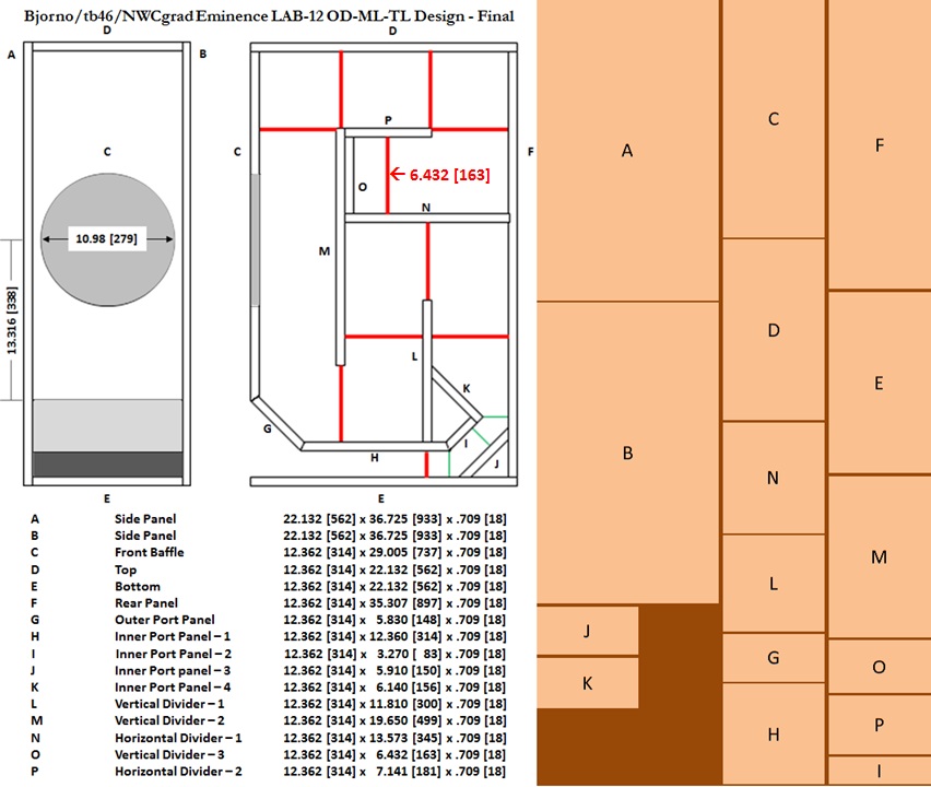

I have completed the final plans for the suboofer (attached). I made a 1:10 scale representation in powerpoint to calculate the exact dimensions of the materials used in the port and used the sizes of the boxes that made up the partitions for the actual size. Hopefully it will be close enough!
When I start to build the enclosures next summer I will first cut the two sides of the enclosure and make a drawing on the cut sides to verify all calculated measurements. I was able to fit the enclosure on one 4x8 standard sheet of plywood. Plan is to use US-made Red Oak A-1 domestic grade plywood (Plywood at Hardwoods Inc, Exotic & Domestic Lumber in Frederick).
From Bjorno's documentation it looks like I will need 1.066 lbs of stuffing.
Thanks to all who assisted or provided feedback.

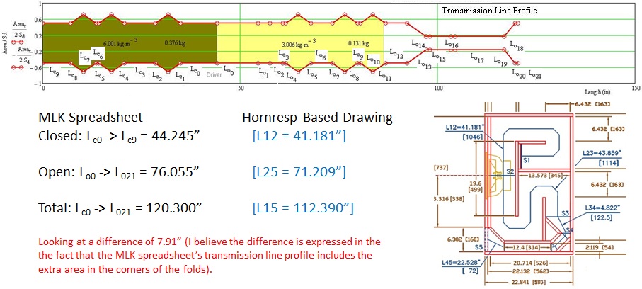

Did I calcluate Hornresp correctly???
I am trying to figure out Hornresp (still, it seems I forget info as soon as I leran it). Looking at the original Hornresp input from Bjorno and the final drawings by tb46 there seems to be some minor changes, especially with the modified port system developed by Bjorno.
With the folding and dimenstions provided by tb46 that I modified the folding but not volume or length of L12 or L23, it seems the inputs are a little different.

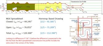

So, the original S1, S2 and S3 was 513, but from the schematic drawing I calculate it to be 511.82 (horn width [16.3 cm] x internal cabinet width [31.4 cm]).
With the new port system, I do not have them at 169.00, I now calculate 169.56 (5.4 cm x 31.4 cm]. Due to the complexity of the port, I calculate horn segment 3 to be 12.25 vice 0.10 and horn segment 4 to be 57.20 vice 63.90.
When calculating the resulting response to the design, I only see minor changes. Are my changes correct or am I way off base. I keep going over the design because I cannot start to build until I return home to US (summer 2013)
Thanks for looking and for all the previous assistance!!!

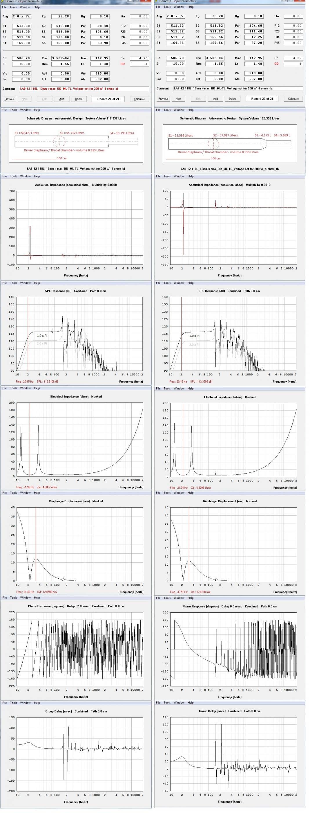

regarding the freq response measurments, what was the power level for the 115db output?
I think it was 100W into 8ohm Rms in 1.0 x Pi

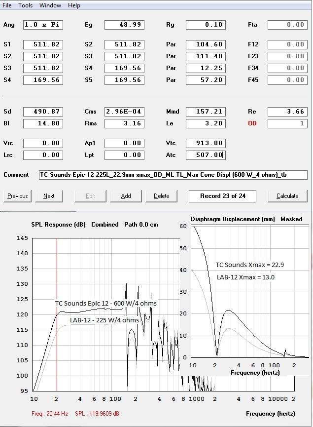

If you "need" greater dB output, you could replace the LAB-12 with a TC Sounds Epic 12 (NO change to the enclosure required). Would take more power before reaching Xmax, but will put out more dB's as shown in Hornresp attachment. Dang...Bjorno (and Tb46) designed on heck of an enclosure. I may supplement the two LAB-12 drivers I already own with two of the TC Sounds when I build the enclosures next summer.
I got the driver replacement idea from DrDyna on the LAB12-Tapped Horn thread (post #139, http://www.diyaudio.com/forums/subwoofers/143714-lab12-tapped-horn-14.html).

I drew the OD_ML_TL in Cadkey using the dims on your final drawing and it looks the same, plus I get the same Hrsp. inputs and results.
One thing that I have not figured out yet is what causes the impedance peak at 36 Hz.
This is where the efficiency goes up to almost 6% and the input power at 26 to 30 volts drops to only 6 Watts or so.

Ya actually 114 db at 20 hz 2 pi will become about 135 in car, and considering thats a 100 watt input, im more than happy.
Thx for the rework tho.

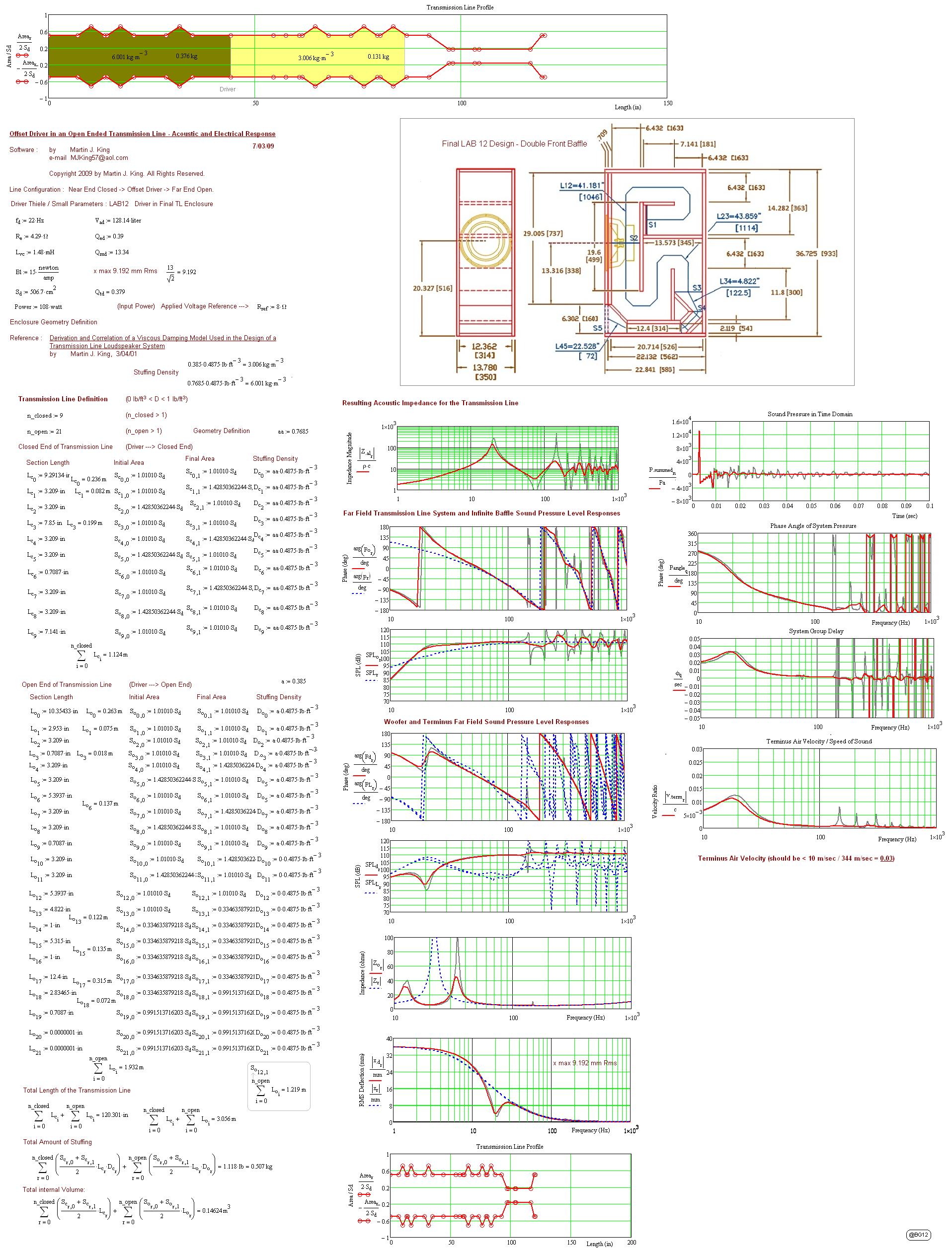

Hi NWCgrad, All
The outline of the suggested port system and the new position of the driver are IMO nearly spot on.
I've tested at least 5 damping schemes and a few different layouts of corner CSA: s / sections definitions.
Check out this MJK simulation I found best to represent your drawing: Look for eventual errors that are 'mistakenly'
entered for the CSA: s and section lengths. I will test the impact of a suitable HPF and post the result later.

I looked at the sections in the transmission line profile in your attachement. It looks like the version in the spreadsheet has a total length 7.91 inches longer that the drawing. I believe it is due to the additional volume showed in the profile due to each of the folds of the enclosure. Thus, I "think" there are no errors entered for the CSA's. All the secion lengths look correct to me, I lined up each length on the model and the drawing to compare and they seem to match pretty well.
Am I correct?
