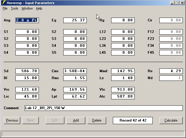

vnwhite,
The correct way to model a port loaded (BR) box is as shown below.(following your drawing)
As to your question, I am not sure.
They both seem to model quite similarly.

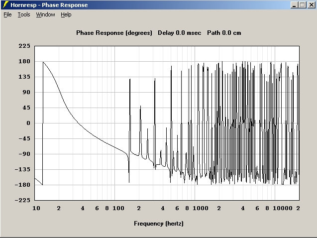

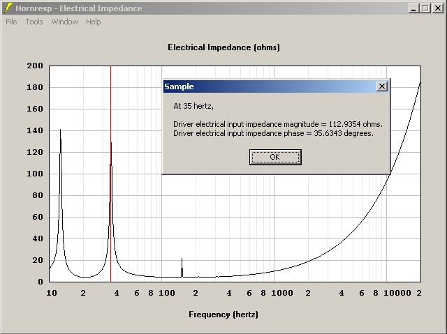

The BR box does have a phase issue right at the electrical impedance peak @ 36 Hz.

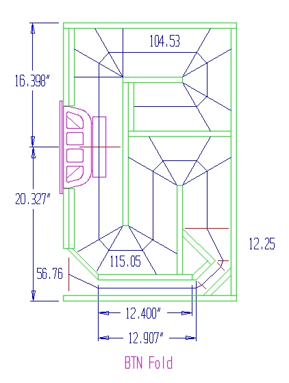

I was confused by the Sketchup drawing of the box, specifically the 12.4” dimension.
The 12.4” dimension should probably read 12.908” as that is the effective length of the top of the port, but the original drawing has a flat on the port's rear top angled board to make up this difference.
This confusion ultimately caused me to build the first version with a shorter slot port.

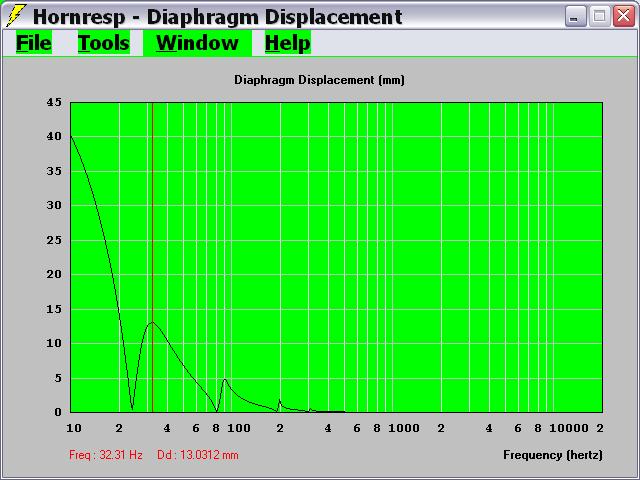

There is a jog in the FR curve according to HRSP that changes drastically with small (1-2 cm) changes in port length but I am not so sure that the jog exists at all after stuffing in the line.

I drew this box using Cadkey in numerous forms, but could not get my drawing to agree in path length with the “original final” sketchup drawing.
I spent allot of time trying to get the path length measured exactly and I am pretty sure that my drawings are correct.

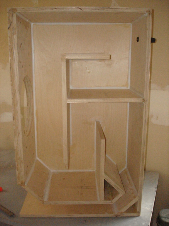

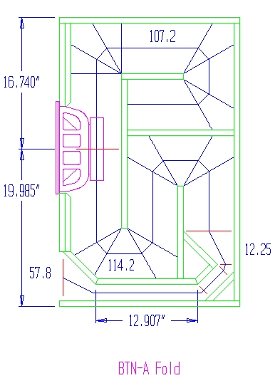

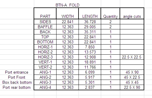

I attached a drawing of the "Original final" design, as best as I could draw it.
The dimensions of path length do not agree with the sketchup versions.

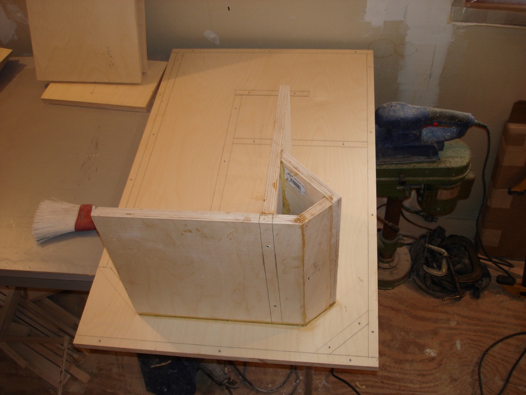

I also attached a drawing of the 2nd box I built (BTN-A), where I tried to copy as exactly as possible the "Original final" design but with path dimensions that HRSP likes.
The hard part of the port is pictured as well as the 2nd box I built.
I decided to use 22.5 degree angles to join the top of the port parts, this both made it harder and easier.
I did not mount the driver in a counterbore on either version but I cut a 17 mm deep 45 degree angle on the back of the baffle in the 2nd version.
I do not know if it will make any difference as the driver has a large open area in the basket.
For now I included a cutlist of the box that I just built, but I strongly advise anyone to draw any box that they are building, at least on the side section of plywood to get everything to fit together.

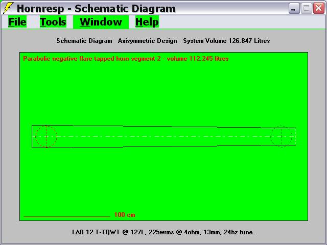

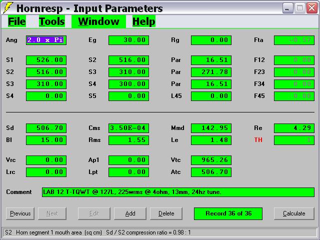

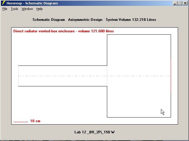

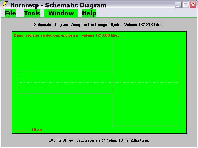

Can someone explain why someone would want to go to the added complexity of a folded T-TQWP design versus a vented design, when Hornresp pretty much shows the same response in the same enclosure volume.
-Vince

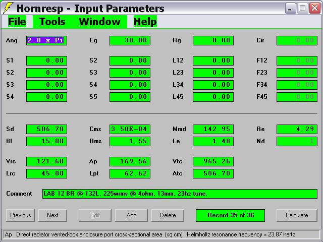

Lab12
132L BR, 23hz tune vs 127L T-TQWT, 24hz tune, 225wrms, 13mm xmax.
Both enclosures can be built with 7 boards.

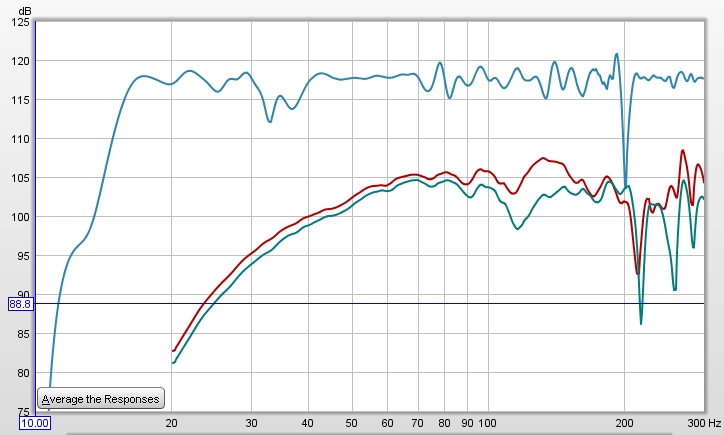

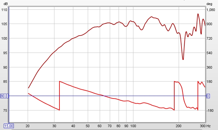

Some more tests

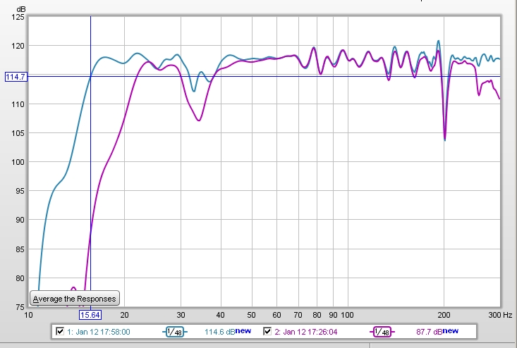

So I took both OD_ML_TL boxes outside with a Crown xti 1002 amp and my laptop with REW an Art dual USB pre and an ECM 1000 mic.
I set up on the lawn with the microphone 1 meter from the front of the boxes and about an inch from the ground.
I was doing sweeps from 20 Hz to 300 Hz and usually doing 2 or 4 and letting them average.
All of my RTA data is unsmoothed (how do people get it to say that on top of the graph?).
The first graph shows my first simplified version box, in room. This was done last January. I also included similar outdoor sweeps of both boxes that I built on the same picture.
These were done with all of the same settings, just outdoors.
I realize that room response is a pretty big thing, but I had no idea how big it was, and how much low extension it can add.
These sweeps were all done with 512K length, 20 to 300 Hz (I did not realize this setting in REW would sweep the driver from 10 Hz to 600Hz, hence some confusion before concerning cone flapping and no acoustic output) and 2 or 4 sweeps.
The data is unsmoothed but the SPL level was calibrated a week before, so I imagine it is not all that far off but I can not guarantee it to be correct.
I have backed down to a 20 Hz, 24 dB/Octave HP filter for general listening and this does not cause any distress.
I run the limiter threshold at between 25.11 and 29.14 Volts and for the sweeps I set the attack to 10 mS and the release to 10 Seconds. (I use 10 mS and 200 mS for Music and HT)

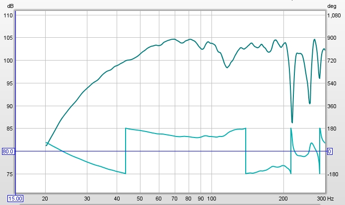

In looking at both the phase information and a small difference in frequency response (not lower extension, but up near 80-100 Hz) there are some noticeable differences between the first, simplified version of the box that I built and the version that closely resembles the “final” version.
I ran the 2nd box at -8 dBFS and the first (simple) box at -10 dBFS settings on REW in the first picture otherwise the curves would have overlapped much more.

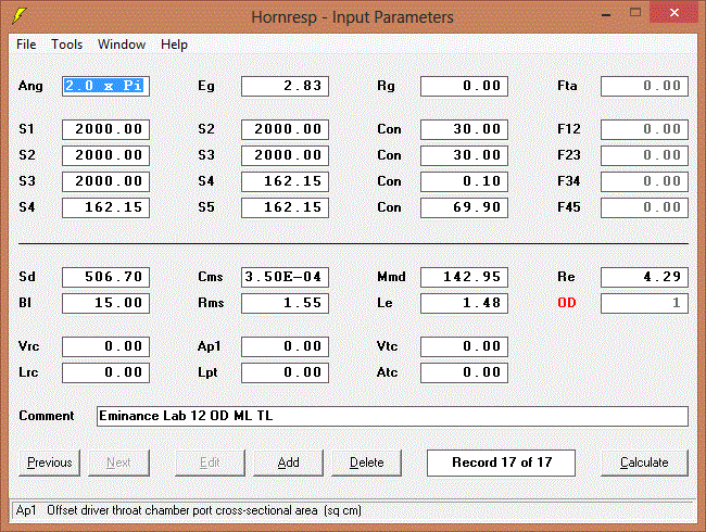

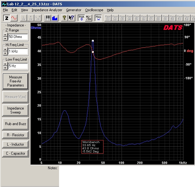

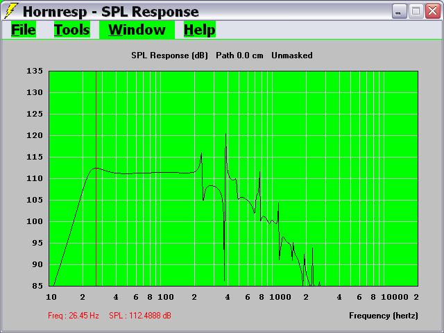

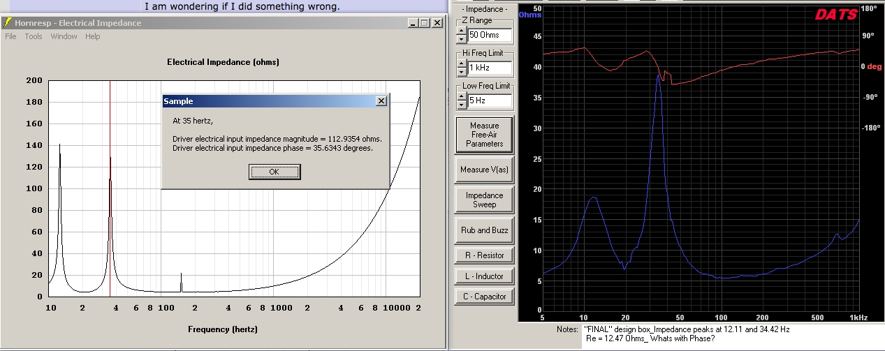

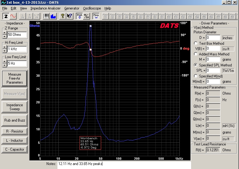

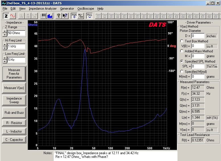

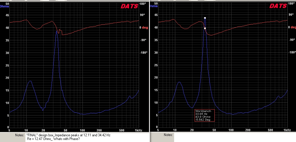

I was trying to do some impedance sweeps but I am getting some confusing results.
The Impedance peaks come out pretty close to what HRSP predicts, and there is a small difference between the two versions of the box.
However the difference is small with the first box (with the shorter vent) coming out at a peak of 33.65 Hz and the box that closely resembles the “final” design peaking at 34.42 Hz.
The result that confuses me the most is, if I do a “measure T/S parameters” with DATS it tells me that the Re of the driver is 12.6 ohms.
I just bought Virtins virtual instrument package and plan on testing for THD as soon as the rain stops. I would have done it Sunday morning but between the neighbors coming over (they live 1//2 a mile away) but I guess 8:00 AM on Sunday is a little early, and the rain that started a few hours later I had to call it a day.

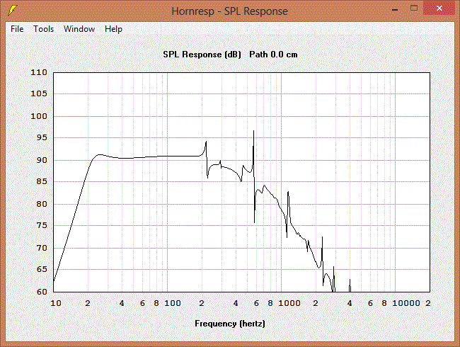

A quick question, Does anyone ever use a Zoebel network on a sub?
I expected to see more difference between the simplified version that I built at first and the “real” design but maybe the phase information tells most of the story where the simple design has it’s 1st phase wrap at 43.5 Hz and in the 2nd box I built, this happens down lower at 32 Hz or so.
If I place both cabinets next to each other and set the limiter at 29 Volts in my concrete house these can definitely be used in anger.

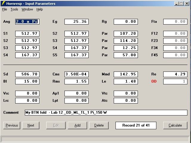

All Hornresponse screens are from the input that shows the actual values for the 2nd box I built.
I expected to see a flatter response with the outdoors tests.
I am wondering if I did something wrong.
I used the USB pre directly into the amp and the amp had a 20 Hz, 24 dB/Octave filter, but no low pass filter setting at all.
Is this type of falling response normal for outdoor testing?
Dave
PS. DrDyna, the cutlist I included in my last post is for the 2nd box in post 85 and this box is almost exactly the design called "FINAL" by Bjorno and NWGrad.
The only difference is the line is 1.8 cm longer and the driver is 8 mm lower.
I did this because HRSP seemed to like it.
One thing I will say to NWGrad, I am using a Crown xti 1002 because I liked the DSP option when I looked up the amps specs after you said you were going to drive your OD_ML_TL’s with one. You also said you might use a 12 dB/Octave BW HP filter.
I was testing with it set to 24 dB/Octave and 29.14 Volts limit (~ 200 W) with a starting frequency of 20 Hz, but then I did a sweep with the HP filter set to 12 dB/Octave and the amp immediately shut down with whatever protection scheme it has. This should have been less than 200 Watts rms as the measured impedance is always higher than the 4.29 ohms used in the HRSP simulation, usually quite a bit higher. I am unsure about what type of protection circuitry the amp has but it came right back on in 10 seconds or so when there was no longer an input signal.
Dave

1st Inroom and both outside_Red -8 dBFS_blue - 10 dBFS.jpg113.3 KB · Views: 230

Crazed and Confused
No EQ.
I was driving the amp with the output of the USB pre.
All sweeps posted since Jan. of this year are with a 20 Hz BW, 24 dB/octave HP filter and no low pass filter.
It is unsmoothed, or 1/48th octave which is what REW calls unsmoothed.
My house has an inroom hole at about 34 Hz and I found that moving the speaker around the room while maintaining the 1 M mic distance would change this hole.
I attached an example of 2 sweeps, one showing the hole prominently and the other with the hole somewhat reduced.
Also, I am rather sure of the SPL calibration on these sweeps.
I did the cal using an EBAY new (NOS) "Shack" SPL meter.
I think I may have hurt the USB port that I am using for DATS as I have seen several anomalous results from DATS lately, including the in box Re of over 12 ohms. Both Lab12 sub boxes read this way.
The thing that I am worried about is the falling low end in the outdoor response.
I thought it should look closer to the output of HRSP SPL chart.
Am I correct in thinking that the outdoor SPL sweeps should be allot flatter?
I attached 2 sweeps made indoors (in my concrete house) done in Jan where I moved the cabinet around the room. One shows the prominent hole at 34 Hz, the other shows a different looking "hole response".
It is definitely a room mode.
Also
I do not think it is the box construction, 18 mm 13 ply BB glued with Urethane glue, clamped and screwed together using #6 square drive screws and stuffed with long hair wool (this time to Bjorno's specs).
I even pulled out some stuffing and the Speakon connector to use larger wire (was 16, went to 12 gauge appliance wire) when I saw the 12.4 ohms on the first box but this changed nothing.
I expected the Impedance curve to look similar to the HRSP chart with maybe the magnitude of the impedance off a little and the frequency of the peaks to be close to the HRSP prediction.
I am really stumped by the lower peak being so much lower in magnitude, so much wider and the general waviness of the trace.
I don't seem to have them with me but the bare Lab12 driver makes a single peaked impedance plot that looks just like what I would see on a spec sheet.
I need to do some more testing and figure out what is going on.
The only thing I can say is they, both, sound impressive
Dave
Time for more testing
PS..I assume that testing the impedance through a 4 pole Speakon connector, both sides using 12 gauge wire, and only about 12 ft. of it is OK..??

I agree that something is wrong.Brian Steel says: Something is way off with those impedance measurements. There's no reason why they should look so ragged, unless the box is very poorly built and full of resonance modes, which I doubt.

It should be fine. A few times I've gotten similar crazy graphs from my WT3/DATS system and the only resolution was a PC restart and ensuring that I use the same USB port every time for measurements.
BTW, In my (albeit limited) experience, a lower impedance peak that's much lower and flatter than expected can be caused by too much damping material in the box. If the center frequency is shifted upwards, it could also be caused by a leak near the driver.

The in box Re of over 12 ohms would make sense as an average that includes the 18 and 38 ohm peaks and the 5.2 dip.

I used a new USB port and also noticed that I had the input level set at 0% instead of 1% as per the DATS instructions (not sure what that all means, 1% ?)
Anyway, it now makes a much cleaner looking impedance measurement.
Dave,I used a new USB port and also noticed that I had the input level set at 0% instead of 1% as per the DATS instructions (not sure what that all means, 1% ?)
Looks about 1% "cleaner" to me .
Looked OK before, and virtually identical, other than the 33.65 Hz peak being about 10% higher in the 1% test.
