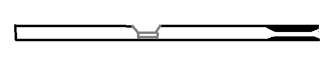

I've sorta asked this before about the single fold design, but just to make sure, would there be any issues with building it like this? Or with the driver inverted?
(pardon the crudeness of my mspaint skills.)
Edit: I guess what I'm asking is, before I get creative, is there any style of folding or not folding that will affect the performance in any appreciable way?

I always thought the original design was nothing more than a BR with a flare ended port. A T-TQWP or T-TQWT is a negative flare TH. A TQWT or TQWP is a straight flare TH.
I rather agree, however (and I'm still learning about horns) I think the way the driver is positioned along with the thin-long design plays a role in tuning resonances, along with the way the upper end of the line should be stuffed, as I understood, lightly and increasing to heavy toward the far end.
If I build a proper pair of these once I can come up with a wacky design that I like, I'm not opposed to knocking the "internal artwork" out of this test cabinet I have now and measuring the difference.
I just need to come up with something artistic that doesn't compromise the performance before I start cutting BB.

I think the long box will sound different. It reminds me of a truck box verses a trunk box. Truck boxes don't sound deep to me due to the lack of depth behind the speaker. HR shows depth affects group delay, phase response, and diaphragm displacement regarding a Kicker 08S15L74 in 2.5ft3 sealed enclosures with 8" (truck box) and 16" (trunk box) depths.
Have you drilled the holes? How many of the inner partions can you reach from the driver mounting hole?
