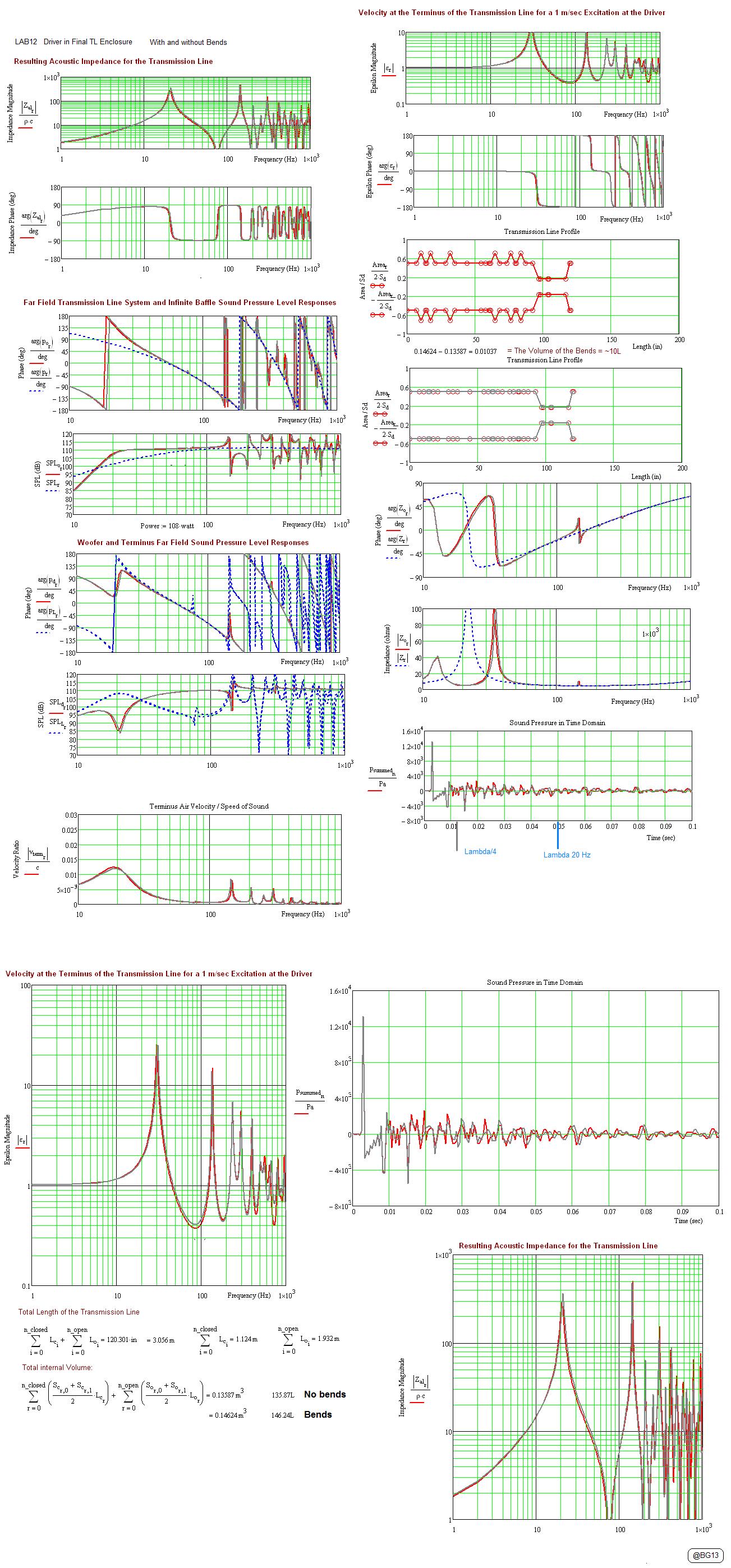

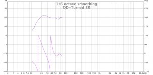

To answer the question of why I prefer the performance of an (OD) ML-TL versus a normal Ported BR is due to the port issues that always appear for a Driver with relative high xmax tuned low:
Over stuffing the Box and by adding Port stuffing are the only other measures that can be taken in order to keep the Port system reasonably small.
Take a serious look( zoom all the graphs) at the submitted pictures and you will find out why...
Note: The shown BR has a port diameter equal to the ML-TL.
The impact of folds in a quarter-wave enclosure are masked when stuffing is used thus can be ignored when simulating.

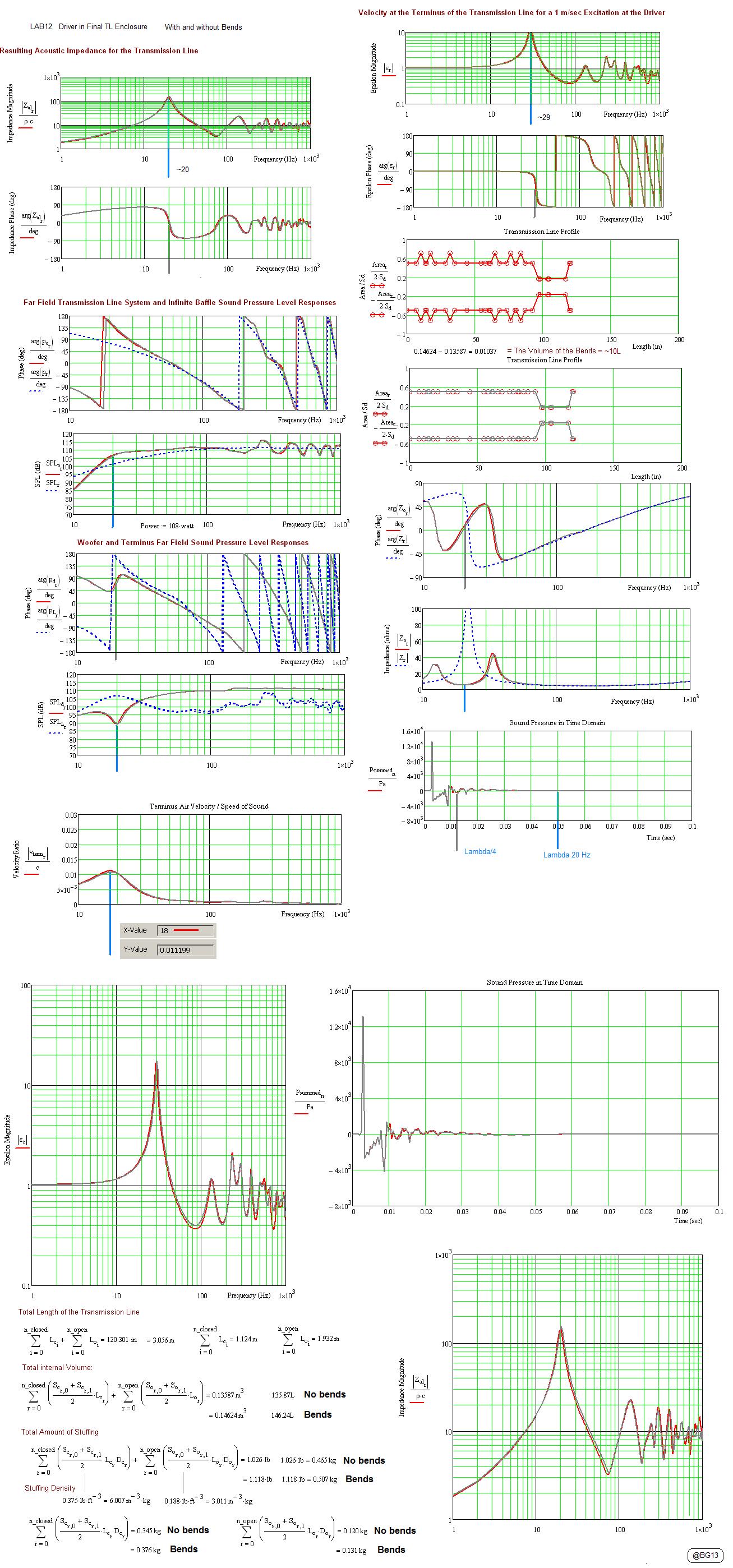

b![]()
Does the BR have the exact same flare at each end of the port as the ODMLTL?

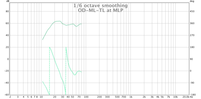

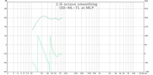

I'm sure making sure stuffing is correct, as well as performance at higher levels should be considerations, nevertheless, here's the result of my little experiment.
All I did was rip out the piece directly behind the driver, which I figure was enough to turn it into a fairly well braced BR enclosure.
Not sure if this answers any questions or even creates more.
*shrug*
*shrug*
To answer the question of why I prefer the performance of an (OD) ML-TL versus a normal Ported BR is due to the port issues ...........
Right, IME anytime a < 0.5 [~17 m/s] vent mach requires a long vent, it's better overall to take the cab and vent volume [net Vb] and morph it into an inverse tapered TL.
*shrug*
Looks like the BR has a better frequency response and is an easier build than the ODMLTL. I say go TTQWT! 7 boards minimum for a single fold.
