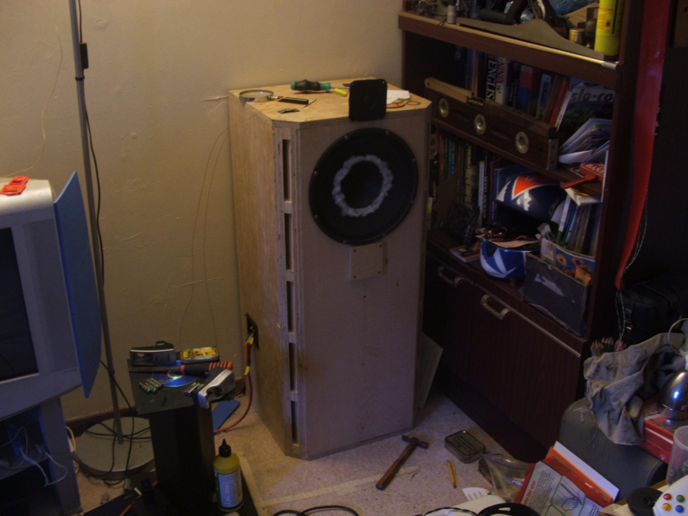

Here's a pic, only of the one because my flat has turned into a total 'man cave' since my gf and I moved in to 'our abode'.
There is a phase plug in there, unfortunately the borrowed cams battery decided to die when the flash was turned on and the plug has a dark enough red tone to become invisible under room lighting.
They still remain slightly un-finished as I am slooooowly working on low Fq reinforcement ideas.......
LAB12 in an EmKen shaped / size box, BR ported
LAB12 type horns (stock 3 fold or 2 fold special)
15" or 18" in big (huge!) sealed boxes
The 12lta takes A LOT of running in, free air them for a bit, put them in the cabinets and then find a place where you can give them a damn good thrashing. I say this because after the times mine have been beaten a bit, they sound a bit better.
