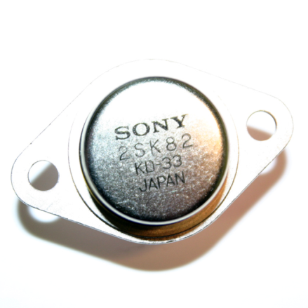

I bought a quartet of them online, and when they arrived wasted no time plugging them into a circuit to see what would happen.
Curves Ahead

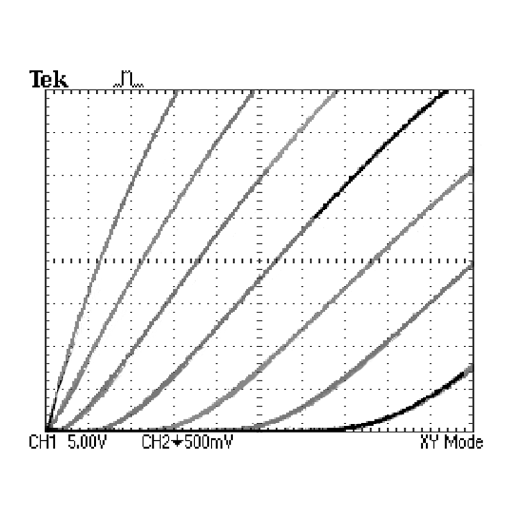

I wasn’t able to find the official manufacturer’s datasheet for these parts and the data that’s out there is sketchy, but that’s all part of the adventure. When I first wired-up the 2SK82 it worked, but it wasn’t behaving like the characteristic curves from the internet*. Lacking a fancy curve tracer, I tried fiddling with the drain and gate voltage supplies to capture some data points, but this proved to be a little clunky and inaccurate as things tended to drift, so I built up the apparatus in Figure 1. If you have an oscilloscope with X-Y capability, you can use this setup to capture some current vs. voltage (IV) curves for yourself. This can also be handy for times when you’d like to look at a particular sample, or zoom in on a certain part of the graph.

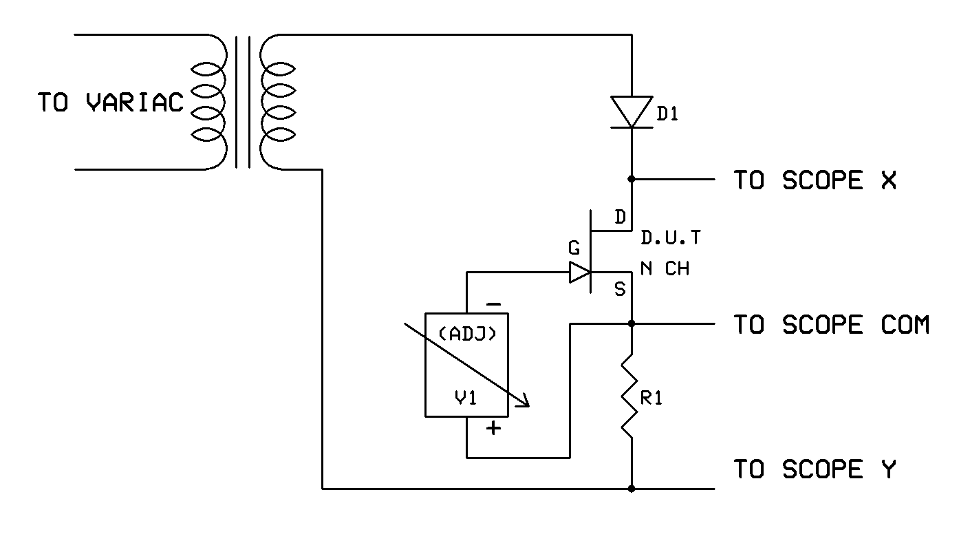

I used a toroid transformer with two 18 volt secondaries in series to supply the AC voltage and provide isolation (If you build Pass amps you have lots of these on hand). An 8 amp rectifier supplies a half-wave rectified voltage to the device under test, and a 1 ohm resistor provides a place for us to monitor the current, in this case 1 volt = 1 amp. A bigger resistor would provide some current limiting so we don’t accidentally destroy our device, but that would eat up voltage we need across the device for our curves, so you have to be careful, and it helps to know a little about the behavior of your device beforehand. The whole thing is connected to a Variac, so you can bring the voltage up slowly and adjust it as needed. Remember, we’re not testing little devices; we’re working with bigger voltages and currents, so safety first. Don’t touch the apparatus while it’s powered up and shield yourself from the device under test. I wear safety glasses and keep a fire extinguisher right next to my workbench just in case.
For the 2SK82, the bias supply is negative, and for enhancement mode devices you would reverse this. Also, if you intend to test a P channel device, you’ll need to flip the diode polarity in order to provide the negative half of the wave to your device. You can test other devices as well, even light bulbs. Mounted to a proper heat sink, I connected the 2SK82 to the makeshift curve tracer, dialed-up -12V, and adjusted the supply. Then I repeated this for the remaining Vgs values (-10, -8, -6, -4, -2, 0). I took a screen shot of each trace and composited them together to get Figure 2.
A number of inexpensive USB scopes would do fine here, and many of them allow you to export the waveform data right into Microsoft Excel. I’ll also point out that real curve tracers use a staircase generator on the bias to get all of the curves on the screen at once, and you could do the same using an arbitrary waveform generator. I just do it the cheap and simple way.

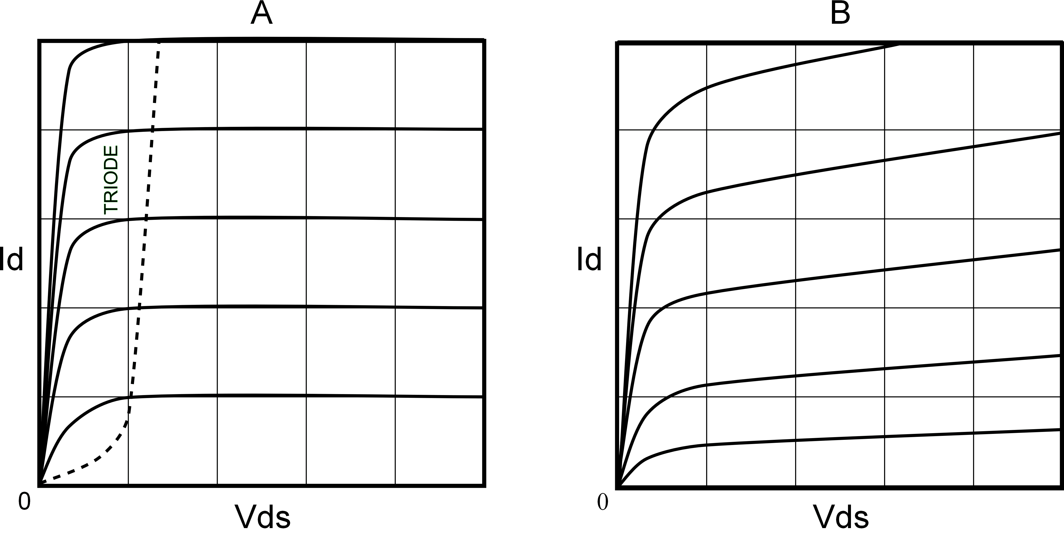

Figure 3(a) is a set of curves for an imaginary MOSFET transistor. Starting at 0 volts from Drain to Source we see that the current (Id) rises sharply for the first few volts in what is called the triode region, then levels off in the so-called saturation region. This sort of curve is very similar to a Pentode vacuum tube. We notice that the lines in the saturation region are nice and evenly spaced. The spacing here represents the gain. If we want lots of gain, we’d like to see a big change in Id for a small change in Vgs. Change in Id over the change in Vgs is called Transconductance (∆I / ∆V). Variations in gain will cause distortion, and this would be a low distortion device indeed, since the gain is perfectly uniform throughout. We could select an operating voltage and current (Operating Point) just about anywhere and get a good low-distortion result.
However, we’re more likely to encounter something like Figure 3(b). Here, the spacing between lines isn’t even and we see that they tilt upwards and diverge in the saturation region. In a case like this, you might move your operating point closer to the top of the graph where the spacing is wider and more even (Higher gain, less distortion). If you’ve built the MOSFET Zen amps, it’s possible you’ve developed a penchant for turning up the current; this is because the MOSFETs we use look something like this.

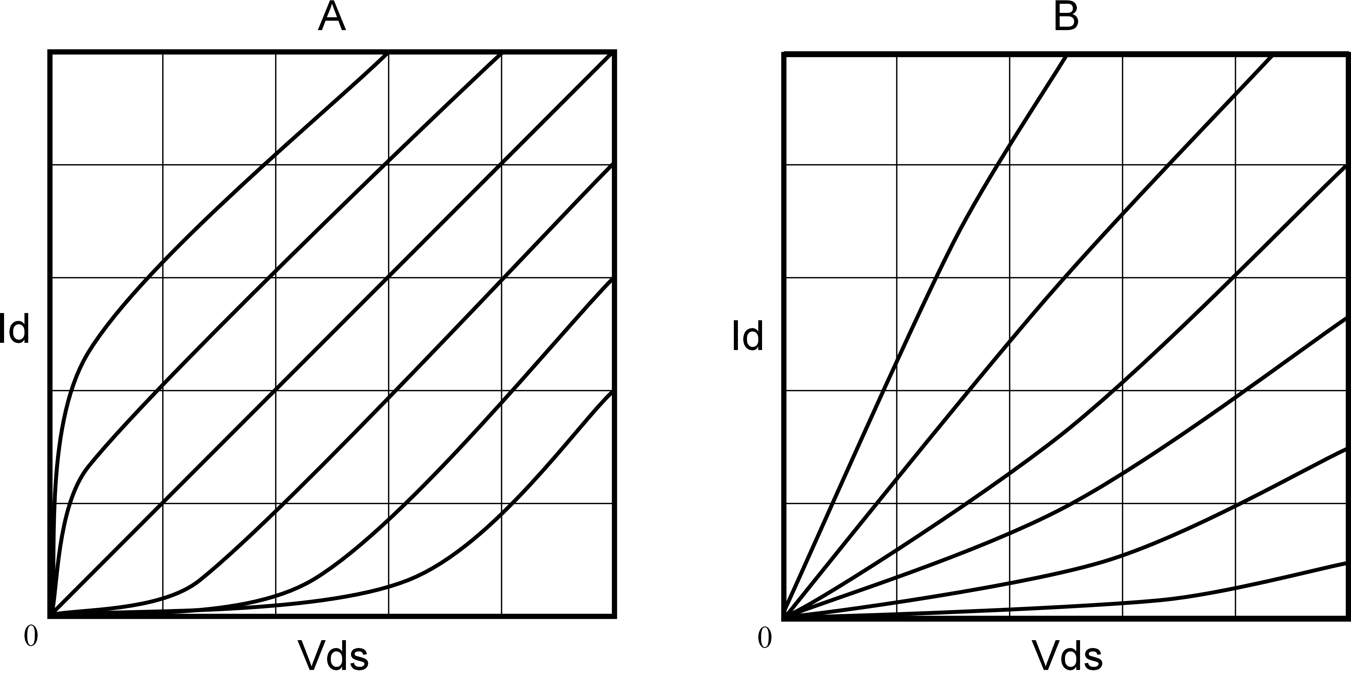

Now let’s turn to Figure 4(a). Again, the horizontal axis is the voltage across our imaginary device, the vertical axis is the current flowing through it, and each line represents a different Gate to Source voltage. These curves clearly look different. We see that Id rises with Vds throughout the graph much like the triode region of the MOSFET, so Id is dependent on Vgs and Vds. In this ideal example, the gain is nicely uniform, so selecting a low-distortion operating point would not be difficult. However, we’re more likely to see something like Figure 4(b). In this graph the lines aren’t evenly spaced or parallel. As before, we’ll want to select our operating point accordingly, but as you will see in a moment, there is a twist. If you’re thinking this graph looks a bit like the 2SK82 curves we made earlier, you’re right; this is what Static Induction Transistors look like, and they closely resemble Triode vacuum tubes.

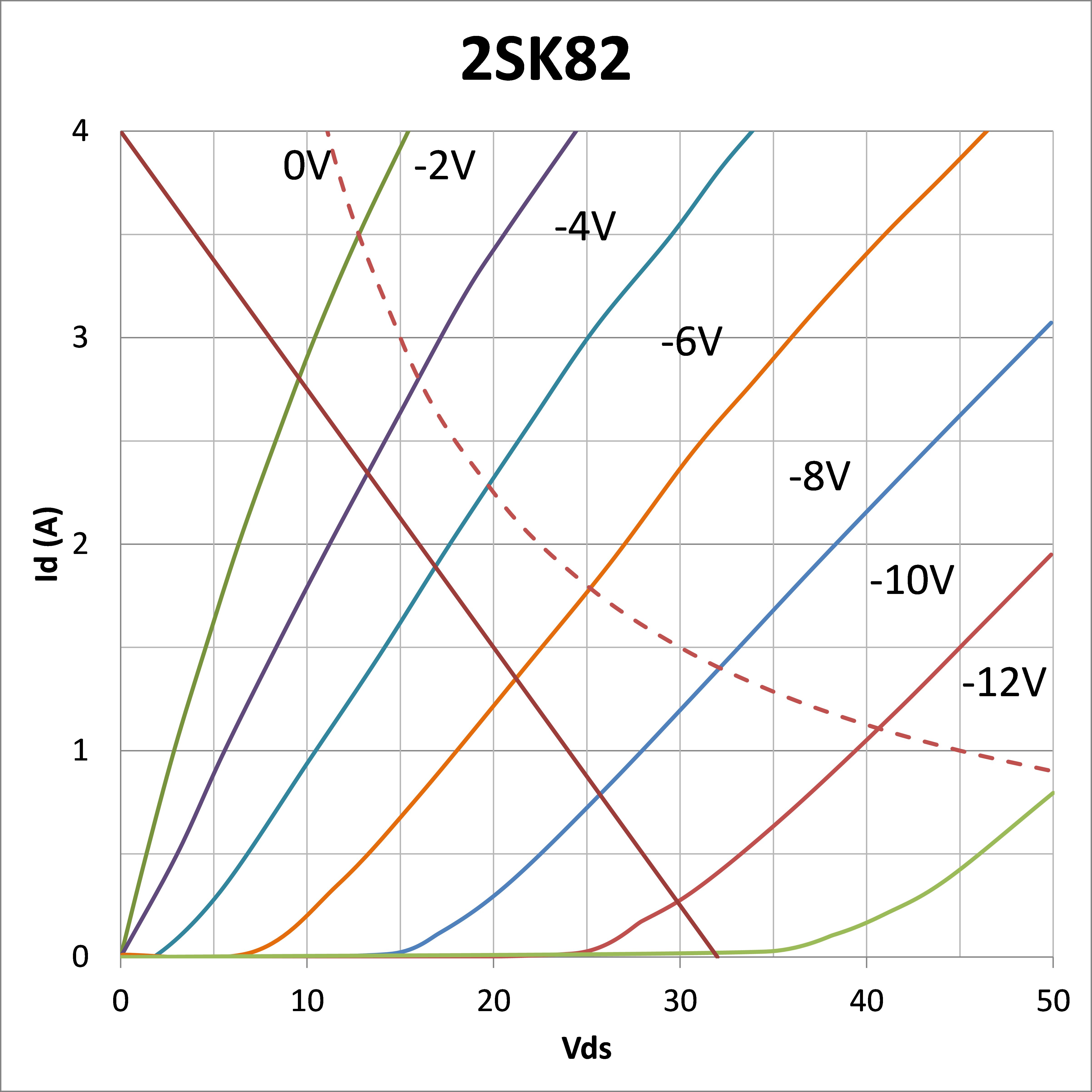

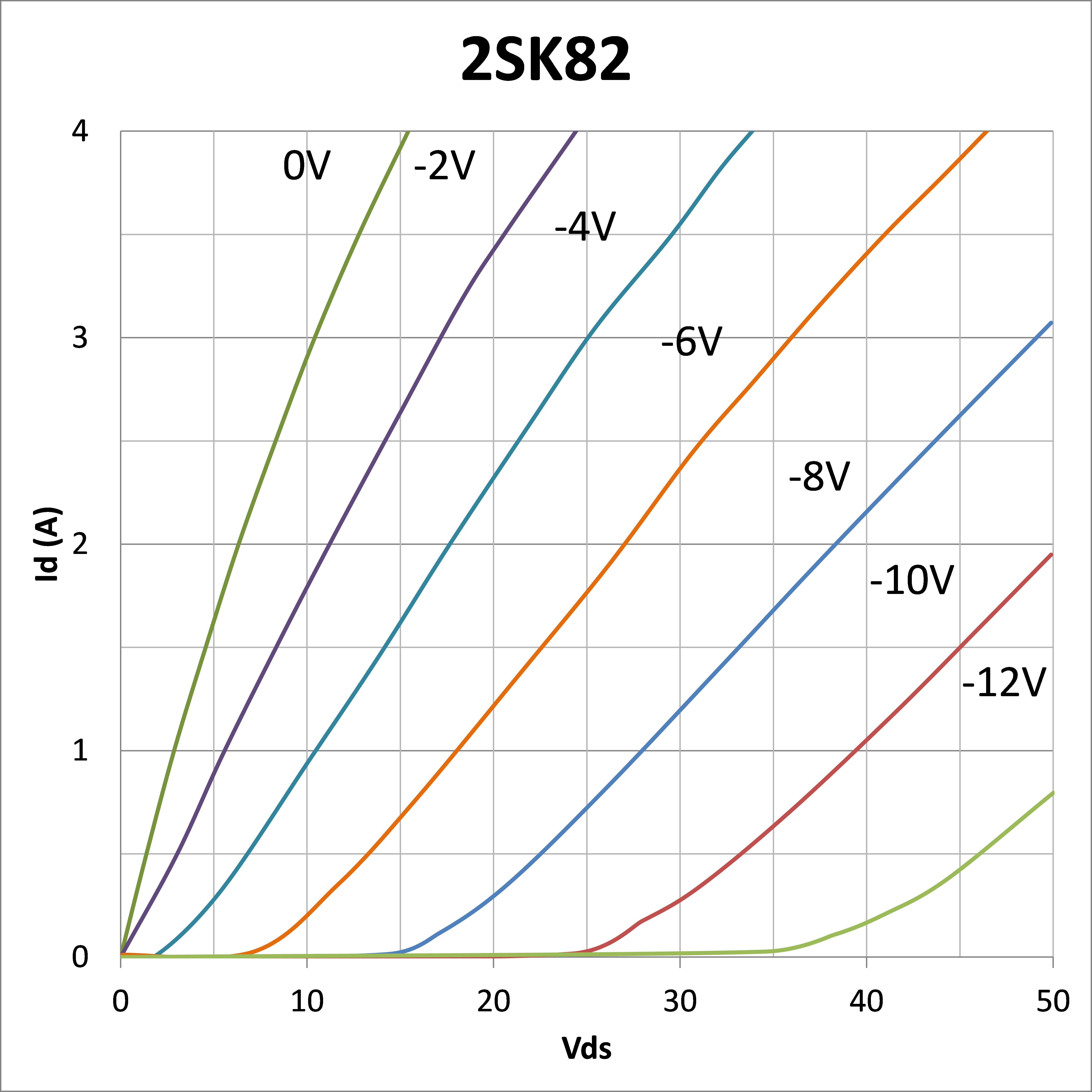

Now, let’s return to our real curves for the 2SK82 (Figure 5). Our Vgs values in this graph are negative because the 2SK82 is an N channel depletion mode device, and we’ll need to interpolate (by calibrated eyeball is fine) for values of Vgs not drawn.
One thing that catches our attention is that the 2SK82 will conduct when the Gate and Source are at the same voltage, which would be nice for self-biasing. However, Id increases very sharply here so we need to keep an eye on our dissipation as we increase Vds. The 2SK82 is rated for 95 watts and, ideally, we might want to see a 4:1 safety margin to ensure our parts will last and perform well in the hands of regular consumers. But this is DIY; we have soldering irons and we know how to use them so, we’ll push it to 45 watts or so. It will be helpful to see this maximum power on the graph, so for each value of Vgs, let’s draw a point where the dissipation equals 45 watts and connect them with a curve as in Figure 6. When we choose our operating point we’ll want to stay below this dashed line.
Now, what about all of this load line and sweet spot business? First let’s talk about what a load line is. Let’s draw a line from 32 volts (Vds) to 4 amps (Id) as in Figure 7.
There you go; that’s a load line. In this case, it represents an 8 ohm load (32 volts divided by 4 amps). Not so bad, right? Of course, there are an infinite number of 8 ohm load lines we could draw, but they will all be parallel, having the same slope. And, the load may be something other than eight ohms; it might be the impedance of a transformer primary, the impedance of light bulbs in parallel with your speaker, or something else altogether.
Now, let’s choose an arbitrary operating point along our 8 Ohm load line and place a dot there as in Figure 8.
Here I’ve chosen 16 volts, 2 amps. Now imagine rotating our load line around the operating point.You may want to print this graph and try it with a straightedge. If we twist the line clockwise, the slope gets steeper, so the load decreases. Conversely, when we twist the line counterclockwise, the slope gets shallower, so the load increases. As we twist our load line back and forth, watch the spacing between curves along the straightedge; the spacing changes, and when they’re the most evenly spaced, we’ve found the point of minimum distortion for this particular operating point. Keep twisting until the light bulb above your head comes on. Eureka! You’ve got it.
Well, almost. Changing the slope of the load line is only one of the variables and sometimes you have little or no control over the load value. In that case, we can move the operating point to find the sweet spot. Here, the load line (or our straightedge) stays at the same angle as we work around the area of interest. Of course, we have to choose an operating point that provides adequate voltage swing, and the sweet spot isn’t necessarily the point of lowest distortion; maybe you’re after a special blend of odd and even harmonics, or maybe you have other design constraints you need to achieve. In any case, the sweet spot is there for the finding.
Hopefully, this little thought experiment has helped you to understand what happens when we vary certain parameters in search of the sweet spot. I’d like to point out however, that finding the sweet spot on paper is really only useful as a rough starting point. In real life, speakers aren’t resistors (the speaker's actual load line is elliptical), and gain devices never look exactly like the datasheet. For that matter, they seldom look like one another, and if you’ve ever matched MOSFETs for Vgs, you already understand this to be true.

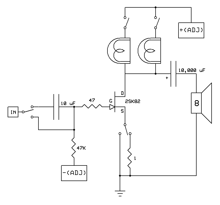

Figure 9 is my “throw science at the wall and see what sticks” test setup. It has adjustable power supplies for the bias and V+, and selector switches (alligator clips, actually) for the various components, which allowed me to try a few different configurations quickly and without a lot of fuss. You’ll recognize this as your basic, common source amplifier similar to Zen-Lite, De-Lite, et al. The beauty of Nelson’s light bulb amplifier projects is that they’re easy to build and learn from, while being fun to listen to and watch in the dark.

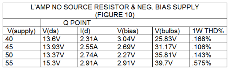

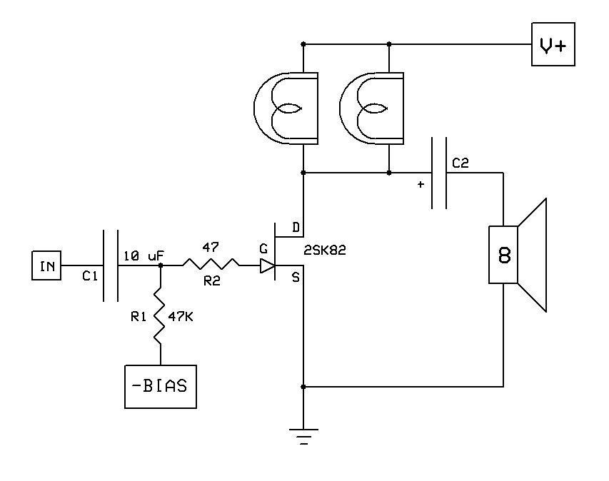

The first configuration I tried is seen if Figure 10. There’s a cap on the input and no source resistor. The input impedance is the value of R1, and the output impedance is approximately equal to the total resistance of the light bulbs. I used two 300 Watt light bulbs whose parallel resistance is in the 11-13 Ohm range. Make sure the bulbs you buy are 300W @120V. The first bulbs I tried were marked 300W@130V, so they’re really 266W bulbs. You’re looking for 11-13 Ohms, so if you have a cache of the 130v bulbs, which are about 39 ohms each, you should be able to use three of them in parallel. Of course a big power resistor works fine too.
In trying to keep to a logical workflow, I moved the operating point around the area of interest by stepping through several power supply values, and for each one I adjusted the bias for lowest distortion at 1 watt. I also checked the voltages across the JFETs and the bulbs.
If you plan to try this for yourself, you’ll need a distortion meter of some sort. There are many used distortion analyzers available that will get you down to .01% or so. You could also try one of the soundcard + software solutions, and I’m sure you will find a discussion about them somewhere in the Pass Labs forums. I use an HP8903, which isn’t hard to come by, and measures down to .003%.
Here are some of my findings:
You can see from the data that the resistance of the bulbs changes a little with the voltage across them, so the load line moves slightly as you adjust the supply. This wasn’t a big problem, but noteworthy in the context of our discussion about load lines. The measurements were different from my intuition, which told me the middle of the graph had potential, but I tried one, two, and three light bulbs and the results weren’t very interesting. Perhaps that area could be exploited with some other load. The gain of this circuit is the effective load divided by the inverse transconductance of the JFET. Returning to our characteristic curve, we see that the transconductance in the operating area is around .4A per input volt, or .4 Siemens. The effective load is our light bulb resistance in parallel with our 8 Ohm speaker, or about 5 Ohms.
5 / (1 / .4) = 2, or 6 dB
That’s not a lot of gain, but the distortion performance is looking pretty nice and this is a flea-watt amplifier anyway, so we press on. You could build this one using a suitable negative supply for the bias, but maybe you don’t have the equipment for dialing in the sweet spot, and you just want something you can build and listen to without a lot of knob-twisting. Figure 11 doesn't require any adjustment, or a separate bias supply and it’ll get you pretty close.

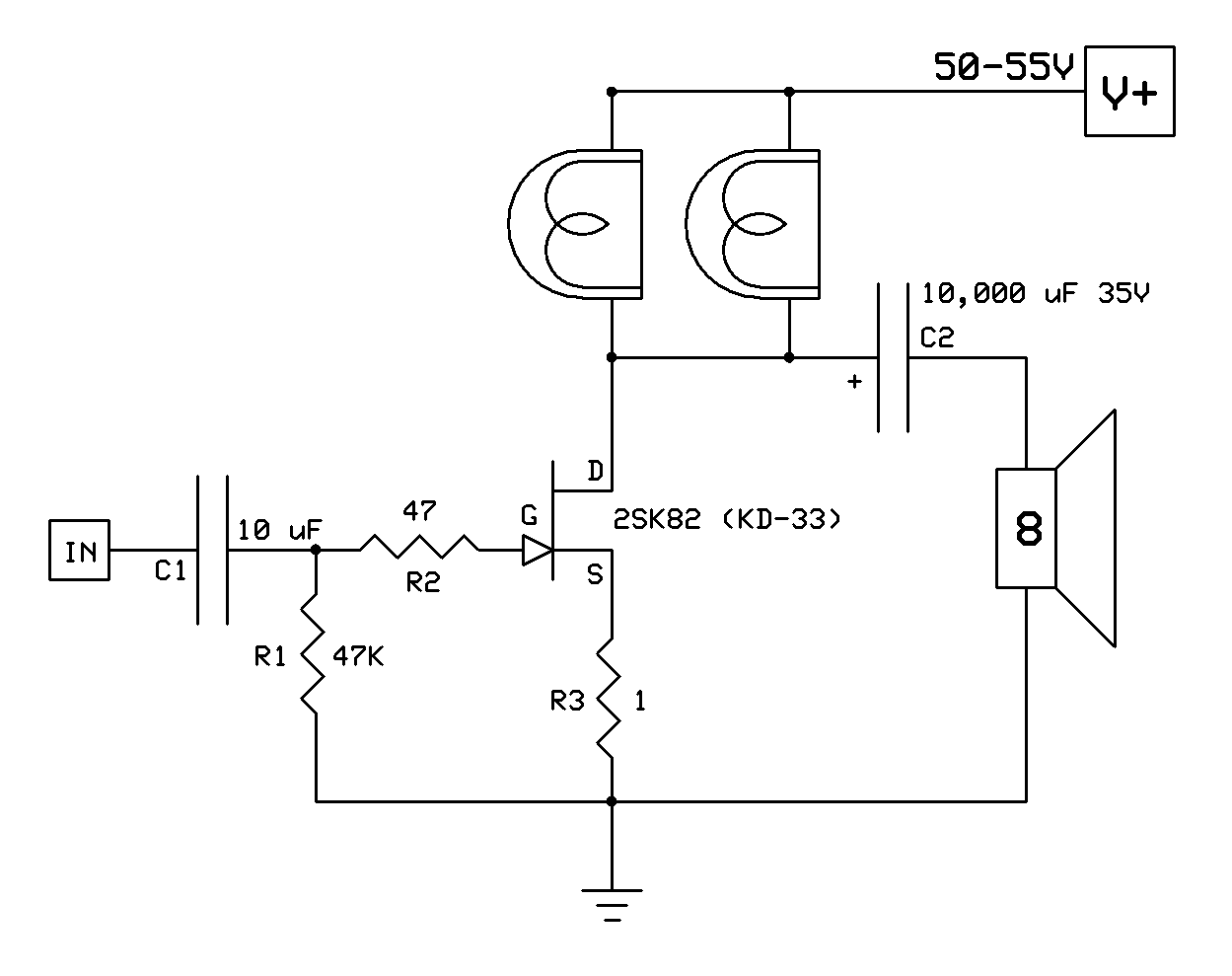

It has a 1 Ohm source resistor, which lowers the gain (and distortion) even further. Here, the gain is the effective load divided by the inverse transconductance of the JFET plus the 1 ohm resistor.
5 / ((1 / .4) + 1) = 1.4, or 3dB
R1 is attached to ground and the JFET is said to be self-biased because the Gate is kept at 0V and the Source is raised by the voltage dropped across R1, so the voltage from Gate to Source becomes –VR1. If you build this one, you’ll want to use SITs graded KD-33, which Acronman sells in N Channel singles. Having captured a few interesting data points at the bench, I assembled a pair of plywood prototypes. Then I lugged the prototypes, three regulated power supplies, a bunch of clip leads, and my notebook two flights upstairs to my listening room to see if they liked music. You can build your amps this way too, and if you plan on experimenting a lot, it will afford you a lot of flexibility. Look for the nice dual linear regulated supplies rated at the voltages and currents you see in the various Pass projects. Here’s an action shot of the prototypes:

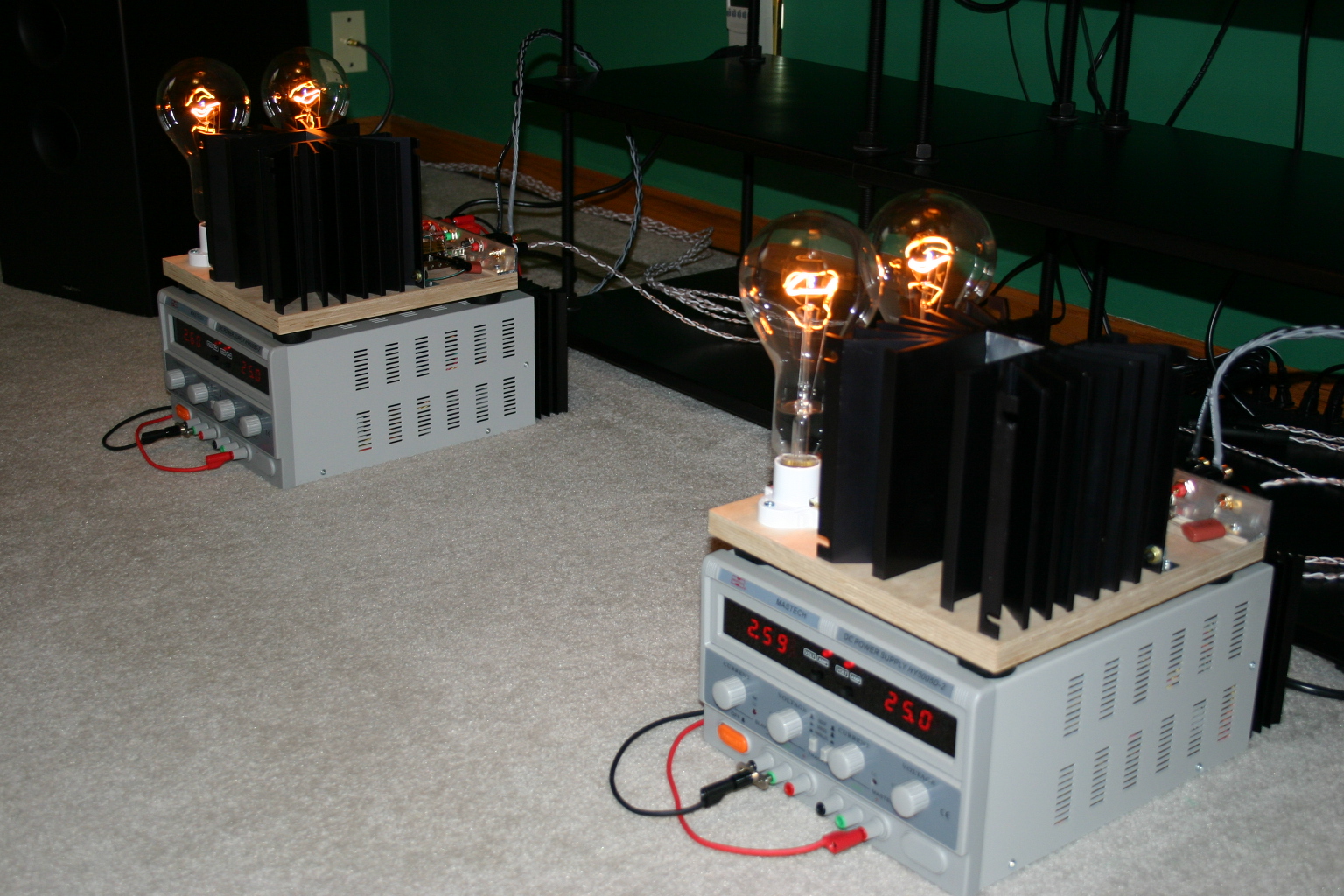

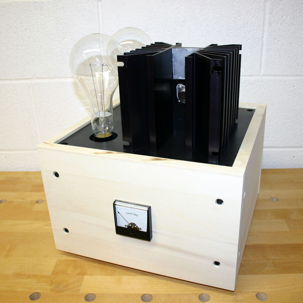

Having listened to the plywood prototypes for a while, and needing my regulated power supplies back in the lab, I built the more portable and domestically acceptable version you see here. They’re monoblocks.

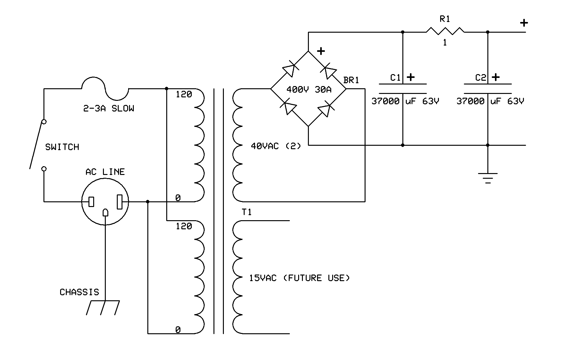

Figure 12 is the power supply schematic for one channel, and there’s nothing unusual here. I used 400VA transformers from Antek, which have two 40V secondaries, which are wired in parallel. The Anteks also have two 15V secondaries, convenient for adding a little regulated supply for the bias if you decide you’d like to try that later.
I wired everything point-to-point using solder lug terminal strips, keeping my wiring as short and neat as I could. I know the thought of wiring point-to-point makes some do-it-yourselfers tremble, but a PCB would just be silly here. The SITs dissipate around 45 Watts, and I attached them to big heat sinks from Wakefield, drilled for TO-3 transistors. Their thermal resistance is around .5C/W. I used sockets and thermal pads on the transistors, but mica and goop would probably be better. Here’s a pinout diagram for the 2SK82.
I attached R3 to a small heat sink, but you could attach it to the same heat sink as the JFET. I included a few niceties like two input jacks; one is direct coupled and the other has a cap. Then there’s the Sweet Spot Meter, which is mostly a gimmick, but fun. Here’s what it looks like close up.

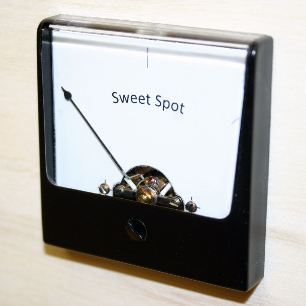

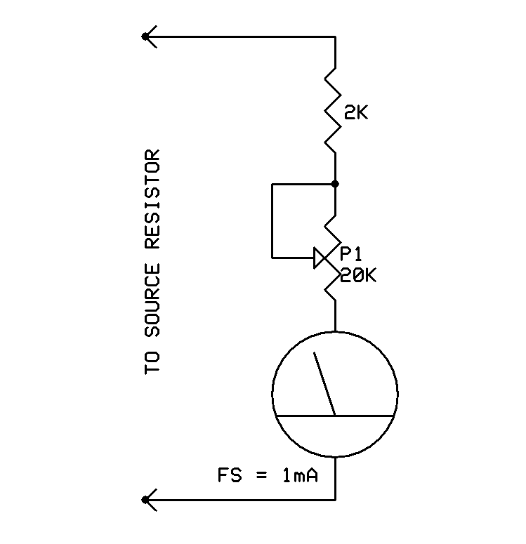

The idea is to adjust P1 so that the meter goes to half full-scale (the sweet spot mark). Later, you may decide to try the separate bias supply and/or plug your amps into a Variac to fine-tune them with a distortion meter. After that, you can readjust P1 for the sweet spot, making it easy to return to the same setting later. Finally, I should add that I simply addressed turn-on thump the manual way by installing one of those banana plug shorting bars during power up.

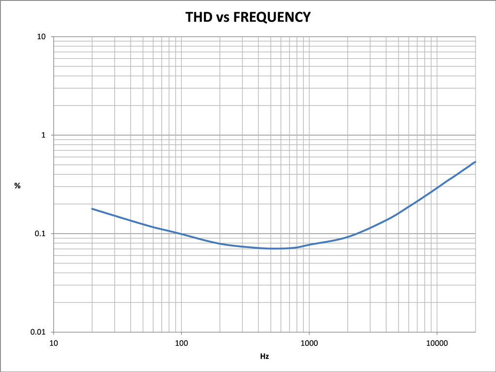

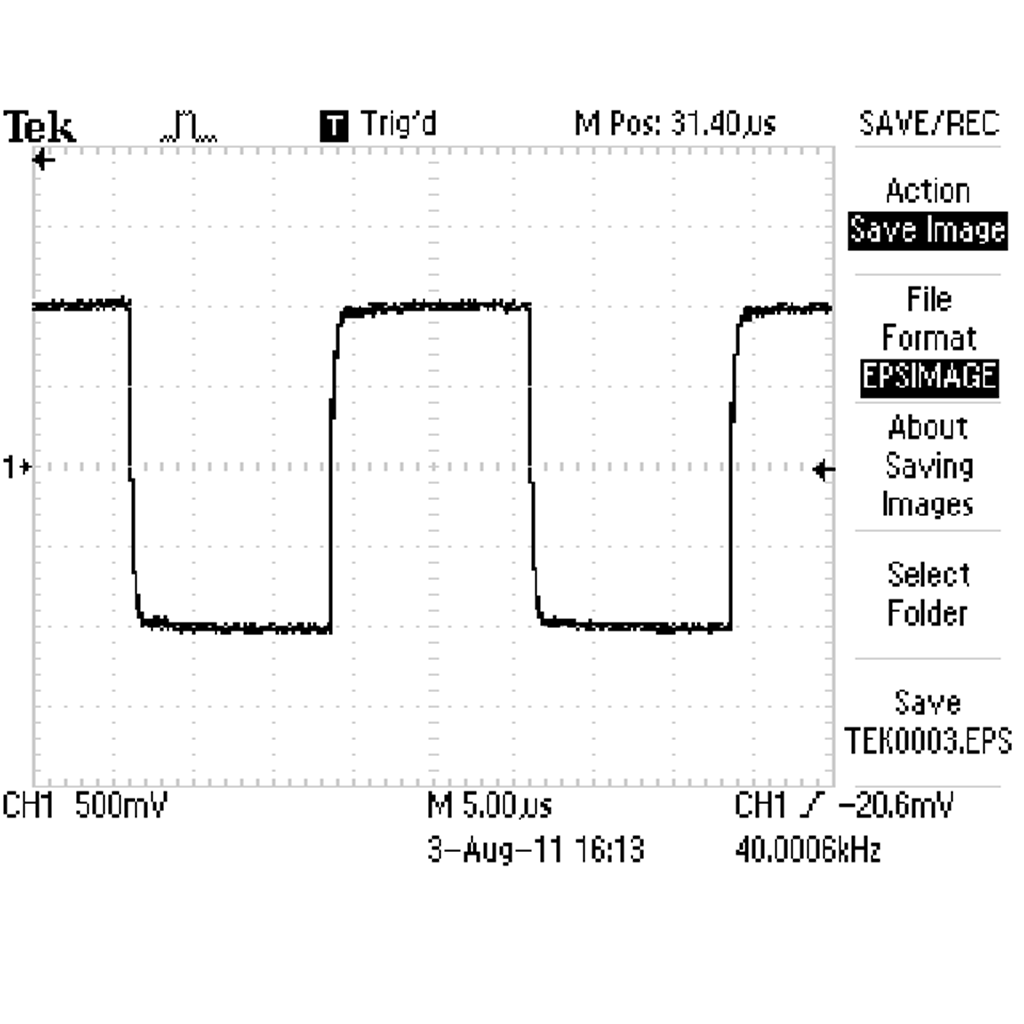

Figure 16 is the distortion vs. frequency at 1 watt.
The frequency response is -.04 dB at 20 Hz, and -1.5 dB at 60 kHz. Figure 17 is our square wave at 40 kHz.
