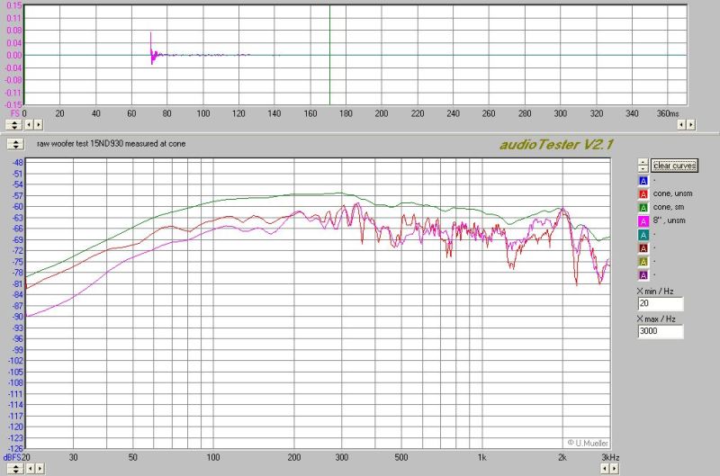

Sooo... I have since gotten around to fire up my new 15ND930 and even to put them in the cabinet. The whole setup is functional, tweaks will come later. I raised the x-o point to 320 Hz (to the 6.5" mid).
Comments on the 15ND930:
- very light
- amazing looks and feel. The build quality... my goodness. Most drivers don't look half as good from the front as this one does from the back. Extremely open basket, the magnet structure is practically a sieve with all that venting. The diaphragm is coated with a sticky compound which is water repellent, this one is not so cute looking (rather like tarmac). Double roll cloth surrounds. Chrome plated spring loaded terminals. I'll do some closeups in studio fashion when I have the time...
- very quiet at LF. In fact I heard air noise and was disappointed. Then I realized I was blocking the rear vent - I had just let it rest on the floor for a first listen and this is a no-no. In the proper cabinet mounting, there is hardly any noise and LF performance is very clean. This in spite of the fact that you can use the vent air motion as a fan at 10 Hz or so and near full excursion... Xmax linear is 6.5 mm and Xmax total is 17 mm, one-way.
- SQ: I tried a 100 Hz crossover and now a 320 Hz , both LR4, to the 6.5" mid. Even with the lower x-o, and more so with the higher one, the midrange has substantially improved in clarity. I attribute this to the lower harmonics contributed by the 15ND930 as compared to the previous woofers (older Vifa 10" car models), and also to the lighter burden of the mid now. I was surprised at this, because even intelligibility, and detail at much higher frequencies than the 15" is used for, has improved substantially (sunjectively at least). I wonder if there might be a residue of higher order distortion added as well contributing to this, but preliminary distortion plots show nothing of the sort.
- Measurements: no real good ones yet. Below is a simple distortion sweep, woofers in shallow U-fram OB, volume set to 100 dB at 200 Hz reference, *at the listening position in-room (ca. 3 m) (!!!)*. Measurement *at cone*, I did not measure the actual dB at the cone, I assume 110-115 dB. Below 50 Hz the figure is embellished by the low Q rolloff, which loses some 12-15 dB from 100 to 20 Hz. Still, a respectable dB output and considering this, quite impressive HD figures. I have to repeat this to check for possible mistakes, around 1% THD at 50-ish Hz at this output level is really remarkable.

Audiotester has quite a range, but I mainly use MLS 12th order, to go easy on ears and tweeters and keep room effects low. Downside is low resolution this way, about 5 Hz, and averaging is a must or I get lost in the forest of peaks and dips. I don't window because I sometimes get artefacts that look real enough to waste time on them before finding out...
Other signals, sine, triangle, sine burst (but not windowed, so I can't use Linkwitz style bursts), Dirac, white and pink noise, dual tone. No MLS LF pre-emphasis though, so again this works against LF S/N ratio, and no custom burst. You can use any signal and look at it in RTA of course, but that doesn't work for bursts. What I like is the slope tool, draw a line on the graph and you see the slope, and the level tool, both implemented very intuitively. Curves can be selected/deselected, and graphs saved as bmp or data as text.
It also has distortion sweeps, RTA, waterfall, and T/S capability.
Overall for 35 Euros shareware license it is good, it does not have some goodies, and has some rough edges that could be optimized in a perfect world, but is uncomplicated for the basics. All other software I tried I found either expensive, or complicated in terms of clicks/measurement needed.

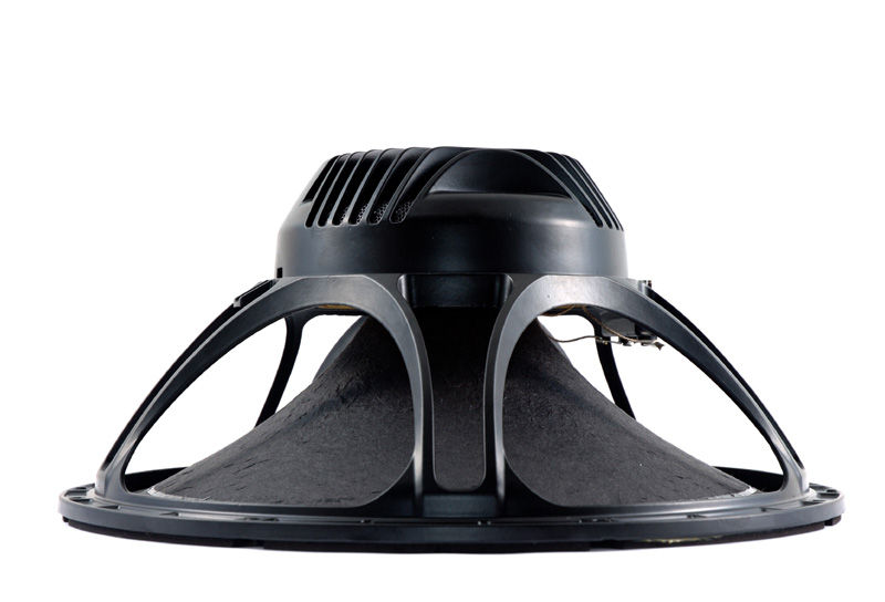

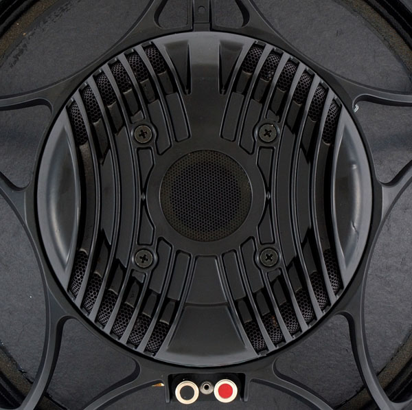

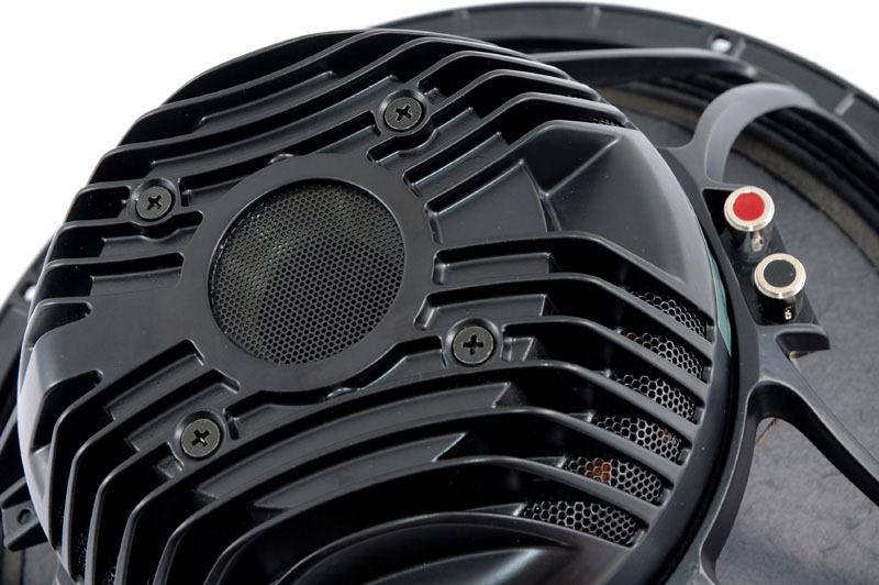

So I finally got around to do some pictures of the 15ND930. The Basket has to be seen to be believed - if they made the basket even more open than it already is, all that's left would be just an engineering abstraction... (translation: I don't think a basket can get any more open than this)
The backplate has so many vents (the spider too of course) that it is literally just a couple of sieves. When playing at rather high SPL's the exhausts really do produce hot air, I was surprised at that because I thought in domestic environments and SPL's this would never happen. Now I know where the power compression in poorly vented systems comes from.
Detail.
