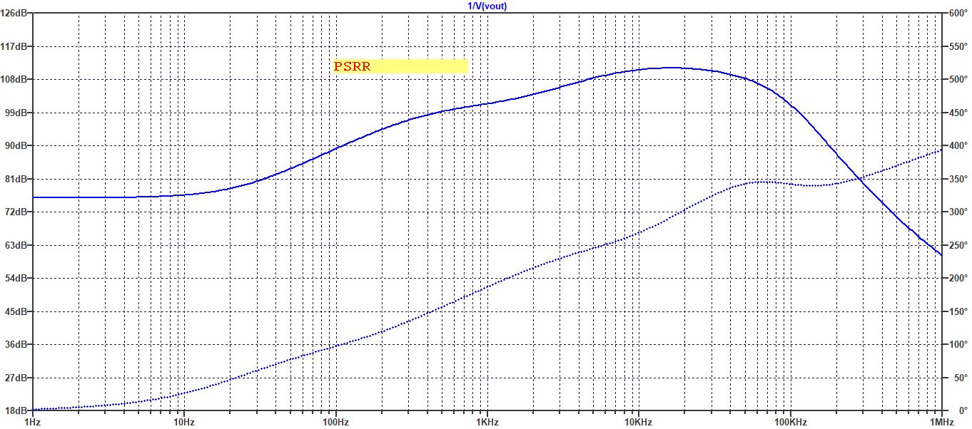

This is simplified version of my lateral mosfet amplifier here: https://www.diyaudio.com/forums/solid-state/243481-200w-mosfet-cfa-amp-118.html#post5297290
I think that to make it more simple would degrade this amp sound. Original amp is quite simple and sounds wonderfully, and I just replaced input stage CCS with resistor. THD increased a bit but not significantly.
Attached schematic, layout, some simulated plots and the gerber files.

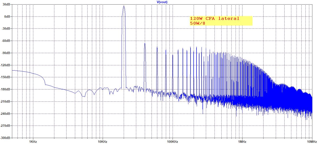

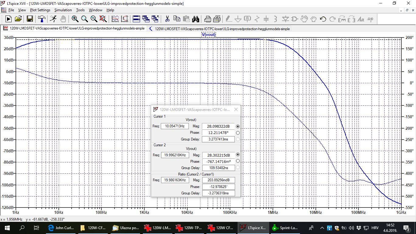

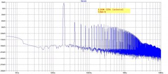

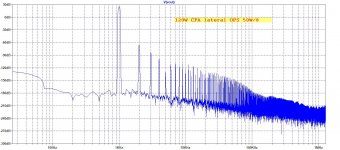

This is FFT at 20kHz, and it shows second harmonic on the same level as FFT for 1kHz at the same output power. This is result of flat Loop Gain up to 20kHz.
Might be to do with bias current not being enough ?
I don't get what you want to say? Bias current was set to 130mA per output pair.
Looks about 80db down to me, or am I missing something ?
Nigel,
I make it 66dB + 28dB = 94dB down for H2.
I have to say that this is exceptional. I normally see around 70dB down at 20Khz for H2. Bravo, Damir!
HD
And what is important too, it follows decreasing harmonic pattern similar to 1kHz FFT.

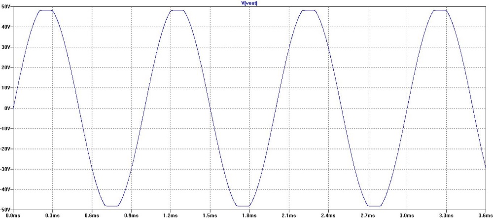

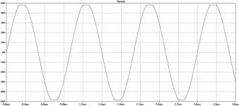

Here is clipping behavior.

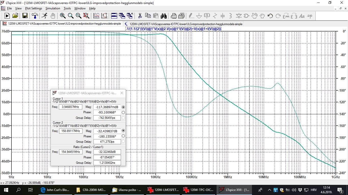

It's interesting how the loop gain is flat up to almost 20kHz (where my best CFA is only up to 1k). I looked at the cct to find out why it is so. I think it is from the extra 1 gain stage i don't have? But surprising to me is, my amp has better thd 1kHz AND 20kHz (at lower power, due to 36v supply), so I'm not quite sure if the 20kHz loop gain plays an important rule here?
Somebody mentioned that he is using compensation to tailor the harmonic spectrum of his amps. So i'm trying to figure out, what is the benefit of this extra complex compensation? Mine is stable with only one cap across Rfb. Your amp is more stable of course, but i predict that it is simply caused by the 47pf connected directly to the output.

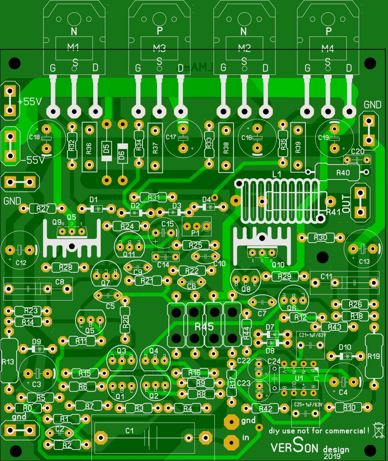

Check your silkscreen, you have Q9 and Q5 at the same location with the actual Q5 marked elsewhere on the board. Again, very cool design, any chance you would provide some gerber files? Thanks
Edit: Totally missed you provided gerbers already - awesome and thanks!

Thanks, it slipped me, but not big error, just that one is Q9.
Yes the gerbers are for anyone to use, just not for commercial.
