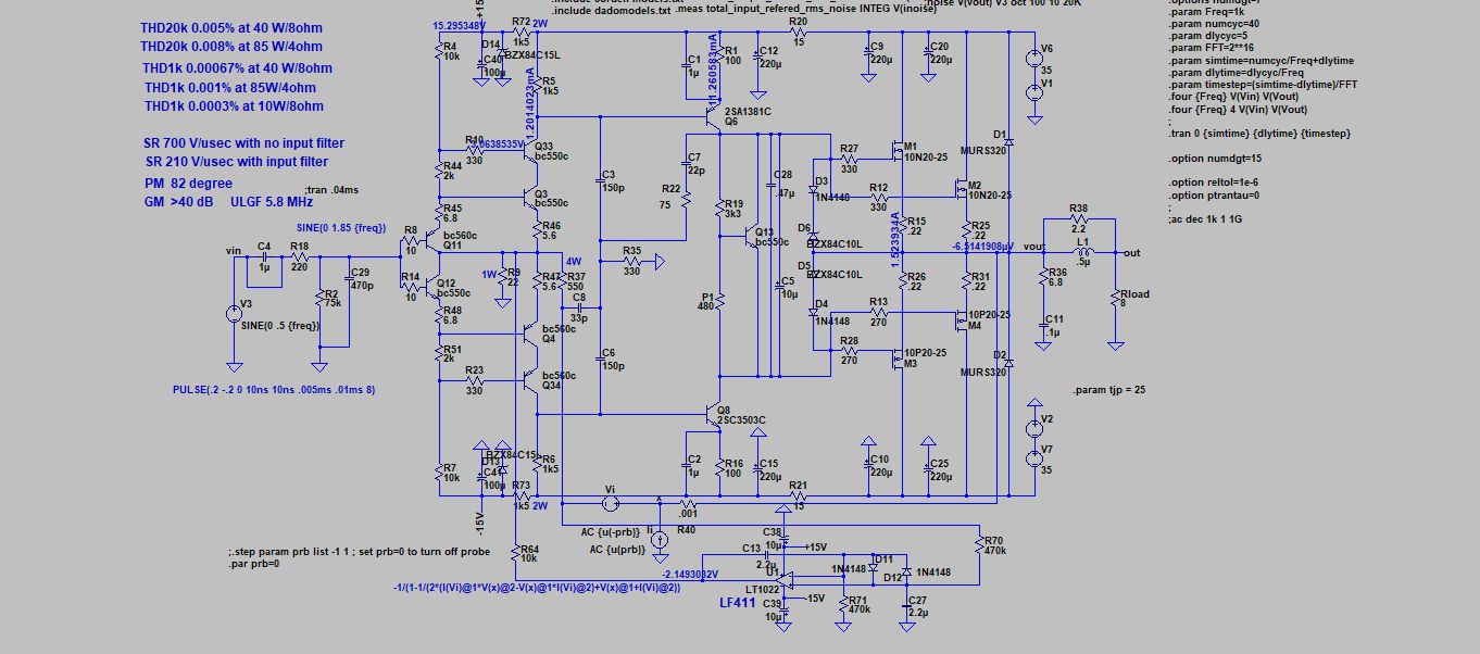

There is one interesting possibility to change a bit THD and harmonic shape at high frequencies, at 20kHz, by changing value of R20, the two pole compensation resistor.
Original value is 1k5 but could be lowered down to 220R and THD20k goes down, harmonics get more euphonic. Downside is lowering the Phase Margin but still stays very stable.
This could be done wile listening and decide what is better.

Have you looked ClassA schematic, there is +-35V of power supply?
This amp is 80W on 4ohm.

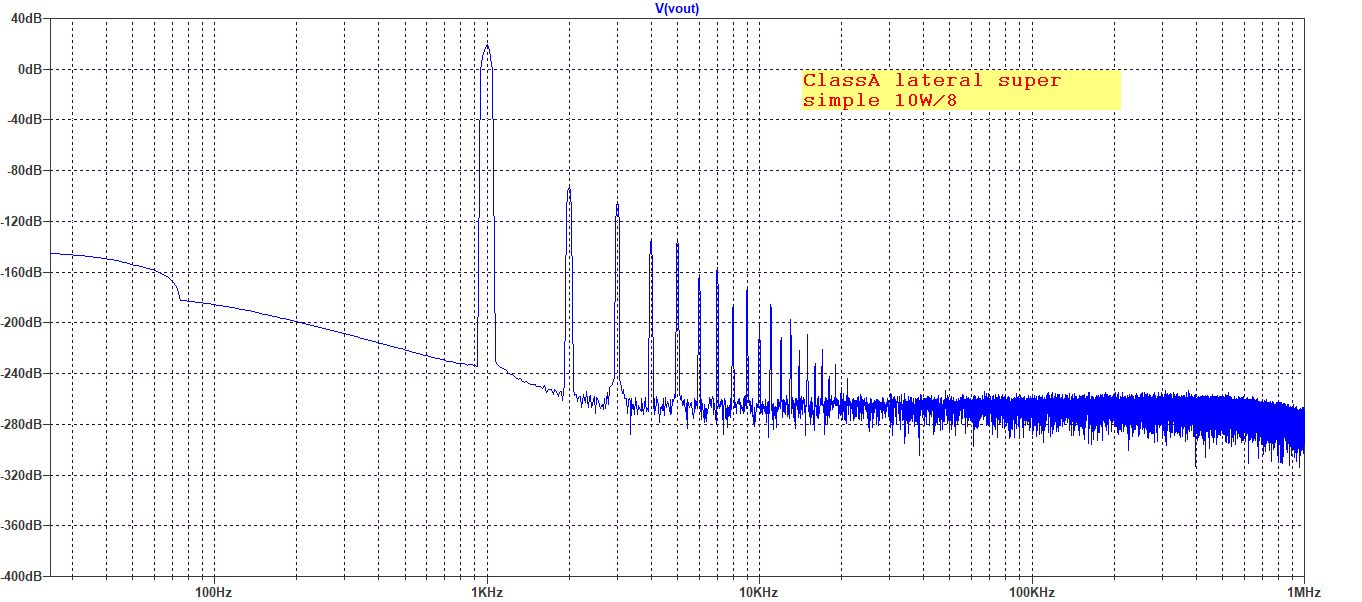

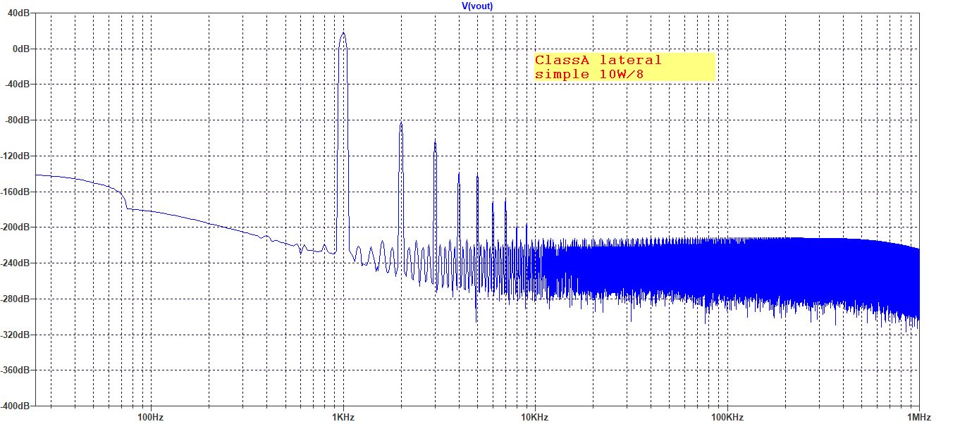

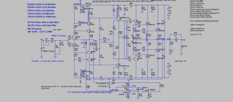

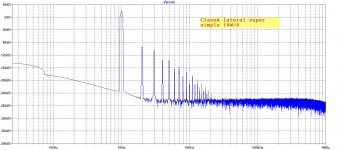

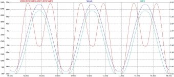

Here is this ClassA with no drivers. I increased the VAS current to cope with the mosfet drive, and here is the result.
Interestingly THD at low frequencies dropped but at high increased, specially at 4ohm load. Stability (PM and GM) did not changed, it is good as before, clipping a bit asymmetric.

LTspice schematic is here, https://www.diyaudio.com/forums/solid-state/338814-lateral-cfa-120w-bsa-3.html#post5817929.
Latter I will prepare schematic and BOM to correspond the PCB layout.
