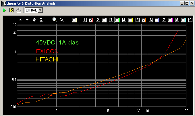

I bought 4 of Sloan's transistors and the exicon transistors (the 200v ones with more current). I plan on doing some listning tests but I have to admit I haven't gotten the amp built. Most of the circuit boards are populated, I need an enclosure.
So I'm not sure if they work well or not yet.

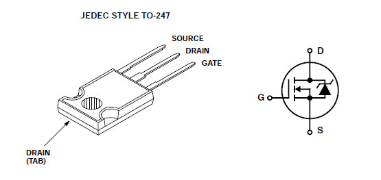

The IR devices are NOT a drop-in replacement for the Hitachi devices. The lateral devices have very different characteristics from HEXFETs. The zero tempco bias point for the Hitachis is around ~100mA; for the HEXFETs it is Amps (!), so you will have to do a bias regulator, unless you are doing Class A as Mr. Pass does.
mlloyd1
They aren't even pin-to-pin compatible!
