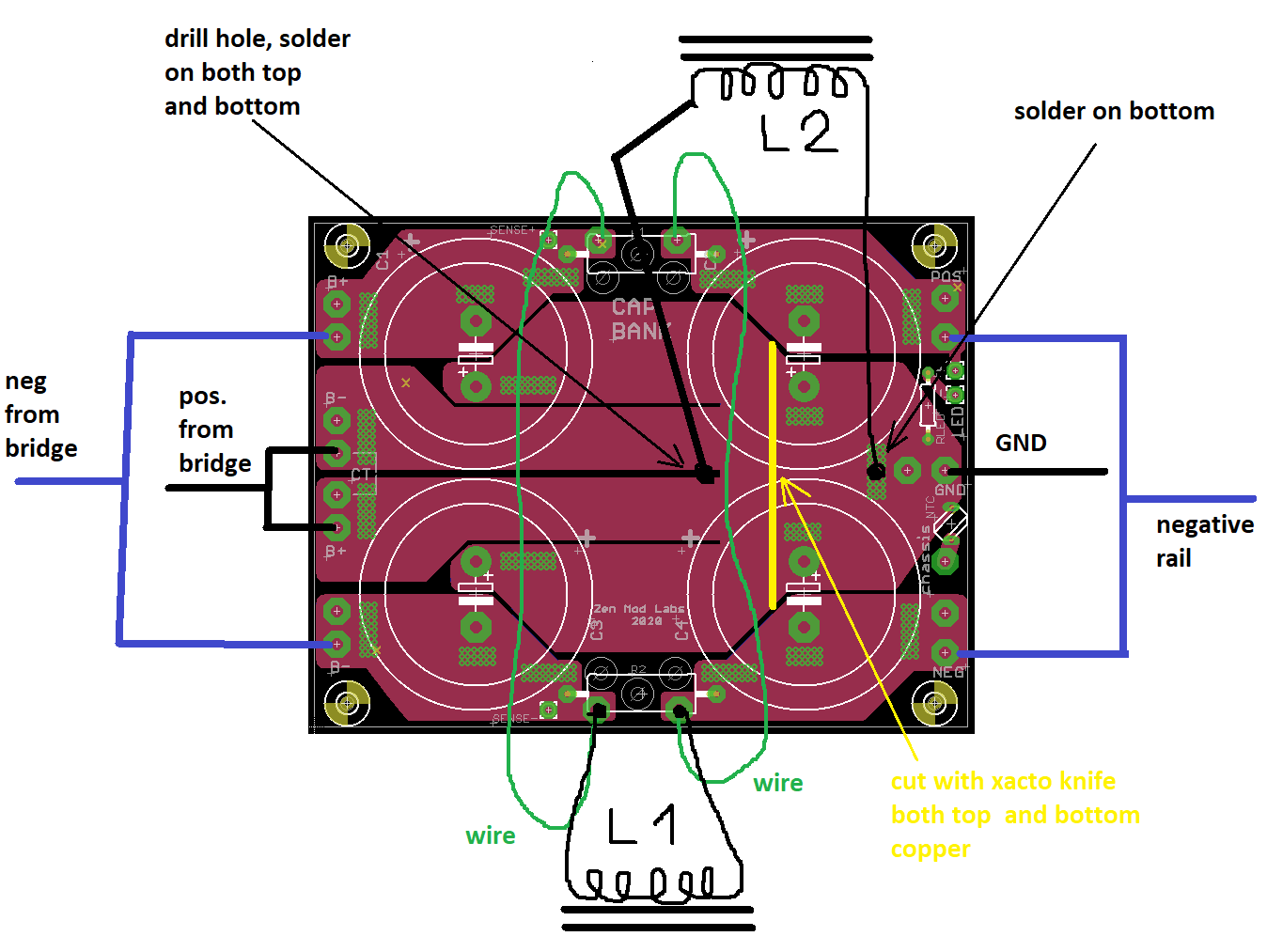

^ to confirm audio GND to chassis directly, I would connect from the black GND right side of diagram below, direct to chassis?
This is also directly connected to the black speaker binding post, yes?
Thanks ZM. It bothered me to no end that two identically constructed amps with matching PCBs behaved differently regarding measuring points to ground such as C* and U-. Close inspection and detection w/ DMM revealed monoblock #1's SIT mount belleville lock washer was just touching one of the wire end eyelets at the drain effectively grounding the device. So even without the audio GND to chassis installed, C* to chassis read normal at ~ 32V. Monoblock #2 did not.
Corrected that mount, added the grounds using the pre-drilled heatsink mounts close by to black speaker binding post. #1 measuring well so far heating back up now.

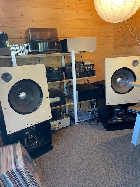

Now: Sony X77/ES>Monarch DIP>Project DAC Box E > IronPre > > 6-24 crossover > LazySingingBush monoblocks > Altec 420a open baffle. And 6-24 crossover low end to M2x > SLOB 15" beta.
Homage to ZM, Miles Davis Fran Dance. No harshness on the benchmark horn section. With Pat Metheny, these amps do dynamics really well, the quiet sections are wonderful.
I have the Altecs paired with their original console cone tweeters with Solen caps. Dead, dead silent with ear against tweeter.
Good fortune the heat has subsided for a few days, these are going to be great in late Fall, Winter early Spring.
I understand what folks were saying re: low THD and exceptional clarity. Nice amps, thanks very much.
