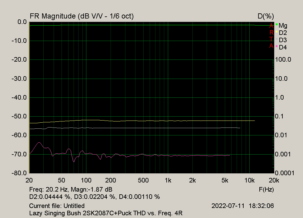

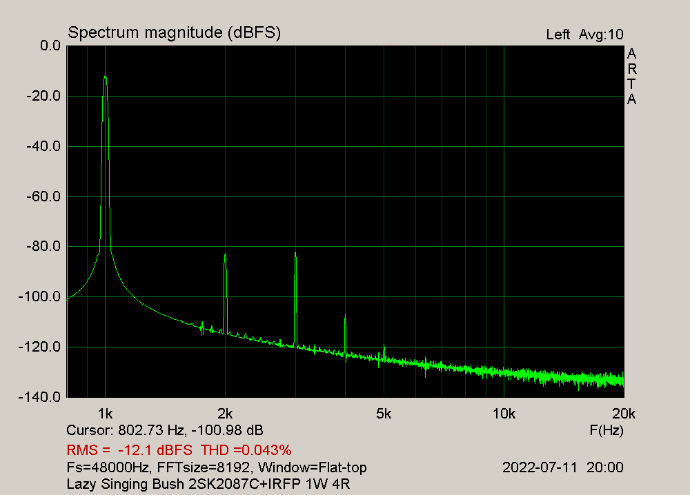

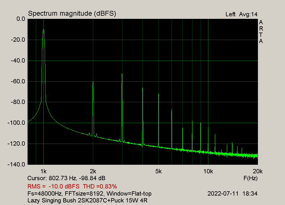

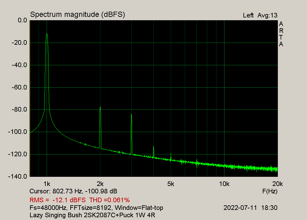

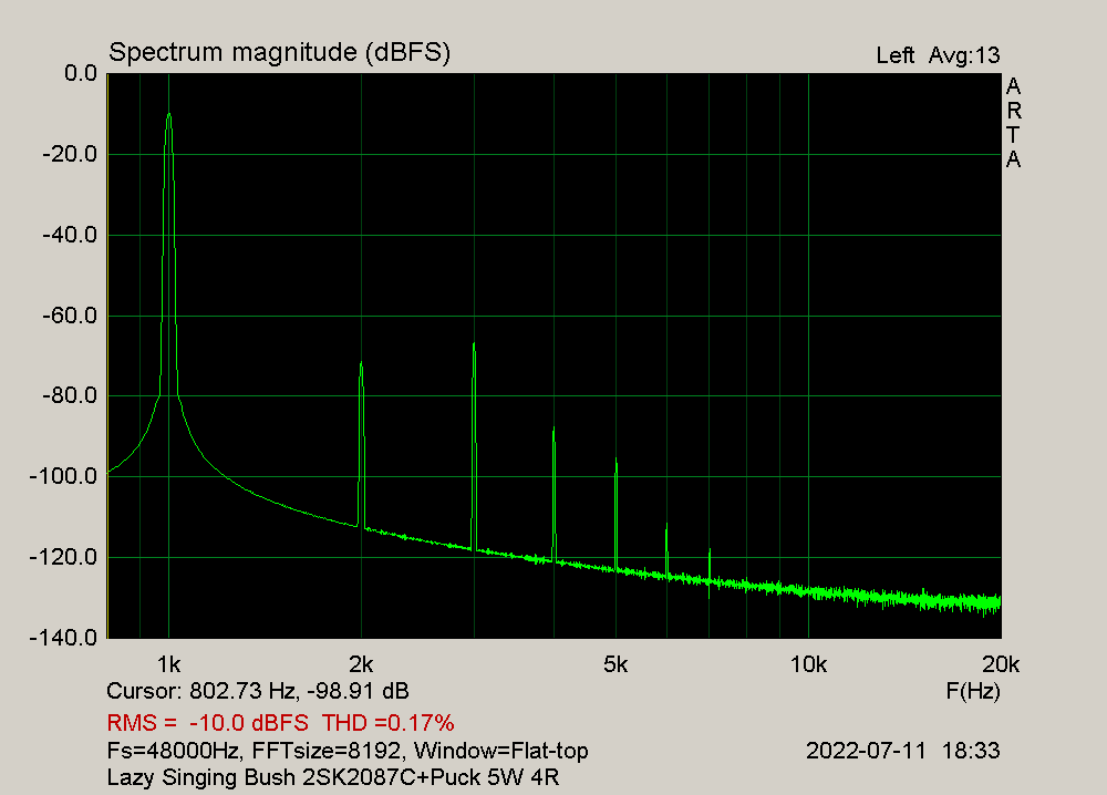

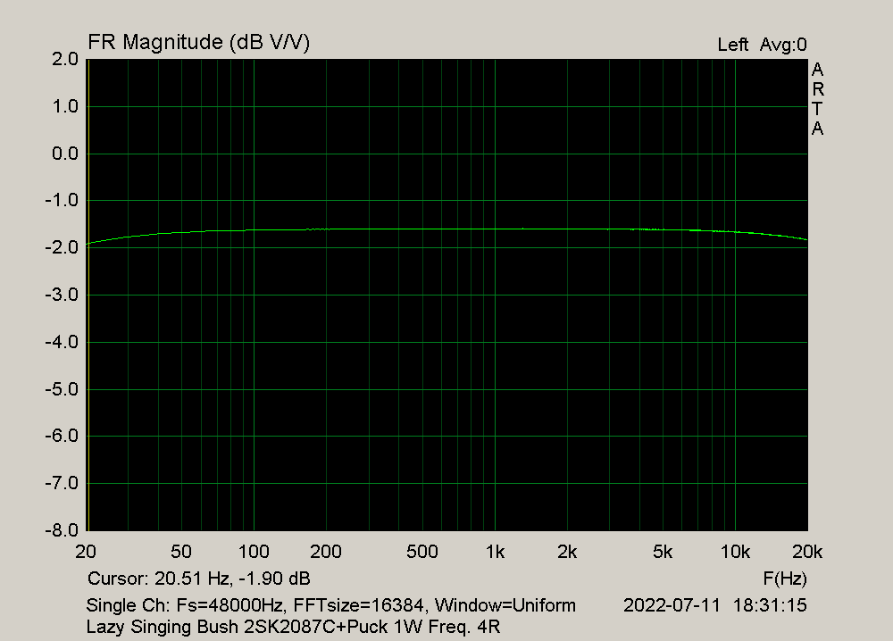

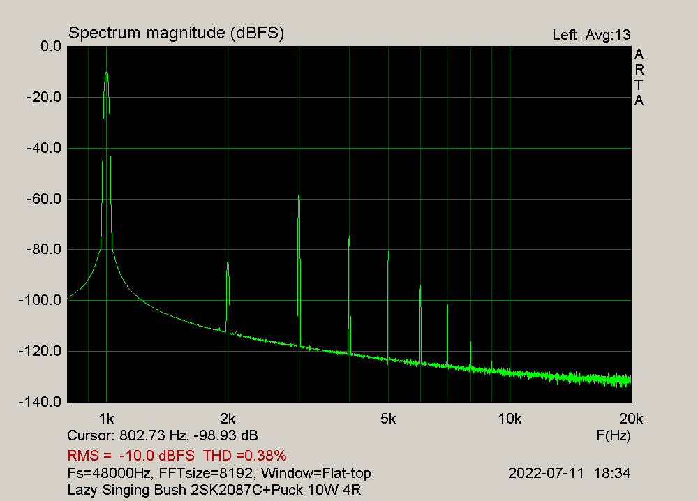

same , 4R load graphs

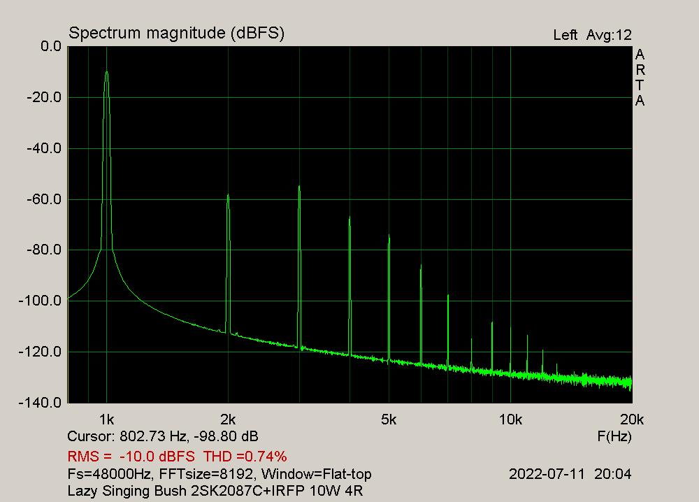

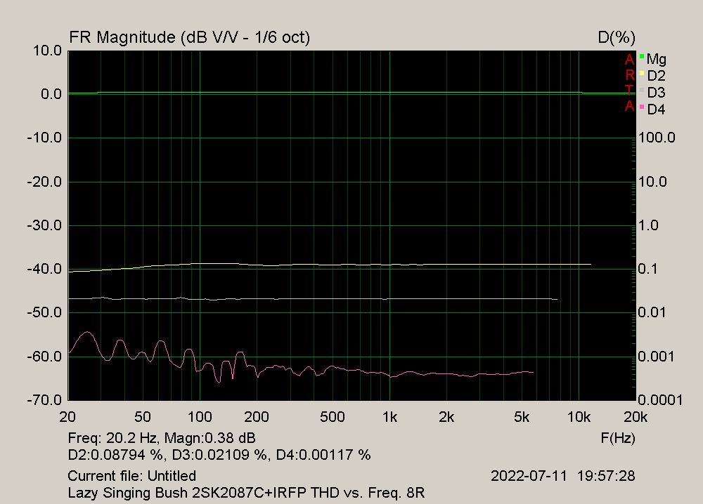

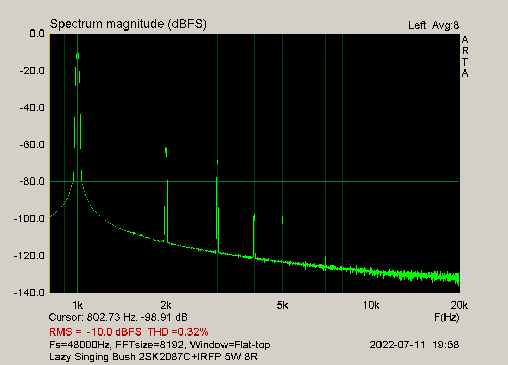

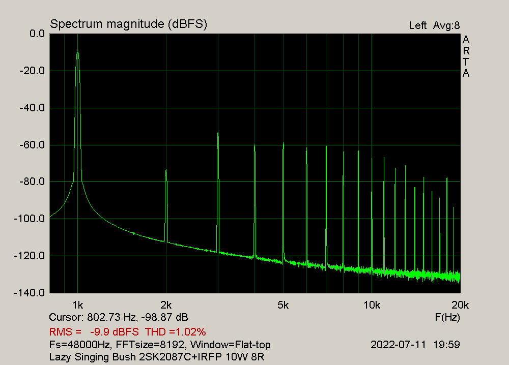

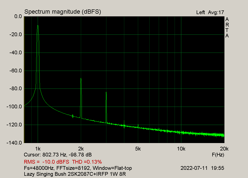

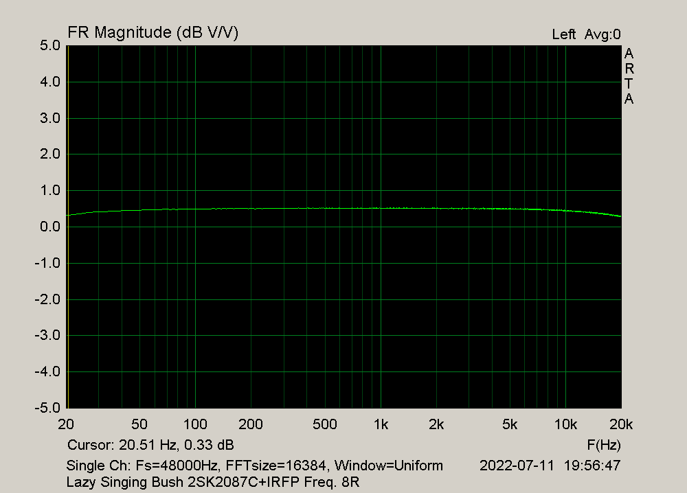

same, 8R load graphs

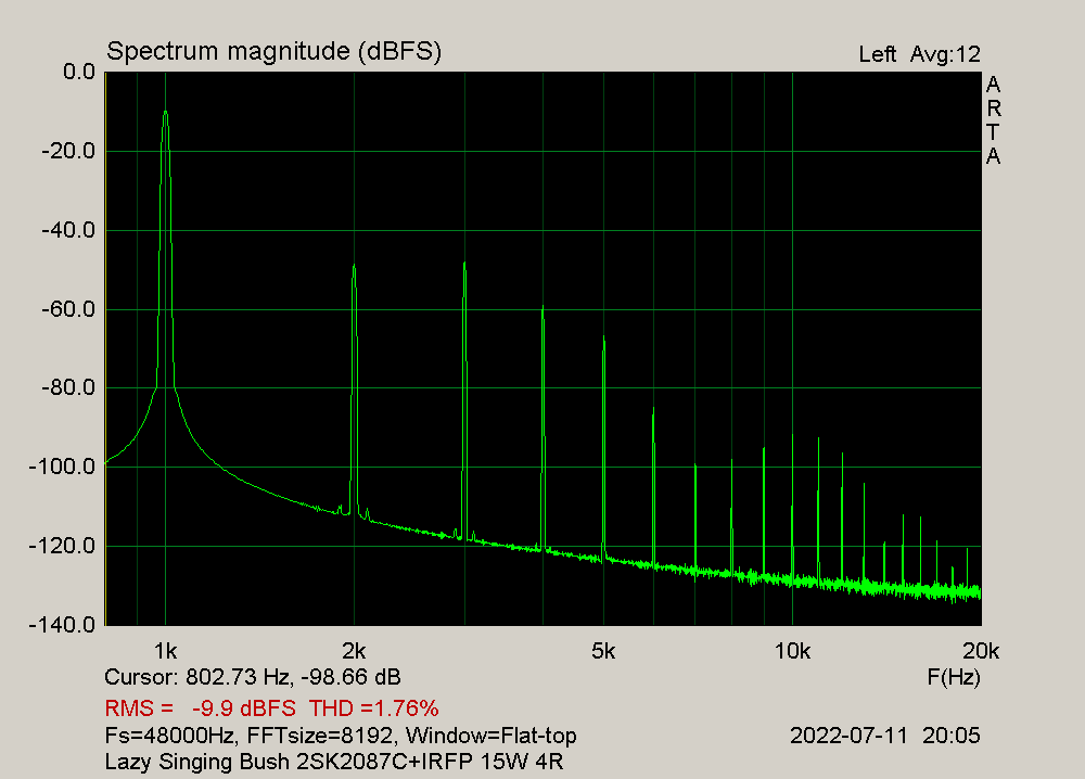

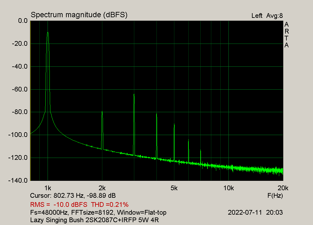

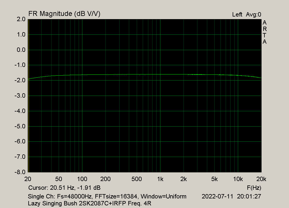

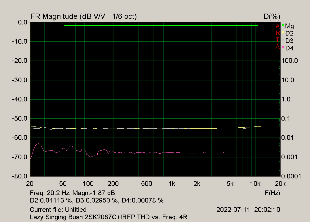

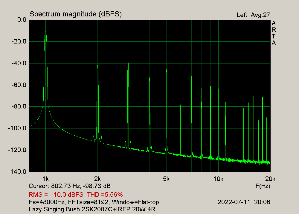

same, 4R load graphs

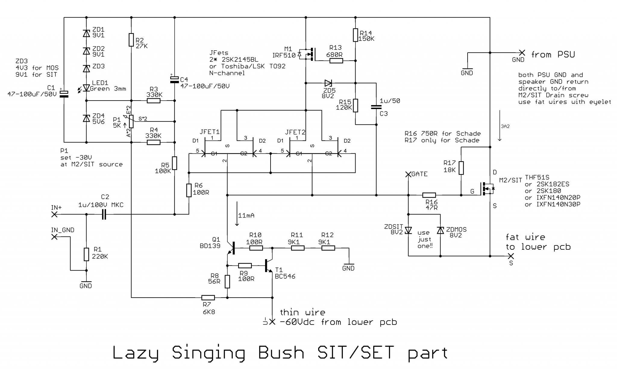

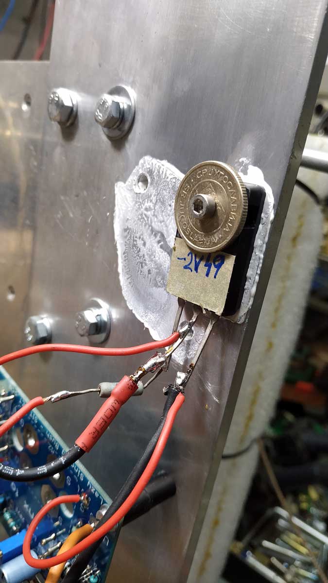

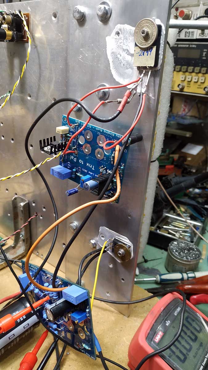

Following Ben Mah's findings, about 3:2 Mu resistors ratio, and counting that same applies to 2SK2087C, be it combined with puck or IRFP, that would be 3*1R2/3W MOX at Mu MOS Source side, and 3*0R82/3W MOX at SIT sideNow, as I promised - play with 2SK2087C
Iq decreased to 2A; did that prior to reading Ben's post, so for my tests I did stay at 1:1 ratio of resistor groups , decreasing them to 0R33 (3*1R in parallel); easy to recalculate to 3:2 ratio
so, 400mR + 273mR
resulting in sum of 673mR, pretty close to desired sum of 666mR
clearer:
R5,7,9 being 1R2/3W MOX
R4,6,8 being 0R82/3W MOX

ZM, should there be a resistor from drain to ground for a Schade MOS? It might be there because your measurements for Schaded MOS are different than pure MOS. It is also there on the Warbler schematic.
I’m trying to learn the biasing scheme for the 2sk2087c from your many designs!!! Trying to use an LND150 CCS to develop a stable reference voltage. It needs a gate to ground “grid-leak” type resistor but then it is rock steady.
as I said many times (more clever people have better understanding and certainly explanation for that than Mighty Moi) - GND is state of mind
here, GND is "nothing more and else" than positive rail for SIT
we chose (me, looking at mentioned guys) GND as upper rail simply counting on practical fact that GND (whichever way we got to it) is in most cases lesser polluted rail of them all
so, ignore GND when thinking of Schade arrangement; there is resistor from D to G, there is series resistor to G - all you need
now, "biasing"
you need to differentiate several purposes of it*** :
biasing with purpose of setting Iq
biasing with purpose of setting voltage level
biasing in purpose of setting both of these
in this case , entire shebang is having Iq set in Mu Follower itself, ( optothingie)
with biasing input JFet buffer gates, in voltage realm, we are automatically doing same thing for SIT gate - thus setting its Source voltage, which we wanna keep at approx. 1/2 of sum rail value
here, that's 60Vdc-ish, so goal is to get SIT Source somewhere at -30Vdc level
easy peasy
***that's why I'm often insisting that "biasing" term must be either clarified or clearly established in context; if nothing else - just to avoid Mighty Moi being confused ( easy)
example - if you say - "this part is biased to Iq of 3A2", everything is clear ........... but it's even clearer if you say "this part is biased to Iq of 3A2 with Iq setting of Mu Follower, while output node is biased to half rail value with setting of P1", everything ref. to pic above
