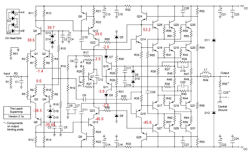

No signal. I had turned on the amp first because I didn't like the the way is pumps the speakers when it comes on. Not a problem when I'm using two prong jacks. These stupid single metal jacks are another story. I won't try that again. Would have probably been OK if I would have hooked up the negative lead first.
Water under the bridge, I have the amp torn apart now. Going to have to find what I hurt. The outputs all measure OK with an ohm meter. Must be before them.
At idle you would expect just a few mV and not much current even if shorted. Makes me feel like it may have gone south before you tried plugging in your speakers.
Check all pads for invisible bridges.
For documentation sake please report what you measured and the results when you say the outputs are fine.
Next time you get it up and running give it some burn in time into a dummy load.

Yeah, I have to use a magnifying glass for checking the fine stuff. I am fairly sure there is no bridge at this point. I have been playing for 10 days now. I listen to it every day. I'm not diggin' the big turn-on thump though.
Do you guys have an idea what is causing it to swing negative when it reaches 80V. Its a little off to the negative side before that but when it gets to 81V it swings all the way negative.

Amptech, I'm trying to understand the danger of how plugging speakers. Isn't the speaker relay doing the same thing as connecting the speakers to the terminals? Sure, the return connection is always made and the relay is in the hot lead, but my DH-500 had connected the speaker with the amp delivering a mid level signal almost every day for nearly 30 years. Problems could occur if the cables are shorted, though.
If, as in Terry's case, there is no signal and DC offset is in the tens of mV how much damage can it do to short that to ground. Isn't the bank of emitter resistors between each output device and the output enough to limit the current to a safe level when starting from mV? With 0R47s the current should have been ~0.1A per output device at a DC offset of 50 mV. In a PM Terry told me that this channel only had 7 mV DC offset, so the outputs should have survived shorting.
Anyway, If I understand your problem correctly, you get ~rail voltage on the outputs and the rail fuses are intact. This implies that the high current stages are OK.
If you somehow blew a rail fuse this will result in rail voltage offset. I've done this a couple of times on LowTIMs (errant probes and screwdriver) but simply replacing the fuse restored all to good graces. I presume that you have checked the rail fuses and still have a problem, though.
I'd set up the board like you did for checking your LowTIM amp before powering up. I don't have the schematic handy, but jumper the capacitor across the Vbe multiplier to keep the output stage turned off and jumper the to 1K that provide intermediate feedback to the main feedback trace.
Check for offset now. Likely you will still have the same offset. If not, check the predriver and drivers.
Check that one of the VAS protection transistors hasn't shut off one side, making the VAS go to the other rail. check the voltage across the emitter resistors on both sides of the VAS.
Check the voltages on the top of the zener strings. you should see 40V. What is the base voltage on the inputs? Measure inside the input capacitor, you should see 0V.
Measure the voltage across the resistors loading the input differentials. They should be symmetric.
Once you restore basic operation, my guess is the thump is caused by the CCSs or cascodes turning on at different times. Check that the proper or at least matching values are inserted on both positive and negative sides. The electrolytics in the front end could be at opposite ends of their tolerance bands or the resistors that you calculate based on rail voltage could be slightly different values. Either would change the time constant and affect front end turn on.

I just tested all of my other amps, and not one moved the woofers on my speakers. I really think I was seeing some serious offset when this thing was starting up. It reminded me of a few years ago when I bought a Soundcraftsmen amp and just plugged it in with the speakers attached. I heard a similar sound and the speakers flexed. I shut it down and checked and had rail voltage on both sides. I considered myself very lucky that I didn't ruin the speakers. I never did that again. From that point forward, I always check for offset on the outputs before I hook up any speakers. The problem with this Superamp is it measured really good when up and running. It only did that for about 2 seconds and then stopped. You can be sure I will not hook any speakers up to this again until I'm sure that won't happen again. Also, I have about 6 guitar and bass amps so I checked them too. None of them moved the speakers that way this did.
Fuses are good.
OK, I jumpered C12. Don't know what you mean about the 1K.
Offset didn't change.
I don't know which resistors those are.
+ side = 39.7, - side -39,07
-23mv
Yes, about the same
Here is what I found today.
I ran the rails up to +-75V so it wouldn't go negative. I got the voltages shown in the attached drawing. After I took the readings, I lifted D7 & D8. That didn't change much but I was able to raise the rails to 87V before it would swing negative. When that happened, the offset would go from -1.5V to -50Vdc. Q12C went from +53V to +39V and Q13C from -46V to -53.

God Morning Terry. Recheck the voltages placed near R66 and R65. Near R65 you have -2.0, but near R25 you have 2.5 and these points are (should be) connected by a trace. Or was that the measurement on the feedback trace?
Are these measurements with C12 jumpered?
Andrew brings up a good point. Is there an oscillation on the output?

Sorry I should have been more clear. The measurements are with a jumper across Q7E & C. Also with D7 & D8 lifted. I need to find a better program to use to post the voltages so I can gt them closer to where they go. The +2.5 is Q10E. The -2.0 is Q14B.
I will try to test for oscillation. How do I go about checking that? I can easily hook up the scope. Should I hook D7&D8 back up? What about the jumper on Q7? Would it be better to remove the outputs from the circuit for this?

To check for oscillation, just hook your scope to the output with AC input selected and look for anything.
That still is odd. You're saying that Q10 emitter is at +2.5, or +2.5 DC offset. Q14 and Q15 bases are tied together turning them off, yet their emitters are ~4.5 V more positive than the bases. To me this implies either Q14 is leaking or Q16 and 26 are. Check the voltage across R36. It should be 0 with Q7 jumpered.
Oops - that's the other part of the Leach check procedure I forgot. In addition to jumpering Q7
  1. Temporarily tack solder two 100 ohm resistors to the back of each circuit board, one from the loudspeaker output to one side of R36 and the other from the loudspeaker output to the other side of R36.
You can pull the outputs and test out the front end board from here.
