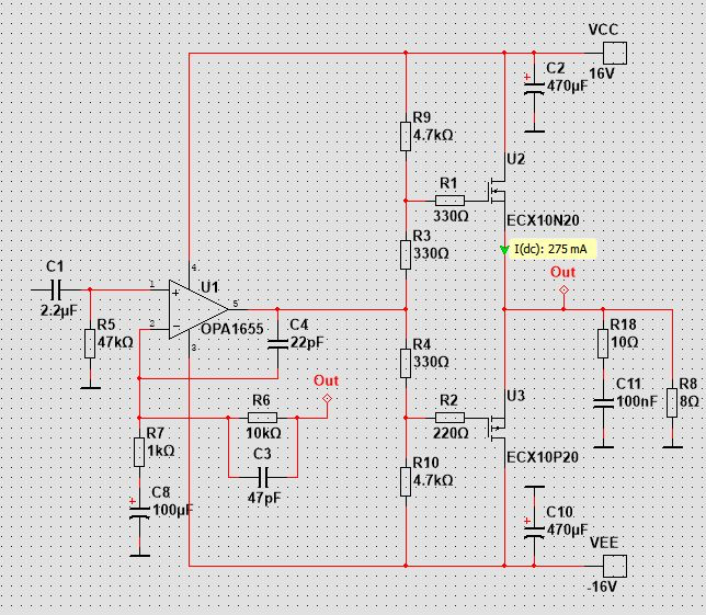

Simple question: Why do most (almost all) negative feedback amplifiers use Miller compensation rather than lead/lag? The latter has a much flatter Bode plot of the OLG which, I believe, should increase the slew rates.
What’s the disadvantage of a lead/lag (other than the need for larger caps)?

Most amplifiers use a Miller capacitor around the VAS because it moves the dominant pole (formed by the VAS's collector-base capacitance) to a much lower frequency, without creating a new pole. The last thing one wants is two low-frequency poles.
Successful use of lag compensation requires moving the VAS's collector-base pole to a much higher frequency. This is best done through cascoding. I like this approach because it does not degrade the PSRR at high frequencies.
A lead capacitor can be used with either technique.

To use lead/lag compensation, you have to know exactly where the existing poles are.
You see tube amps almost use lead/lag compensation exclusively, because the major pole is from the output transformer. The manufacturers definitely know the location of the pole of the transformer.

Lead comp in a VFA gains you some phase margin around the unity loop gain frequency. But, if you over do it you can make a decently Miller comp’d amp’s transient response worse, so you should check this out in a sim and then on the bench.
(Never ever use lead comp on a CFA! You will have a fine power oscillator)
Another problem with a lead capacitor is that it can couple RFI on the amplifier's output back to its input.
