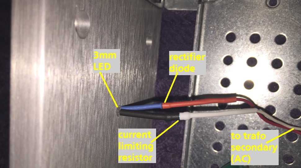

I connected the front panel mounted, power-is-on LED, to the transformer secondary, in my Cordell Super Gain Clone build. In the photo below you can see the heatshrink tubing I used to insulate the components and their bare wire leads:
I didn't include any filtering, and I didn't see any flickering. I like this arrangement because the LED goes dark instantaneously, it is not connected to any filter capacitors that must discharge before the LED can extinguish. So when I flip the AC mains power switch to OFF, the LED goes out with zero delay.
Every time I post this photo, people go mental when I mention that the rectifier diode in the picture is a 1N3595. I have a drawer full of these and I use them a lot. If you don't have a drawer full of 1N3595s, don't fear: you can use any diode whose max reverse voltage spec is at least 2X the transformer secondary voltage.

The other view is that in various situations the LED bleeds caps and that slowing decaying light shows the caps to be discharged. When fed DC they will not flicker in a lifetime 🙂 I have never noticed flickering with LEDs on 50 Hz pulsating DC (except when filming) and I would also not loose sleep over it either but a cap won't harm. A light bulb filament glows after the voltage is gone and it lighted on both halves of the sinus so the flickering effect is likely less than with using pulsating DC on LEDs.
Could you explain post #11 a few pages ago with the double LED? In post #30 you use the suggested series diode.
I'm not him, but posts #11 and #30 show different approaches. While #30 follows your suggestion, #11 means two diodes in parallel, back to back. I'd prefer the latter one, as the two diodes protect each other against excessive reverse voltage, whereas in a rectifier arrangement the reverse voltage distribution depend on the reverse impedances, or currents, of both diodes. I don't know fur sure as the reverse currents aren't mentioned in LED datasheets, but if a LED were the »better« rectifier with lower reverse current, the reverse voltage drop over it might exceed the ratings.
A common small signal diode back to back with the LED will do the same trick, of course, but can't be hidden that easily with just some shrinking tube.

KP check the datasheet of the 1N3595, it has world-beating reverse leakage in the thru hole category. Also remember that the current limiting resistor is present, so even if the 1N3595 becomes a short circuit, the amount of current available to do damage, isn't large.

In my tube amp, for power indicator (the tubes are in a screened cage) I merely used a blue LED with a 4.7K resistor and 1N4004 diode in series with the LED, fed from the 6.3V filament line.
Nice, simple, safe, and the LED isn't blindingly bright.
