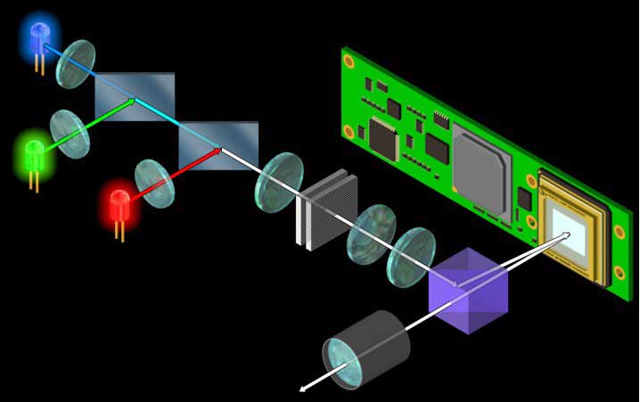

Could someone please explain all of the parts in the following picture of the image engine used in the Samsung HL-S5679W RPTV. I am primarily interested in how the outputs from the leds are combined.
