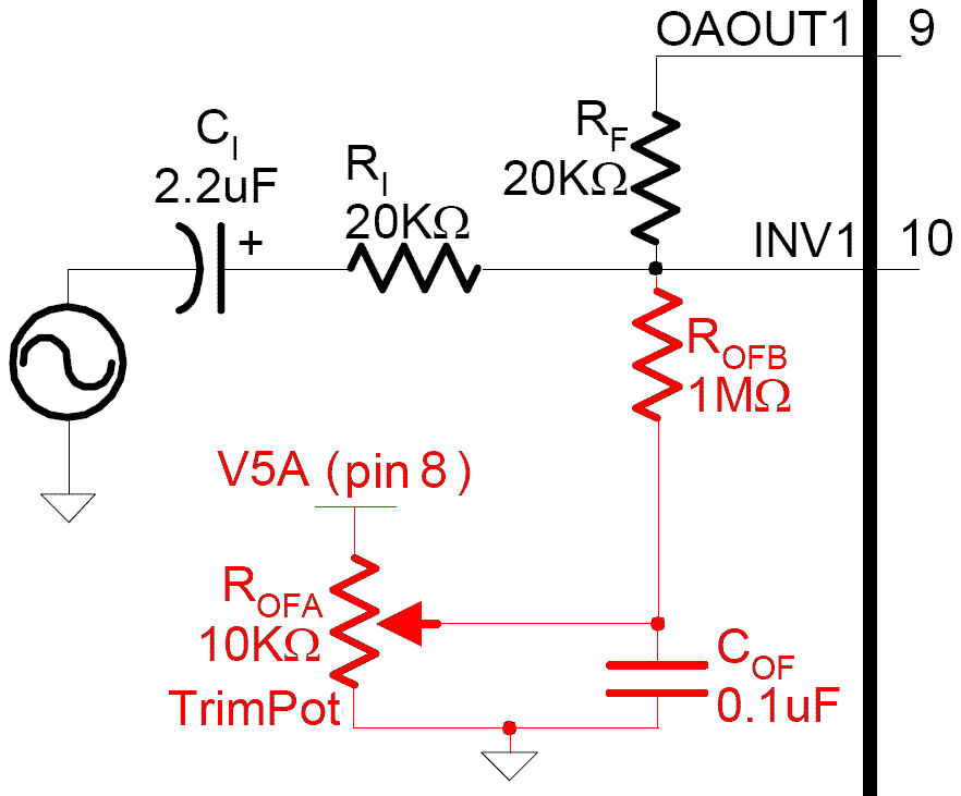

I'm getting 70mV of DC offset on both channels, is there any way to reduce it?

As stated in the post, circuit is for one channel.

The trim pot addition is easy to do if you can solder. If you can't, you should learn to, it's a basic DIY skill.
Admitted, working on a rather compact SMD-layout board can take basic DIY skills to the limit. This was why I proposed to work on the common pin 14 instead. As both outputs are around 70mV offset, a common (both outputs together) compensation should work. If you had +70mV on one output and -15mV on the other, you would need individual compensation. Working on pin 14, a single resistor may do the job.
