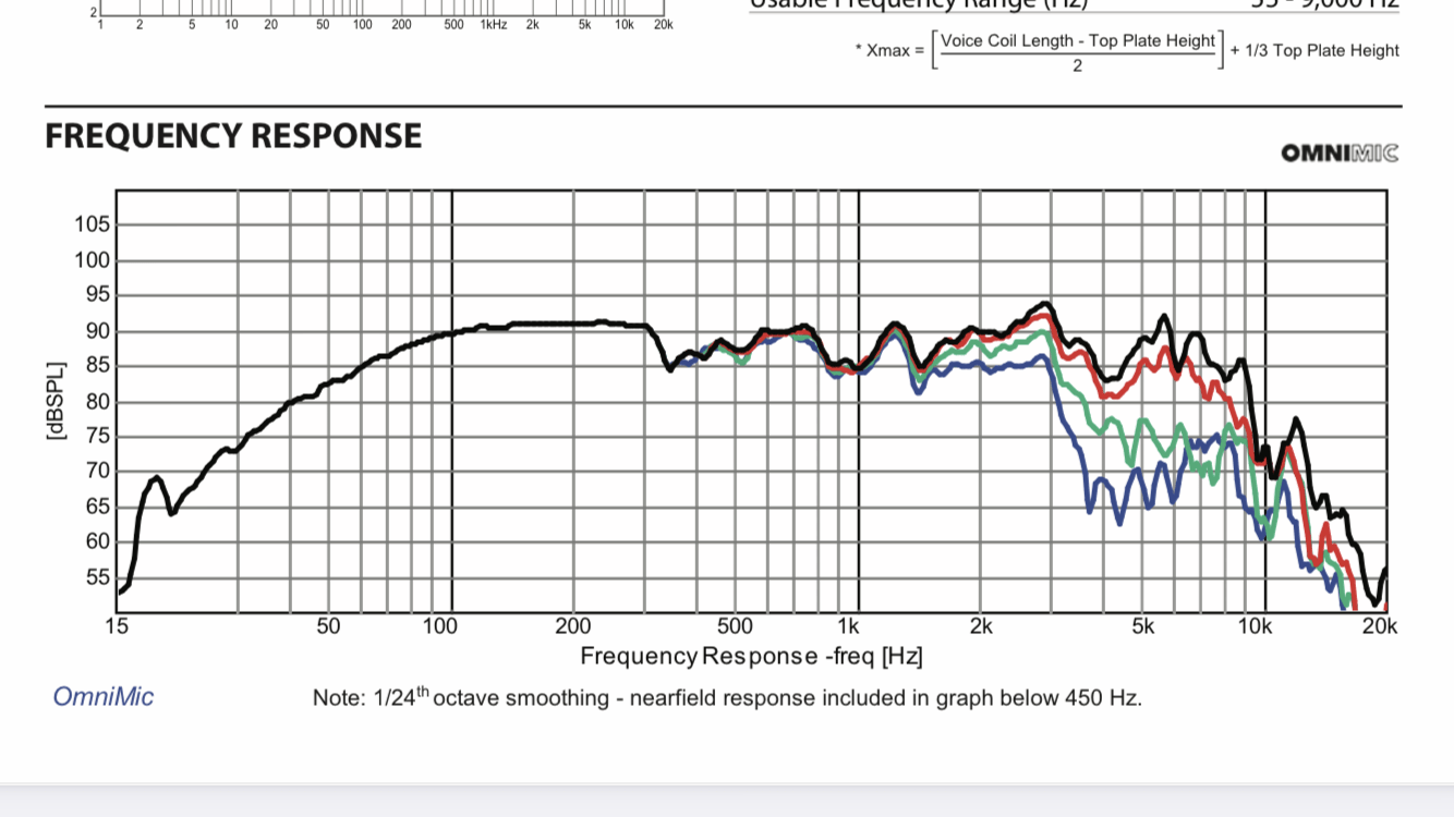

I was unable to find third-party measurements of this driver, but data sheet curves aren’t looking great, like GRS spent money on motor and skimped on moving assembly engineering.GRS 8PT-8 8" Paper Cone

thanks. The GRS was suggested by Parts Express as one that would fit along with the Dayton Audio PA200-8 8" Pro Woofer Speaker 8 Ohm. I threw the GRS out there because it had what seemed to be close numbers on power handling, sensitivity, Fs and speaker volume. The Dayton is pricier and calls for less volume. To be honest, price is not an issue, as I have the means to put whatever I want (within reason), but wary about spending foolishly. Read too many threads about people wanting to re-use cabinets over "proven designs". Not sure if PE suggested those 2 only because the oem drivers have a less common 8 holes in the mounting section. I will quote my message to pe about that:Another challenge of replacement is finding a driver that physically fits the original cut out, especially if it has a recess.
