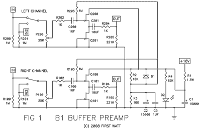

1. Adding an extra cap in parallel with the ones already in the DAC (increasing size of output cap to ~10uF made no difference. This should be the same as what you suggested Andrew about removing the output cap from the source and putting an input cap in front of the LS?
2. So I then went to plan B. Found a 1meg lin pot and fitted that. Straight away, the bass was back. So in my sertup at least, a 1meg pot was needed. A good benefit is that the range on the pot is much more. So I'm very happy. I did have to use a trimmer on the left channel as I had some imbalance, but that seems sorted now.
So increasing the pot size seems to have sorted this out.
no a series pair of capacitors ahs a combined capacitance that is less than either.
If one were 4u7F and the other were 2u2F and they fed 20k then the RC of the original would be 15ms
Doubling the 4u7 to 9u4 increases the RC to 17.8ms.
That is a change of approximately one third of an octave.
Try shorting out the smaller of the two coupling caps. Compare one DC blocking cap to the previous set up.
Now treble that single DC blocking cap and compare that to the original set up.
Have you heard any differences?
Here is the B1 schematic:
The caps I am referring to are C200 and C100. In the text he says:
"C100 and C200 are there because the Gate of the JFETs needs to be set at half the DC voltage of the power supply - a voltage delivered to the buffer inputs by R2, R3, and C2 through R103 or R203."
So maybe I have that wrong earlier about the 1uF in the B1.
In any case.... I must have it wrong because on listening last night, all the bass is back. So for me at least, this is fixed by your suggestion of the 1meg pot. Uriah, if you get time, you should try it out if you have any of those 500K LDRs left. I would be interested to see if anyone else sees (hears?) the same thing.
Fran
