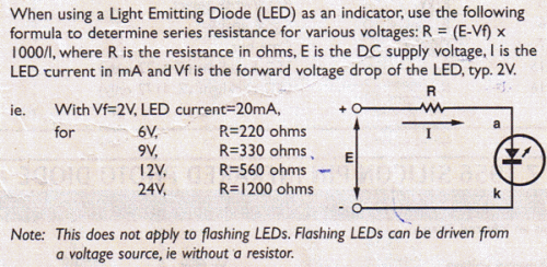

As for the led current, the led in the Silonex NSL-32SRS (sorted) works perfect with +5vdc 100ohm current resistor, as for what led you are using this will change just use the led current resitor formula.
