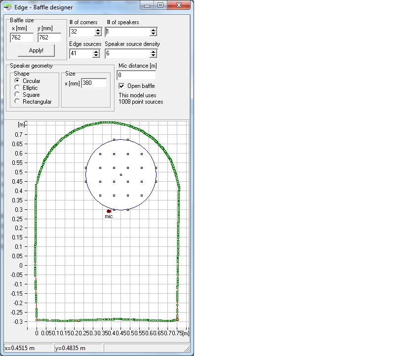

Not sure what's producing that 3dB lift at the lower mids on the "edge program" but maybe this assumes some floor coupling perhaps - could you try it with some curved sides like a wine cask/keg - if the height is about 50", the sides will 'belly-out' about 9" to give an outside width about 30+", maybe 35"?
Wouldn't it be good to have a freq response above 700Hz as smooth as the diagram indicates!
I assume bass is maximum here and diminishes as you move the driver towards any edge
However to my eye, the resulting FR is "better".
Could someone please confirm that I'm using the program as intended?
However I never see that position - nor any other - in these common arrangements; always the "stock" placement.
"43% down from the top"
Hmm, max bass will be at the very bottom where it will get the full gain of mirror imaging, so obviously normally limited to a bass app, though tilted back like the Wharfdale it can be used over a wider BW.
Right, as you move off center the eigenmodes between the driver/baffle edge becomes increasingly random, smoothing out the frequency response.

Did [can] you account for the baffle being angled back like the Wharfdale ? This changes the response. Regardless, there's numerous reasons why different designers/DIYers choose to not 'rock the boat' as consumers and 'significant others' can be pretty fickle about size/shape/'look'. That, or just didn't have the technical knowledge we're exposing you to.
Earlier, I posted "Vertically, at some odd harmonic, so normally at H*0.21, 0.349, 0.424." H*0.424 is the actual 43%. ;)

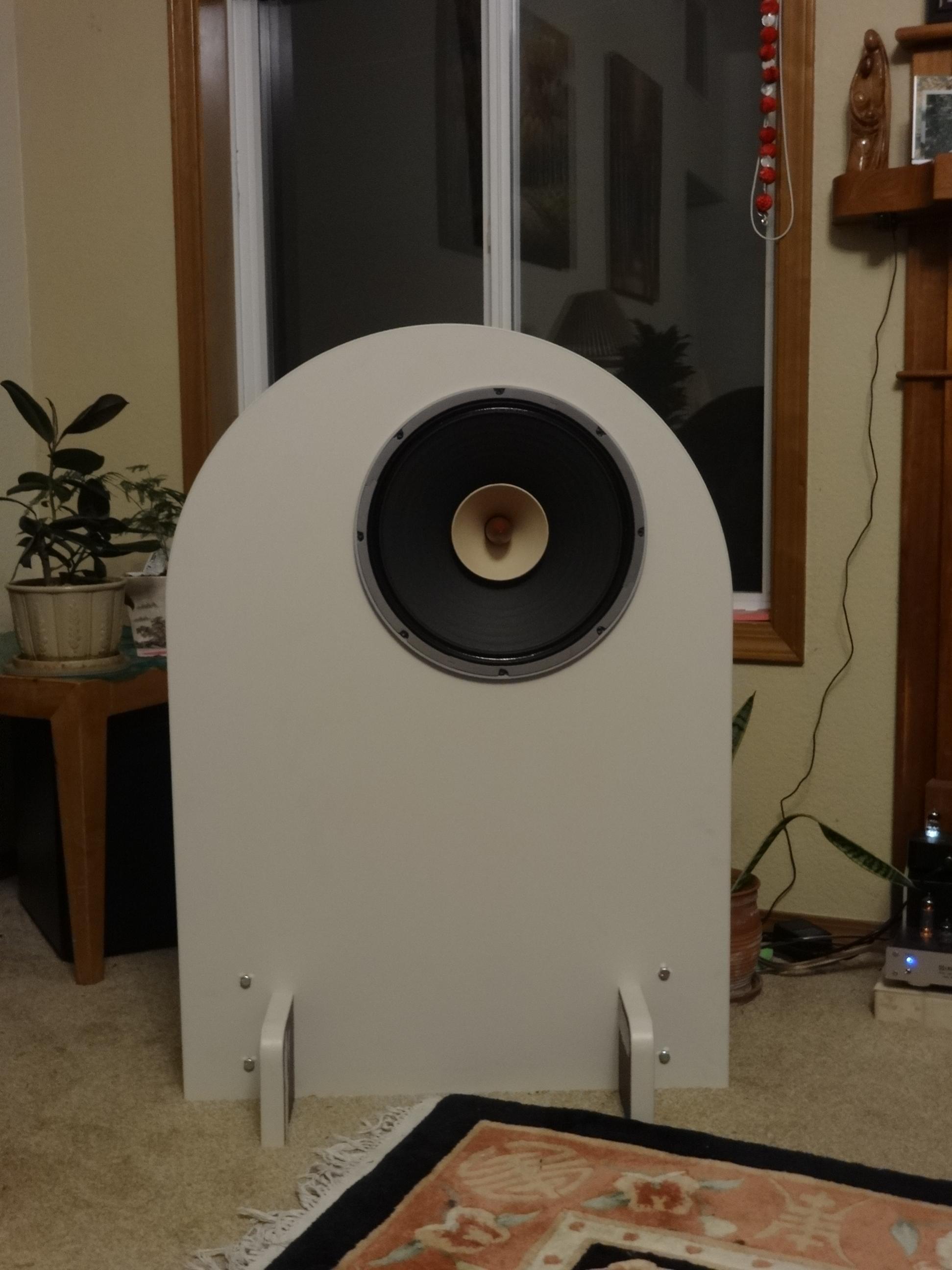

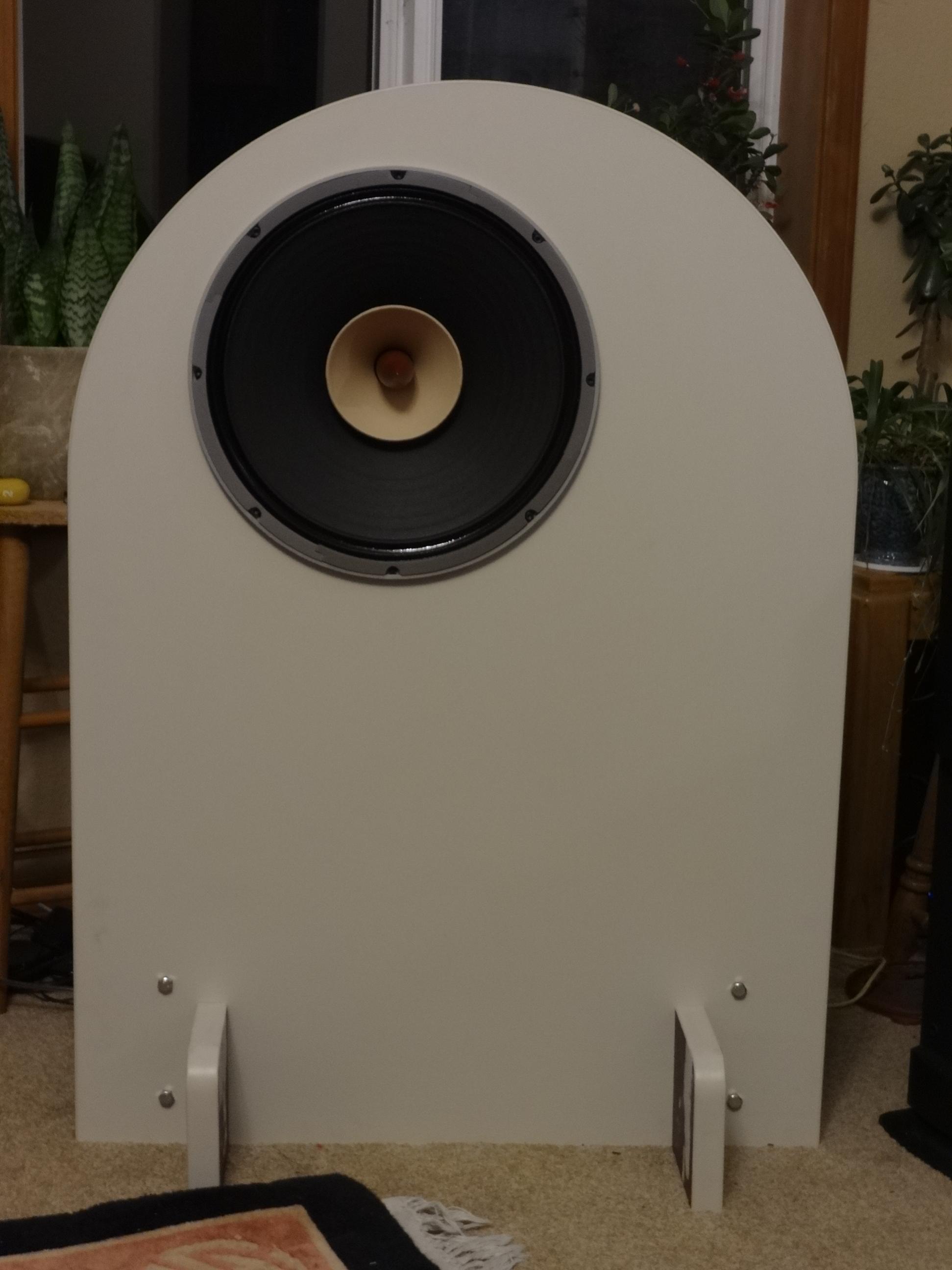

Lii 15" Finally in OB
I finally got to it and put these F15s in the table top laminated MDF material I picked up. I did use "The Edge" to locate the speaker geometry on the OB and basically put them where I felt best after running through several candidate positions. I believe the hump shown in the response is audible and I've improved it some with EQ in the Daphile player I'm using.
See photos -
There were a few challenges, as I dont have the ideal tool set for creating these, but I designed some guides for cutting straight 30" lines and 14" circles, drilling at right angles, etc. I have a small drill press and table saw, but most of it was fabricated using free-hand tools. A 60 tooth circular saw blade made decent cuts with some occasional chipping of the laminate - I did miss the target location of one of the drivers; one's 1/8" closer to the baffle edge than the other.
The boards stand 41.5" tall and 30" wide. I kept the 30" diameter circle of the original table design, as I preferred not to disrupt the already applied edging. I made the front toes and back legs from the slice I took off to set the height. This is my "poor-boy" version of the Decware "ZF15L" for basically the cost of the Lii Audio F15 drivers plus some shop effort.
These things are big and I have a very nice wife to allow me to have them in the living room. I havent had any time to experiment with room placement, having just put them into form today. (If someone could suggest an approach to putting a protective grille over these drivers, I'd be happy to listen!)

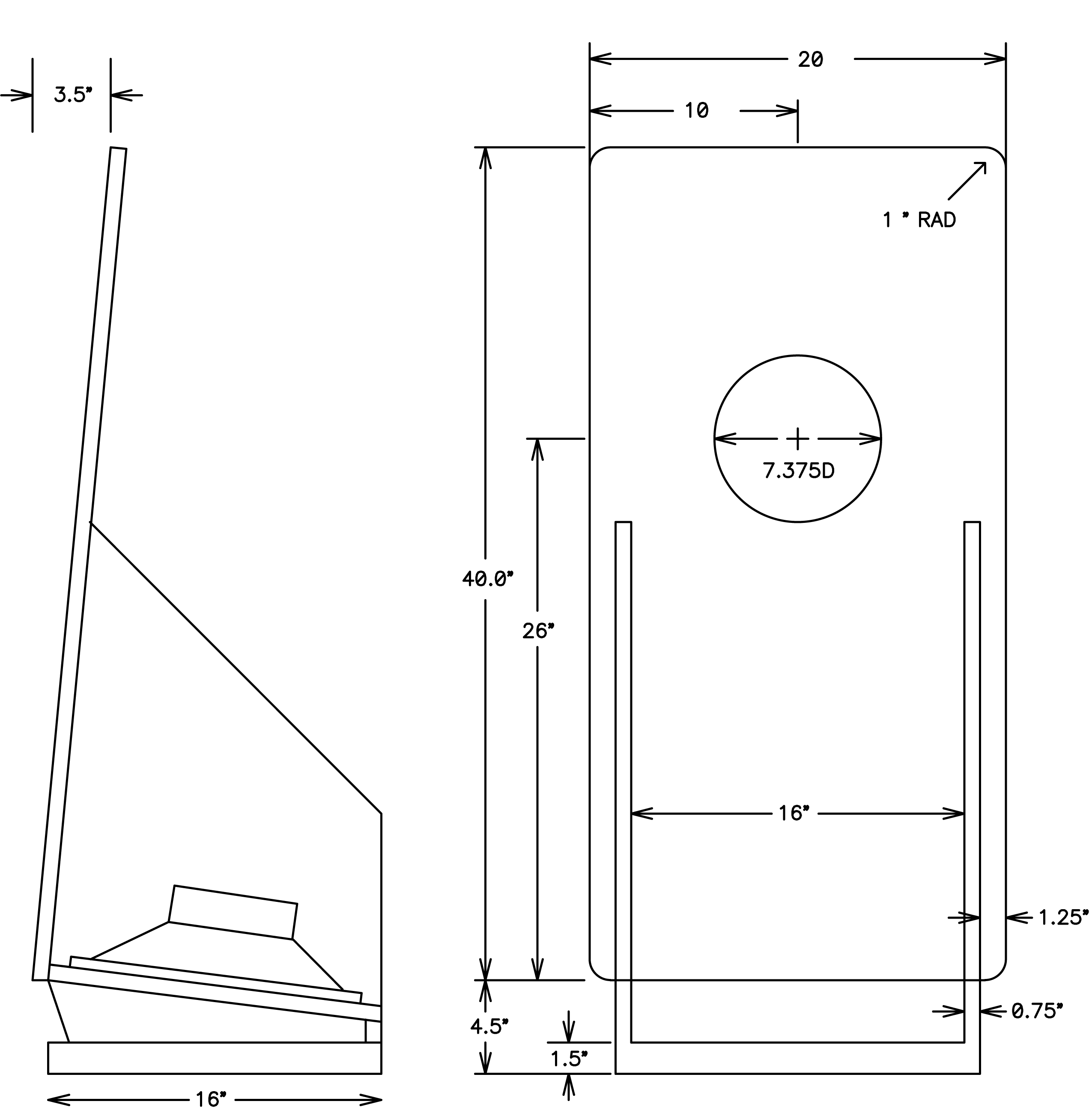

The F15 looks promising but as stated in this thread, the Qts is a bit high for an enclosure. I used unibox to model the enclosure they have on their website but the F3 is only ~40Hz with only a 1.5db spike. I e-mailed them and asked if they had any measured data on that enclosure and they do not yet I see a lot of F15's in bass reflex cabinets on their website.
I was wondering if maybe a MLTL enclosure would be able to go a little deeper? Unfortunately the programs for those are unobtanium and/or over my head so I have not simulated that yet. Just wondering if the rules for MLTL and Qts were the same as bass reflex since they are very similar.
Also forgot to add that OB is out because my room is small at 12' x 14' and I listen across the 12' direction. That and lack of bass would not satisfy me. I also need high efficiency as I run a 45 SET.
Yes, though at the expense of lower power handling down low since one is always trading efficiency for BW.
For true MLTL, only vaguely, i.e. must lower tuning a measurable amount, which many designs don't, so merely a column/tower BR, which is still worthwhile when a small footprint and/or driver up at ear/whatever height is desired.
What's the amp's output impedance [Rs] since combined with wiring [add 0.5 ohm] it's likely going to jack the driver's effective Qts up to OB/IB or ~ aperiodic [extremely well damped/lower efficiency] alignment: Qts' = Qts + any added series resistance [Rs]: HiFi Loudspeaker Design
Guessing that the best 'box' alignment will be OB 'gapped' in the corners with tuning/damping empirically arrived at to 'taste'.

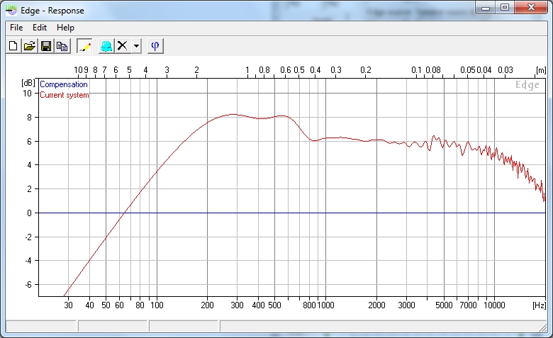

There's perceptible bass (with EQ) using the Boards shown. It's not gut wrenching, but the bassist is there and I can definitely hear if not all the notes being played. I can live with it - others who'd demand a much more deeply toned response would not. The cones barely move, even with the EQ.
I agree with jmpsmash - the HF roll-off suits my ears, which roll off at the top also. In my case, adding a "super-tweeter" wouldnt help - I cant hear those frequencies.

From your "edge response" it looks like the combination (driver + baffle) is rolling off quite well at about 6dB down at 80Hz - perfect for a subwoofer but it'll have to be a good one to avoid colouring the sound - maybe a 'pro-audio' one with a decent plate amp in a B2 chamber (infinite baffle)
… or maybe one of those 'minidsp 2X4HD' units for just the bass driver and a good class AB amp.
