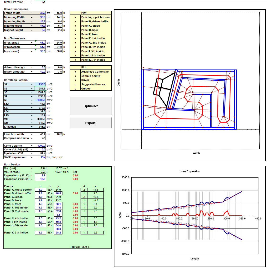

That "Microwrecker" looks like an interesting TH fold. I think I'll put together an optimization workbook for it, similar to what I've done for other TH folds, to make it easier to fiddle around with the dimensions to optimize them for a particular driver. Is it a single or dual expansion TH, and is it all Parabolic expansion? I can adjust the workbook to emulate conical and exponential expansions, but this may not be necessary for what's basically a narrow-bandwidth TH...
Other optimization workbooks here - The Subwoofer DIY Page - Horn Folding
I will be honest though - may favourite "fold" at the moment is the simple offset-driver TL 🙂.
Thanks. I am reasonably pleased with the MW too.
I would have to go and look at things again, but I am pretty sure that it is three parabolic segments.
PM me an email address, I will send you the sketchup files.

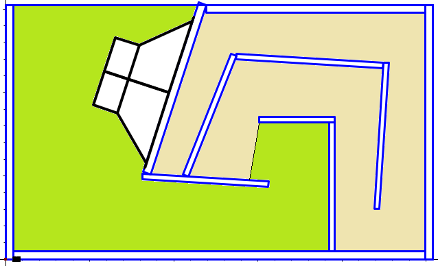

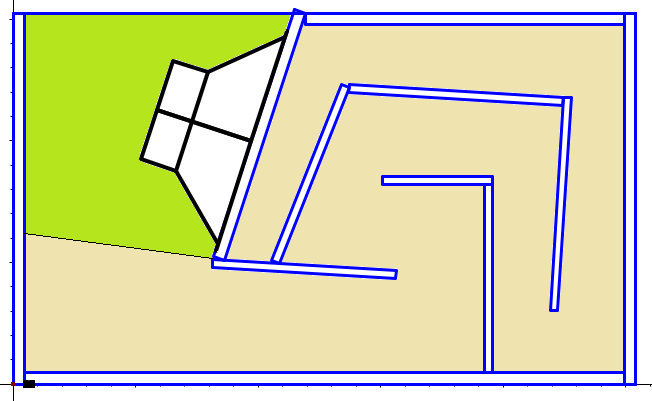

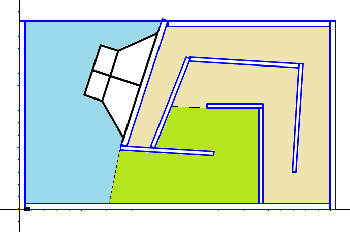

Cool, I can see how the three segments can be located in the TH (see attached diagram). This actually makes things a bit easier, as I might be able to adjust the optimization routine to approximate a full parabolic, conical or exponential expansion through the TH.
Out of curiousity, just let me know the external dimensions and the thickness of the panels that you used for the build. I'm curious to see if the optimization routine comes up with and how it compares to what you designed.
On reflection, it looks like Hornresp can't really model THs that have more than two expansions (S1-S2-S3, and S3-S4-S5), unless you can find a way to mount a driver on a board that has an angle in the middle of where the driver is mounted.
So two choices for the location for S3. The second one looks more interesting to me, as sims have done suggest that it's better when the lengths S3-S5 and S1=S3 are pretty close. I'll see if I can account for both options in the workbook.
