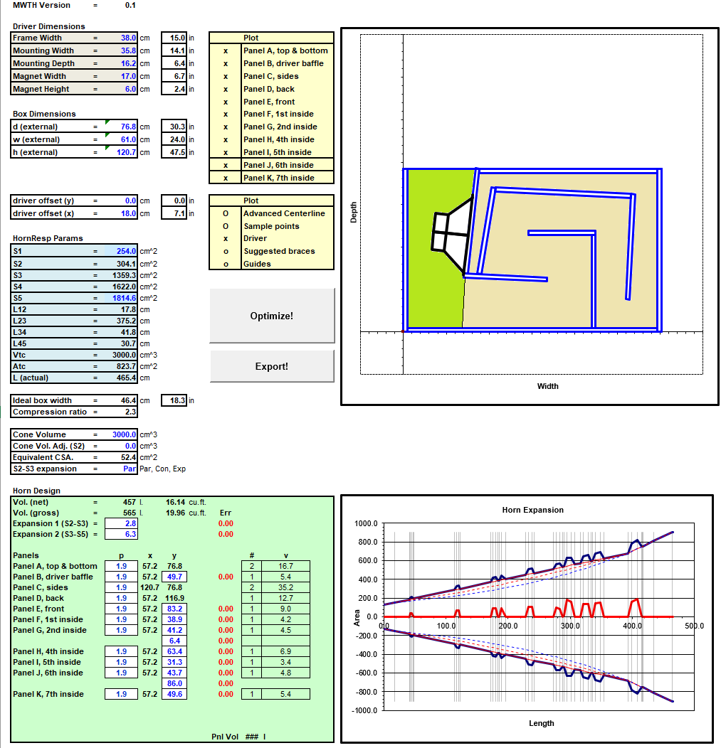

I see the 3l and CSA but the flat board opposite the driver indicates the layout in the throat does not follow the expansion shown.
I'm not seeing that "flat board" that you're talking about in the online drawings that I'm seeing of the "Micro wrecker".

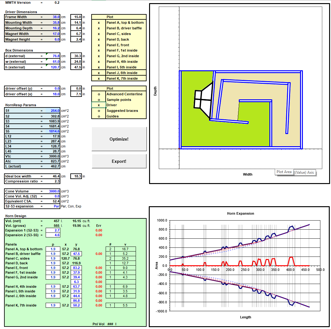

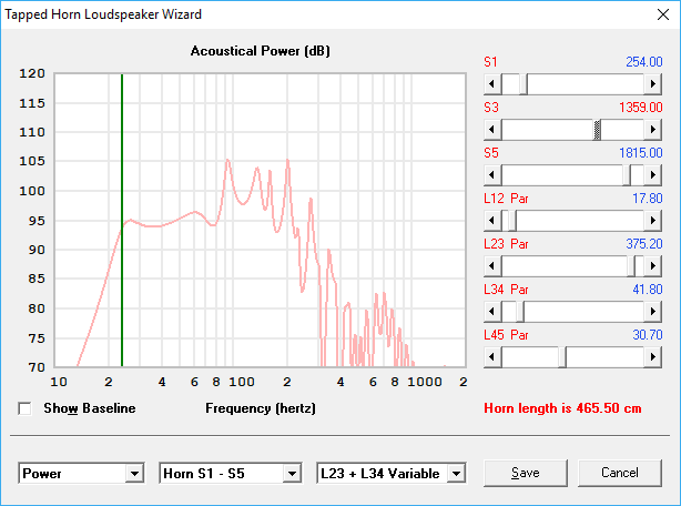

Ok, here's the "optimized" Microwrecker fold, using S3 near the first fold in the TH. The resulting Hornresp parameters are similar, but as close as I would like, to lilMike's sim, suggesting that the Microwrecker actually has S3 a bit further into the horn. I'll have a look at that tomorrow, but the resulting sim suggests that this is a ~24 Hz TH.
Note: the sim doesn't use "Lossy Le" or sem-inductance parameters, and the response of this TH is likely to be significantly impacted by the driver's high Le/Re ratio.

Cool, I can see how the three segments can be located in the TH (see attached diagram). This actually makes things a bit easier, as I might be able to adjust the optimization routine to approximate a full parabolic, conical or exponential expansion through the TH.
Out of curiousity, just let me know the external dimensions and the thickness of the panels that you used for the build. I'm curious to see if the optimization routine comes up with and how it compares to what you designed.
Wow - missed a bunch - sorry.
That first drawing is how I modeled it. I built the test mule with 3/4" nominal plywood (about 0.722 inches), external dimensions were 48" tall, 30.25" deep and 24" wide. Not my best cabinetry, but it did come together pretty quickly.

This is the latest version of my workbook model. Agreement between this and the published Hornresp sim is pretty close. It looks like you took the S3 point a bit further into the horn, but if I do that I think the optimization routine wouldn't be able to come up with a "perfect" solution and the internal panel across from the driver, which also forms part of the third bend in the horn (counting from S1) reflects the first expansion, not the second. In any case the impact on the frequency response of shifting S3 that extra bit is likely to be minimal. The driver's semi-inductance is likely to have a larger impact.
I've got a bit more work to do on the workbook, but one of the advantages of getting it mapped out in an optimization workbook is that it's now easy to try resizing it to see what difference it makes. For example, I was able to downsize the horn a bit to get a 30 Hz tune and smoother passband, particularly with minor stuffing added to the first half of the horn (according to the sim).
Anyway, once I finish getting the workbook to something usable, I'll add it to my site and post about it in the thread I have for these workbooks. It is an interesting fold that offers some advantages over the "SS15/TH115" fold.
