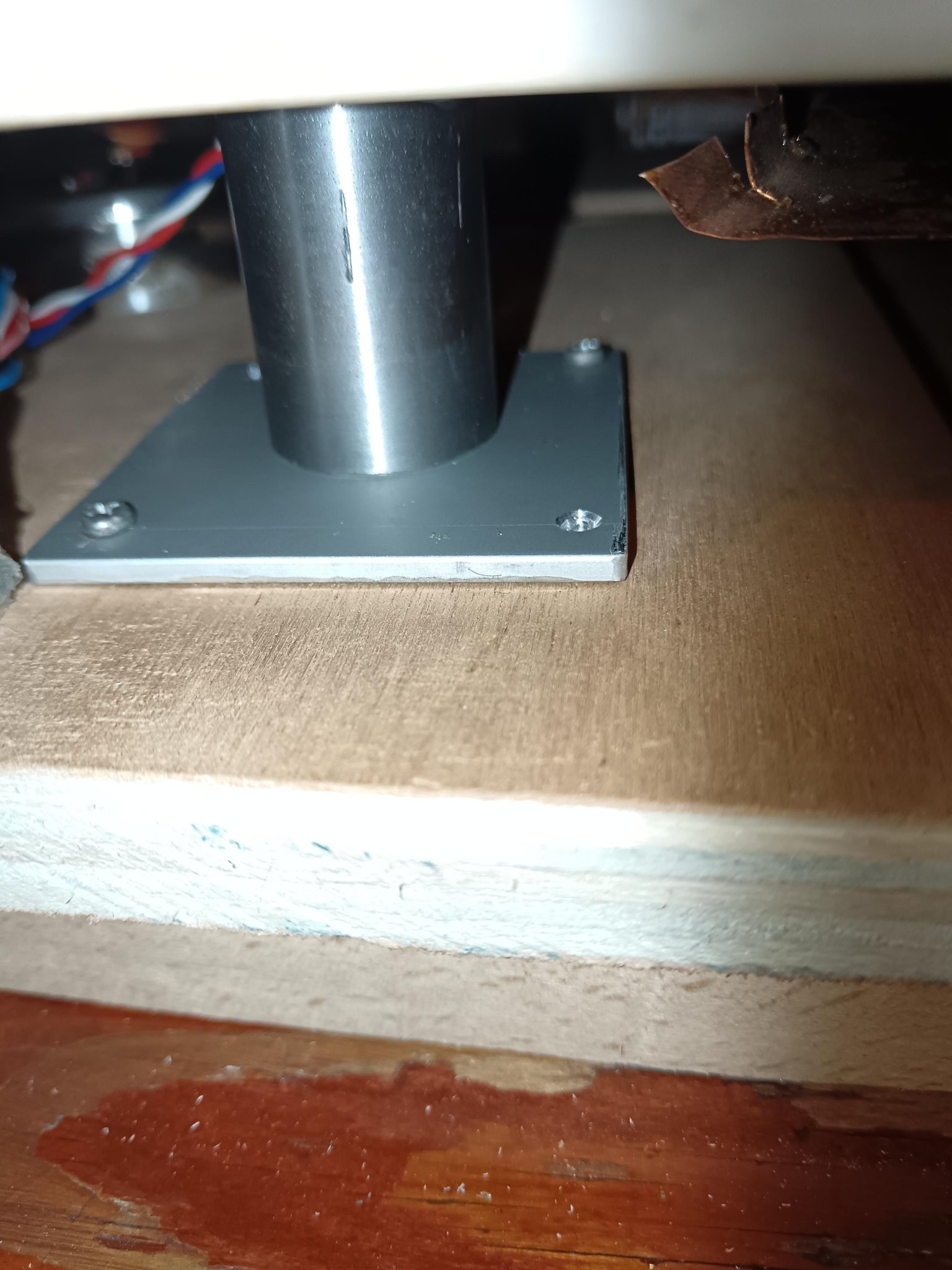

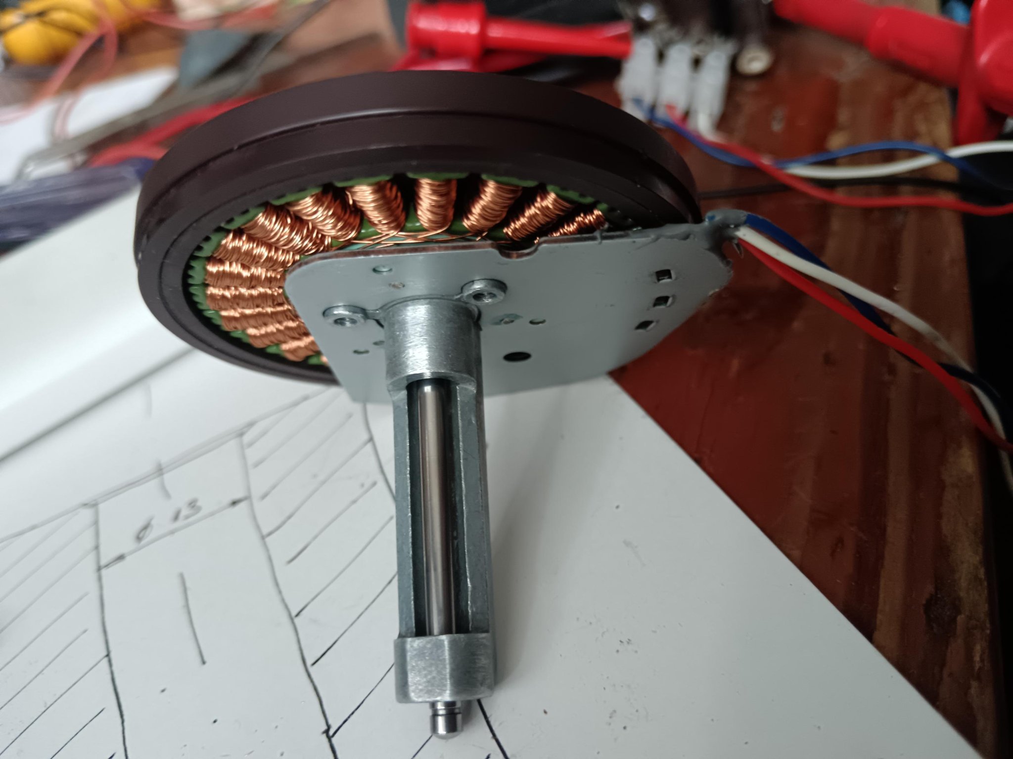

Here is what I did for dressing and mounting of the motor:
Pulley is epoxy glued to rotor (shaft is centered in pulley hole so no worries of eccentricity) and than finished with small nail file as on picture before.
Pulleys I got machined in barrel shape so small misalignment between motor and platter shafts will be compensated, plus it always centers the belt.

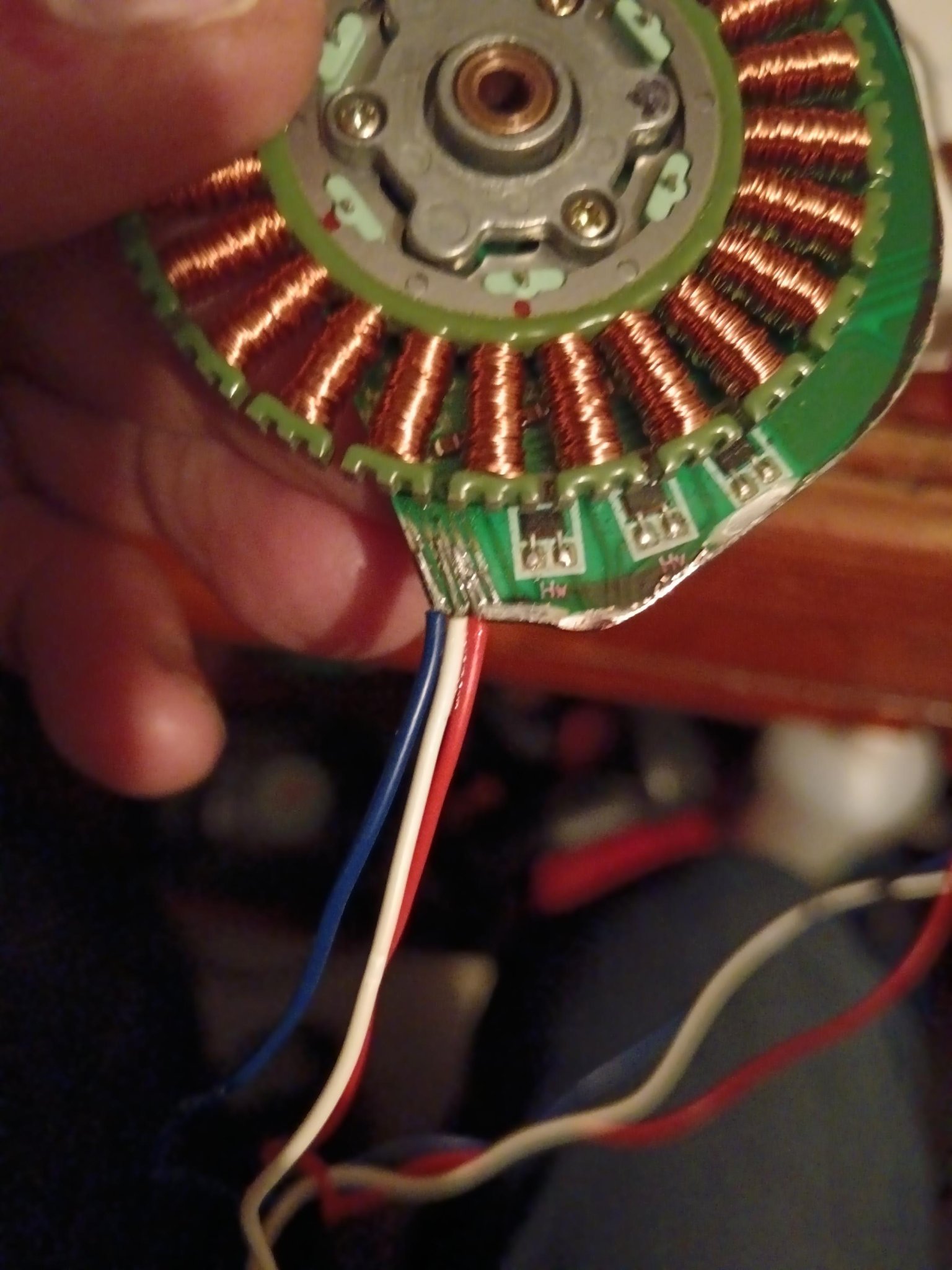

Since this motor has all electronics attached to mounting plate that is PCB at same time, it was necessary to prepare 3 winding contacts to be securely soldered to UVW wires, than I removed rest of pcb with angle grinder to get motor round shape (as needed by my TT design)
UVW wires connection:
Since I don't want to loose these contacts, I sealed 3 wires with liquid metal epoxy, not shown on the picture.

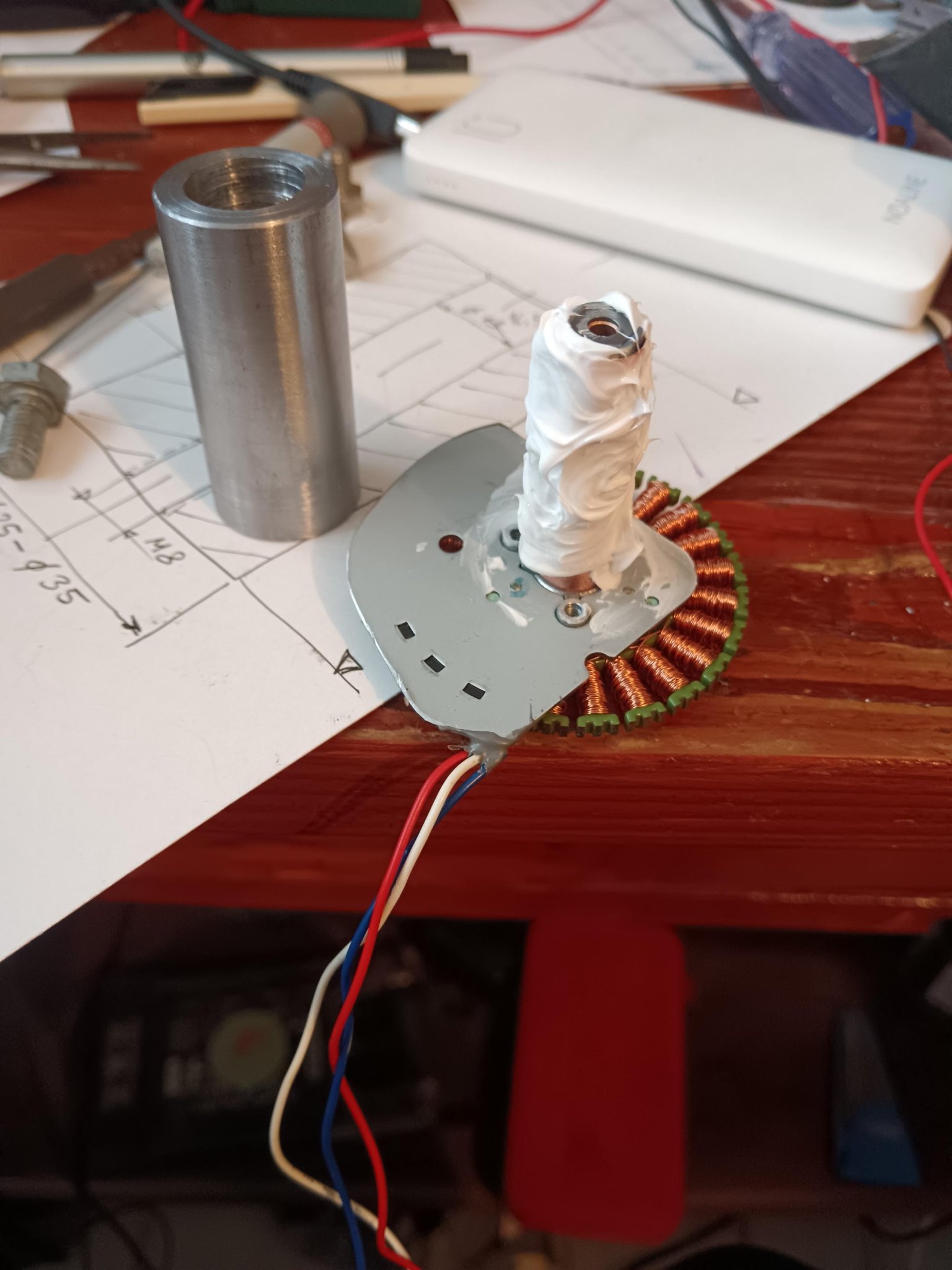

Motor shaft is opened (for contact with pitch roller) and I closed that with piece of copper
Machinist made me an soft steel pipe that has internal D about 2.5 mm larger than bearing housing d.
I filled the gap with common silicone again, and fixed motor . Common silicone I found very elastic, decently dumping and very well keeping shape over long time:
Finally, mounting plate (3mm Al) is fixed on mounting steel pipe by one M8 bolt (thread for which is made in the steel pipe).
Like this bottom bushing of the motor (which is not accessible any more) will be forever swimming in oil, top bushing is accessible (and replaceable) by simply lifting rotor so it can be oiled occasionally.
These motors were originally mounted upside down with open shaft part driving pitch roller. 3 screws (holes for them visible under stator on above pictures) would fix it in VCR chassis. There was no real need for trust bearing as magnet would keep the weight of the rotor, so attention is needed here, to make sure there is trust washer, also not to loose those small pieces when playing.
I have small trust washer between rotor and upper bushing, further adjusted distance with mica insulator for TO3 transistor, hole just fitted shaft diameter.
For me , I think this is coming to the end of story, simple cheap VCR capstan motor is by far better than anything else I experiments with. Next I will finish TT (in May it will be 1 year that i started play, wanna finish before) and later play with fine tuning once accurate W&F measurement method is available.

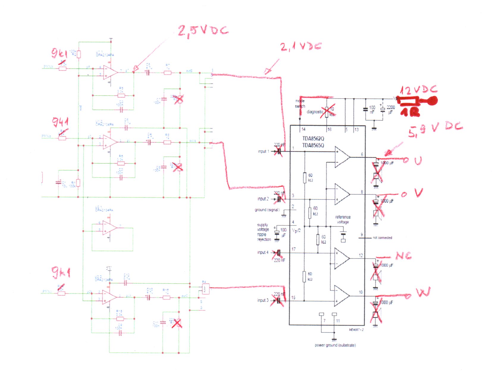

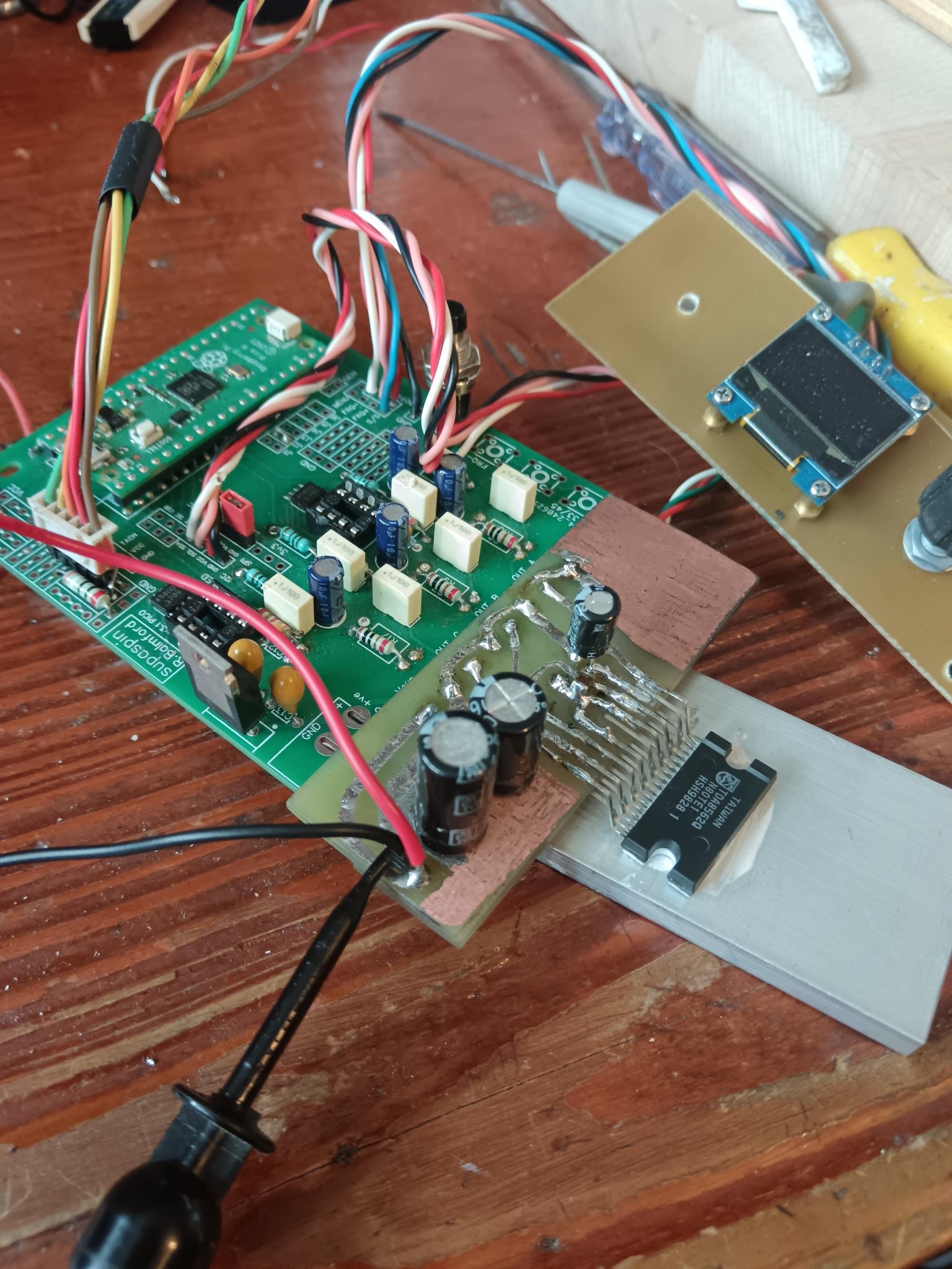

Motor amplifier:
In the meantime I run this capstan motor 24/7 few days, with test rig amp, still all ok and I went ahead with final motor drive solution.
The motor likes (all per phase):
for 33rpm 2.8V RMS @ 0.3A, Supaspin at 70% amplitude
for 45rpm 3.3V RMS @ 0.3A (I listened Pyramids advice and adjusted for constant current), Supaspin at 80% amplitude
Startup at 100% amplitude which is 4 V RMS
4V RMS maximum equals 11.28V p-p, so I have chosen Vps 12VDC. This is very convenient as 1.5A external HDD PS is perfect.
Like this safety earth is not connected via PS avoiding one big potential ground loop.
Here it is important for me to choose lowest VPS that does the job to avoid extra heat inside TT housing. As mentioned before, if amp goes bit into clipping at start up, doesn't matter at all.
For such task, old fashion AB class 4 channel car audio amp is perfect.
Before mentioned L272 power opamp with 0.7A max output current would probably do to, but to much at the edge for power dissipation.
World of caution: some of those 4 channel car chip amps have 2 amps in inverting mode (to ease bridging) , at first I got STA540, that one is like that. Manageable to invert one channel but no need as other chips exist.
Final selection is TDA8562Q, about 6 Euro device. It has 4 equal amps with gain fixed at 20db (10x).
I studied Supaspin output a bit, modified 2 things and came up with this that works very good last 2 days, only 4 components; chip, 2 PS capacitors and Vref capacitor:
I deliberately copied Supaspin and chipamp diagrams to allow comparison, my amendments are in red pen:
1. On Supaspin I changed R3, R4 and R14 to 9k1 to get 400mV at outputs (with gain of x10 it gives me 4VRMS @ 100% amplitude for motor)
2. Removed R9, R10 and R17, they were referencing output DC to GND, I left outputs floating for chipamp as it has its own reference V, Which appears to be 2.1V DC. Since I measured Supaspin DC before capacitor at 2.5VDC I did not reverse capacitors (C4, C5 and C10)
3. On chipamp I did nothing. Outputs are at 5.9VDC with 12VDC PS. DC doesn't matter for motor as its not looking at ground. Max DC offset between 2 channels measured 30mV, motor will not care for that.
4. In addition I added 1R resistor inline with PS for all (this 12V powers amp and supaspin) . I use it to monitor total current without disconnecting wires and it drops VPS to bit above 11V, which is cool. I will keep it in final installation.
Connectivity between SS and amp looks good, the 60k (I think, bit fuzzy) input impedance of amp is right in the ballpark for settling.
Don't forget you can use the recently added 'frequency-dependant-amplitude' feature for a baseline compensation of curent vs frequency - with your 2.8v@33 / 3.3v@45 figures, you're dropping ~15% amplitude from 45->33, so at notional zero frequency the amplitude would be 100% - 15%.45/(45-33) = 43%, so choosing an FDA value of 40% will be pretty close. This would give you a 100% amplitude of 4v@45 / 3.36v@33, and the reduced amplitude value would then be relative to these values. Choosing 80% for each would give 3.2v@45 / 2.7v@33.
