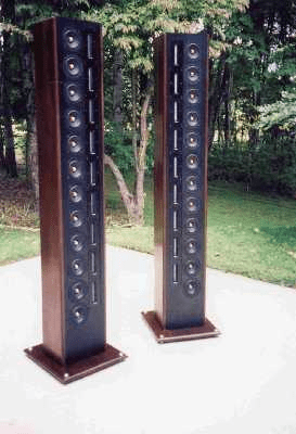

I'm looking into making a line source/Array speaker for my home gym/man cave for 3 main reasons
The room size is small, only 3.2 by 8.5 m and 2.4 m high (so 2300 cuft) so should be easy to 'pressurize'. I currently have a 30" Tuba HT loaded with a 15" RSS390 driver.
The budget would be below 1000 euro (excluding amplification and mini dsp which I already have).
The woofers I'm doubting about the very cheap GRS 4AS-4 which is only 5,8 euro or the more expensive Dayton TCP 115-4 which is 15 euro (about 3 times as much!).
The tweeters is the one I'm doubting most, as they need to be as 'close' together as possible. I would in that case think planar or ribbon tweeters are best as you can mount them without any spacing? Planar is cheaper though, the Dayton PT mini 6 would be 14 euro per piece.
BUT it's only 8 cm high, and I read somewhere I need at least 80cm of tweeters? So that's 140 euro minimum. How long should the tweeter line be, if the speaker line will be about 2.2 m long?
And could I use another tweeter which is cheaper and does the job equally good or better?

All you need to know for an array like that can be found in: https://audioroundtable.com/misc/nflawp.pdf
(including the length of the tweeter line)
As I'm a line array aficionado I'd say: pick the driver you like, as you'll get it back on steroids!
What i mean by that is: if a driver has some faults of it's own, they will get magnified when you use it in an array.

Thanks! I have indeed read this and almost all topics related to it on this forum. There are indeed 2 options, choosing a better full range driver so you can spend the full budget on them (i prefer scanspeak or peerless but they are pricey) or buy sligthly cheaper "mid bass" (mini sub) woofers and tweeters.All you need to know for an array like that can be found in: https://audioroundtable.com/misc/nflawp.pdf

It's cheaper buying the full range ones but all my speakers have tweeters, min 3 way, so not sure I will like the sound. You also have more combing as they are further apart compared to small tweeters, and not sure 1 driver can be as good below as on highs compared to a dedicated driver.
I would buy first 1 driver of each which I consider to test before buying 40 of them, but I can not test how the combing will be, neither te eq effect on a lot of drivers. I will have huge headroom with 40 drivers so should be able to eq a lot of the peaks out...
I'm not trying to sway you towards full range arrays 😀.
I'm just saying: take the best tweeter you like, even if it's a little more expensive.
But first make sure you like what you get. Indeed buy samples...
Measure them and put them into that nifty little program called VituixCAD. I don't regret the time I spend learning that program.
FIR filters would be more practical with arrays. Don't just EQ out all of the peaks, first learn what the array does, and what part
we have to blame the room. EQ above modal range should be speaker correction, not room correction.
A program like VituixCAD can be invaluable for such information. Even though I had 5 years worth of measurements under my belt,
I still learned new stuff just by simulating the array. Highly recommended!

My take on a full range line array is the Modified CBT24 detailed in:
https://www.diyaudio.com/forums/full-range/313352-line-array-modified-cbt24.html
It clicks the near constant sound level in a large room. The arrays are full range drivers that cover above 120 Hz and upward in frequency while subwoofers supply the sound below 120 Hz.
The Modified CBT24 does cost more than your budget but it will satisfy your needs.

If you wish to build a straight full range driver line array, wesayso (Ronald) has a great mega thread for his adventures with an inexpensive driver. See details at:
https://www.diyaudio.com/community/...ers-a-25-driver-full-range-line-array.242171/
Highly recommended with much info and discussion in that thread.
I can not compare your Piega 3 way speakers to a line array as this brand of speakers is not actively sold in the USA.
Both my Modified CBT24 and Ronald's Twin Towers would have have nearly constant volume falloff in your space. Essentially, in the near field they radiate with 3 dB sound falloff per doubling of distance from the source. Your Piega speakers are point sources so they exhibit 6 dB falloff per doubling of distance.
Finally, a well designed (and expensive) 2 way line array tower could sound better than arrays with full range drivers. You still need subwoofers for adequate bass with either design. I designed such a beast once upon a time with Aurum Cantus ribbon tweeters and small woofers with an active DSP crossover. See this photo:
