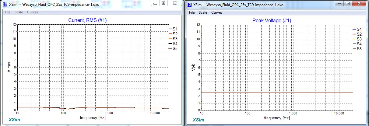

@stardust4ever well I don't know about that...
I had begged BYRTT to supply me his X-Sim simulation so I could check it on a driver level to find out what is happening.
(Yes I am that crazy that I would consider doing a complete re-wire)
If I plot 5 drivers in X-Sim in series I get this:
This is with 10 watt applied to see the graph more clearly.
S1 to S5 are in series and form one of the 5 strings of drivers connected in parallel.

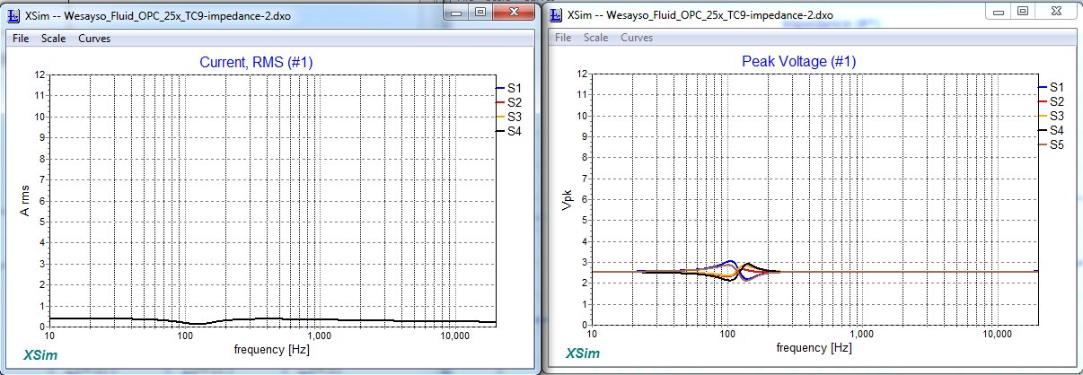

If I do the same plots of Owen's parallel drivers:
Here S1 to S5 are parallel and form one of the strings of drivers in series.
Again 10 watt applied to the complete array.
I think Owen (OPC) might be the brightest one here.

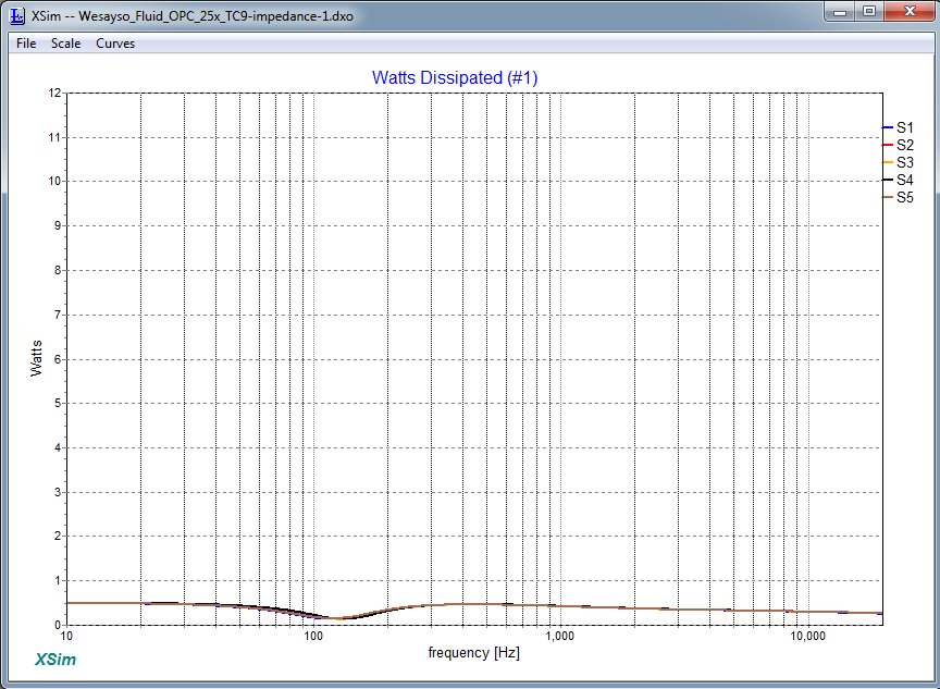

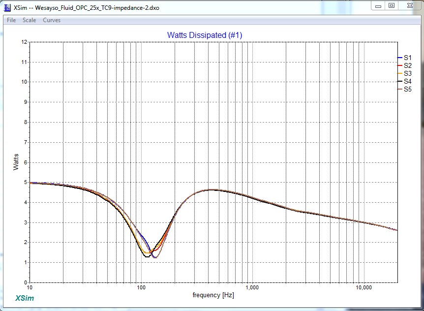

Let's look at the watts for both of these cases:
First in series:
versus in parallel:
This is only a first look but I genuinely think Owen was on to something here.

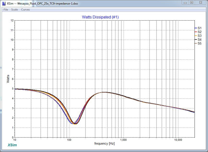

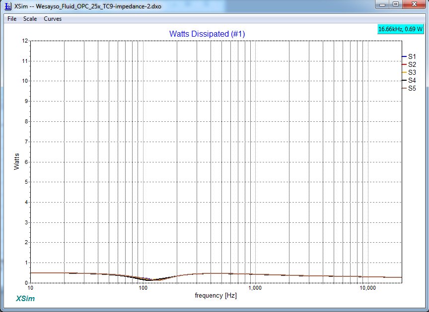

Lets pump up the watts, plot it at 100 watt into the array!
First the series connected drivers:
Then the parallel connected drivers:
Thanks to BYRTT for supplying the sims, to OPC for opening my eyes, to bwaslo for the amazing X-Sim program and fluid for the hospitality on this thread.
