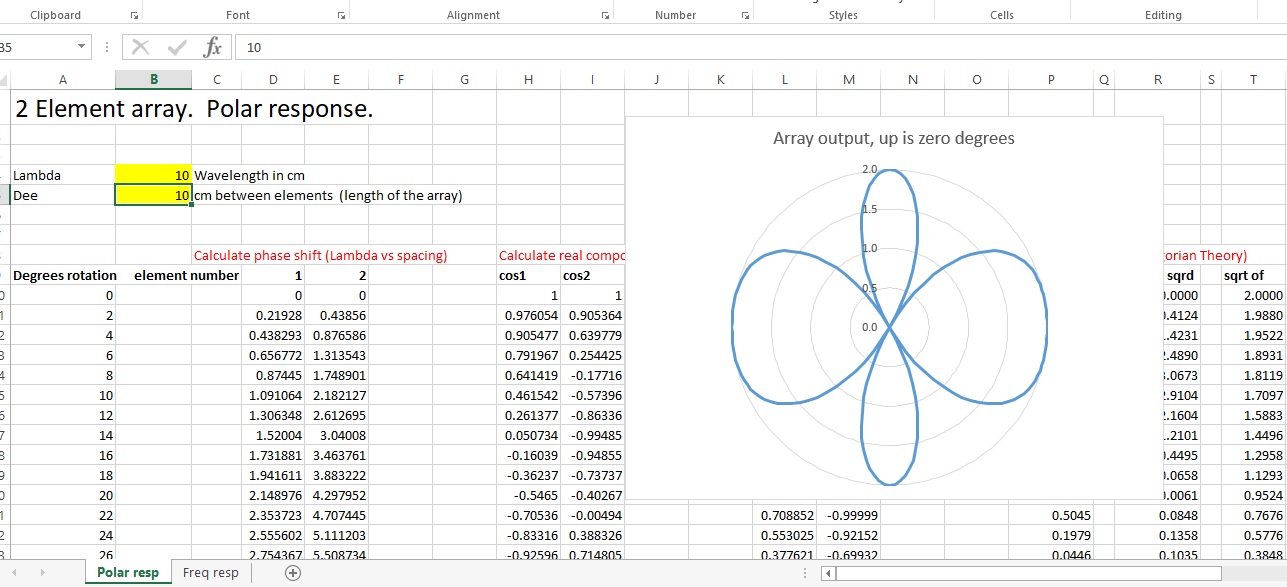

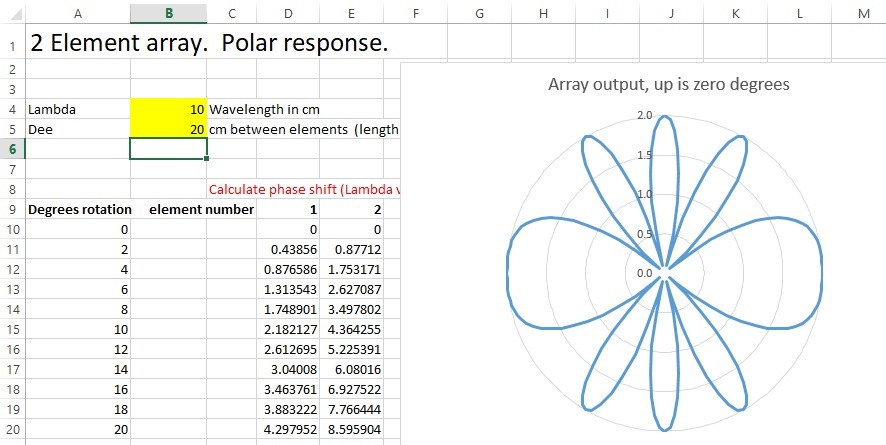

How do we calculate the performance of a line array. The basic array model
Lets say we have the simplest possible line array, 2 elements set some small distance apart. If we stack them in a vertical line and then go out from the elements and upwards so that we are 30 degrees above the elements, then how would we calculate the response of the pair of elements? Or if we want to know the polar response for some frequency, how would we calculate that?
The basic premise of array modeling is that the individual elements can be thought of as vectors that are added in space. They are assumed to be independent of each other (i.e. no mutual coupling or other interactions) but the phase of each element must be taken into account. If we take our geometry and calculate the distance difference as viewed from our 30 degree observation point, take that distance difference and convert it to a phase difference we can predict response. All we have to do is think of the 2 elements as 2 vectors with some relative phase shift between them that we (vectorially) add to get a combined array response.
If you don't remember how to add vectors it is quite simple. Start with a magnitude and phase for each element and then convert to rectangular format (using cosines and sines of the angle) and them add the "real" parts and the "imaginary" parts together. The Pythagorean Theorem will then let us convert that back to a magnitude. Once added we can convert the results to dB if desired. This is really all the spreadsheet does.
I'll confess that I am not Matlab proficient so I like to use excel to set up spreadsheets for any particular array. I've included a 2 element polar curve example. In this example column A gives the viewing angle that steps from 0 to 358 in 2 degree steps. Columns D and E define the actual geometry that defines the excess path length of each element (here only 2 elements). This is the calculation of phase difference between the 2 units. Columns H and J define real part of the radians of delay, L and M the imaginary, and P through T the magnitude of the pythagorean theorum sum. By breaking into real and imaginary parts we can sum any number of vectors as called for by the complexity of our array.
So the desired result is column T that is plotted as an Excel "radar" plot. This is an overhead view of the typical array. Up on the graph is 0 degrees and down is 180. In normal conditions the array directivity would have driver directivity added to it. In fact, if all elements aim in the same direction then total directivity is simply the sum of array related directivity plus driver directivity. So, typically, the front to back directivity is significant. Its never bothered me to see plots with no driver directivity, I just view that as the "second factor".
Note also that the polar plot is a cross sectional view of a solid of rotation. For one wavelength spacing as shown you would have a top like shape with a fat rim and narrower axle. (We can talk about why the rim is fatter later.)
The spreadsheet has 2 fields where you enter a number, one for Lambda (applied wavelength) and the second for "Dee" or distance between elements. Our first check of the array math working right is that when Lambda = Dee then our two units are one wavelength apart and see a full height peak at +-90 degrees. This would make sense in that rotating 2 elements to 90 degrees, with them one wavelength apart, should see them come back into phase. Something that should eventually make sense is that frequency doesn't really matter at all but the relationship between spacing and frequency is key. That is, the array definitions will always have a "Lambda/Dee" factor. Doubling Lambda and Dee at the same time will always return the same polar curve. This is just a way of saying that all arrays are scalable...
Also note that the height of the 4 peaks of our plot are all 2.00, this coming from the value of the in-phase sum of 2 unit vectors.

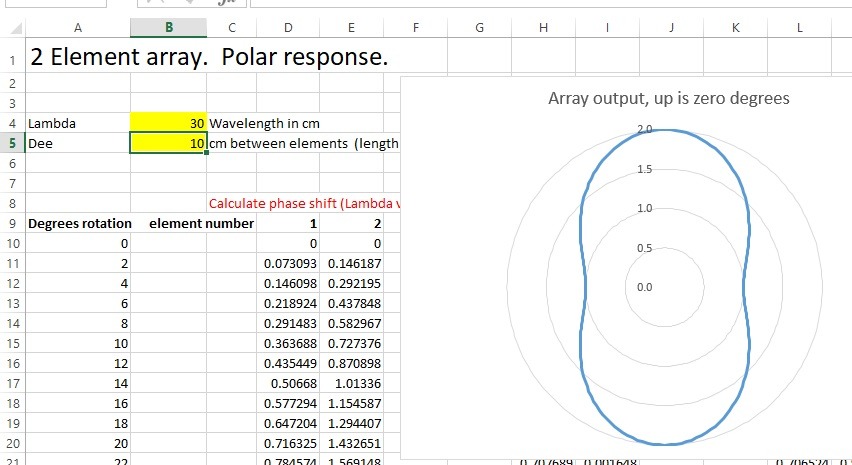

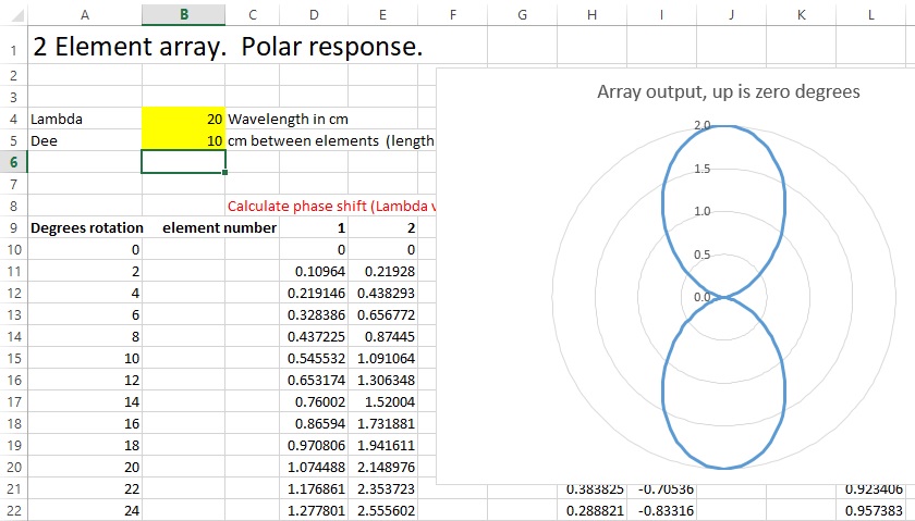

I've attached 4 sims with various ratios between wavelength and physical spacing.
This seems like enough to digest for our first look at array modeling so I'll let that soak in for a while and see if there are any questions or comments.

Hi Neil,Since each driver is radiating into 3D space, the magnitude of each vector will be affected by distance. How does your model account for the inverse square law?
Thats a good question. I will evolve a near-field model and a far-field model. We can start with the far-field model because it is simpler and ignores level shift due to distance.

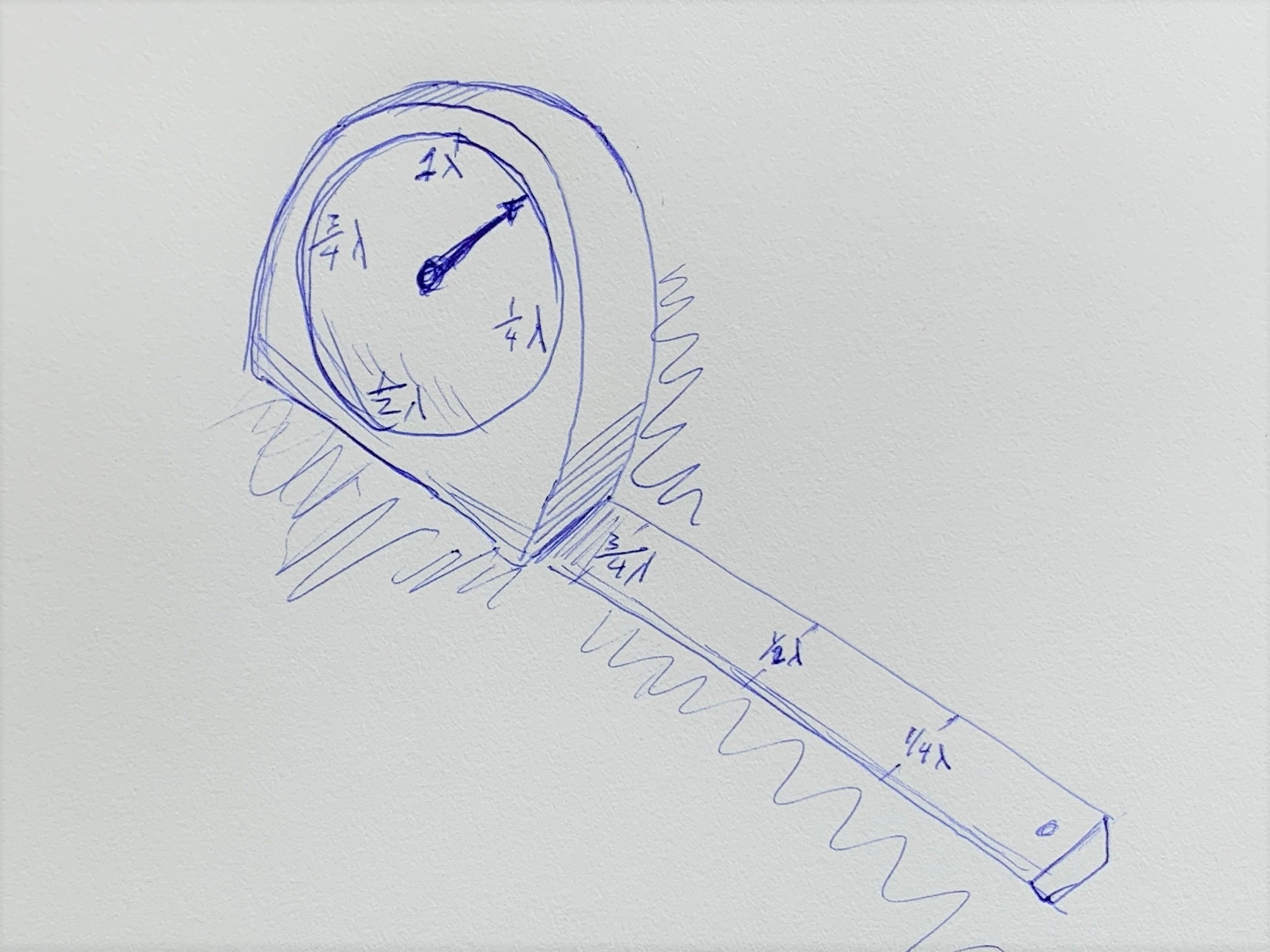

The phase clock tape measure...
I like to imagine each element having a phase clock tied to a tape measure. Picture a tape measure with a dial that rotates once for every wavelength under consideration. (We will need a tape measure for every frequency, could get expensive.) As we pull out the tape measure the dial indicator circles around once for each full wavelength of extension. If we want to see response off at 30 degrees above perpendicular we could pull out the phase clock tape measure to some constant distance in 30 degrees off of broadside. Since we are pulling the tape out to a common plane (the rays are parallel rather than converging, (remember: far field model) then the phase clock will rotate less for the nearer top elements and more for the lower elements. What we want to know is the difference in wavelengths from the 2 elements to some point a ways away. Per above, it is noteworthy that the clock may turn around numerous times but we don't care. We only need to know the partial rotation amount.

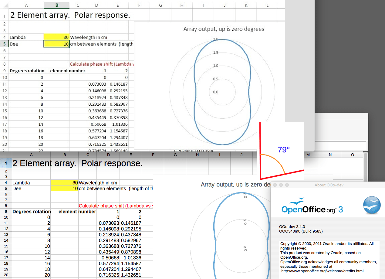

If I am following the instructions correctly the attached Zip folder should have a spreadsheet for the 2 element example.
Could someone try and open it and see if it runs for them? Plug any numbers into the yellow fields and it should recalculate a polar curve or response curve.

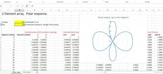

5 element weighted coefficients array
We started with a simple 2 element array to see how 2 loudspeaker units interact and the variation we get as we vary the ratio of their spacing to the applied wavelength. Let's make it a little more interesting with a 5 element array in which we can vary the strength of each element. That will give us a lot of variables to play with.
The latest spreadsheet has both a polar response tab and a frequency response tab. As before you can calculate a polar curve at a given frequency or a frequency response at a given polar angle (are you starting to see the relationship?). In addition, there is a yellow field where you can put in 5 weighting coefficients. I use numbers from 0 to 1 although there is no limit to the range and negative numbers are okay too. Setting a coefficient to 0 is the same as deleting the element. Note that setting any element to less than 0.1 (-20dB) is probably near enough turning it off so there wouldn't be much benefit to paying for that element, might as well leave a gap!
I'm thinking, rather than droning on interminably, it would make more sense to "assign some homework". So here are some problems for you to simulate and comment on. Don't feel you have to answer them all but hopefully you will do a couple and discuss in the forum what it all means...
1) Model a 1, 2, 3, 4 and 5 element array by using the right number of coefficients of 1 (turns on an element) and the right number at 0 (turns off an element). What changes between the 5 options? What doesn't change?
2) If you model a 2 element array, does it matter which columns (E10 through I10) have the "1" coefficients? Can you skip a column between 1s? Why?
3) Experiment with the 5 coefficients until you find what you think offers a nice polar curve. Explain what is good about it.
4) Can you find a good reason to use a negative (reverse polarity) weighting coefficient?
5) Enter the weighting coefficients 0.5, 1, 1, -1, 0.5. What is going on there? Why?
6) For all these examples, what is the relationship between the polar curves and the response curves? Does this suggest anything?
