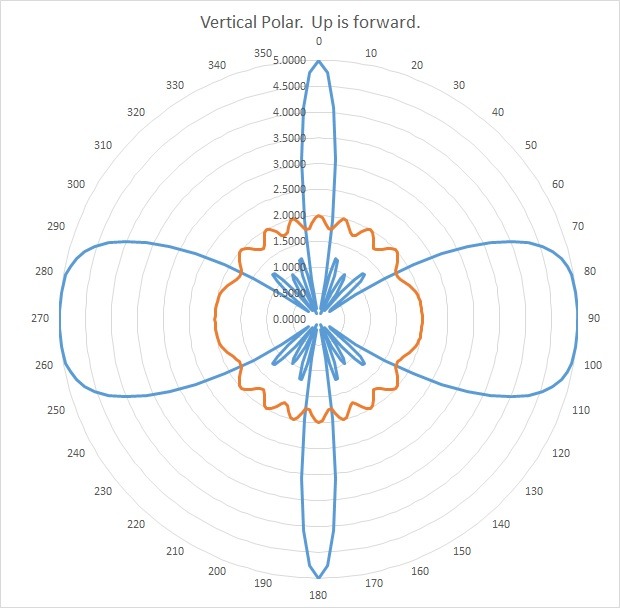

Note that my spreadsheet doesn’t normalize levels (except in plotting), so it reveals the relative gain of an array. So a straight 5 element array has a strength of 5. The Bessel array is a strength of 2, so yes, wasteful.

Bessel weightings vs. straight 5 element array.
Note that the straight array, 5 X 1 adds to a strength of 5 at 0 and 90 degrees. Bessel maxes to 2 = 0.5 + 1 + 1 -1 + 0.5

So in this example, with these "pure vector sources" in the spreadsheet, the Bessel array simply is acting omni vertically.
If it were made up of real drivers, though, with their specific directivity, it would change the results...

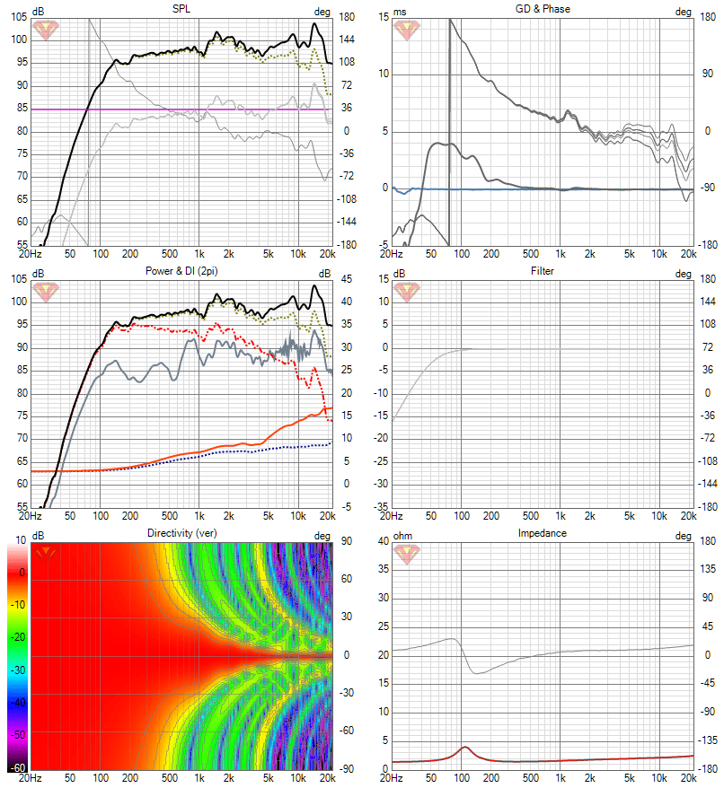

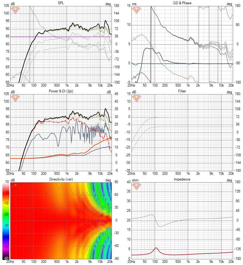

A 5 driver line array with driver directivity of a 3.5" driver (all connected in parallel here)
vs a Bessel array using those same drivers:

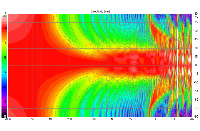

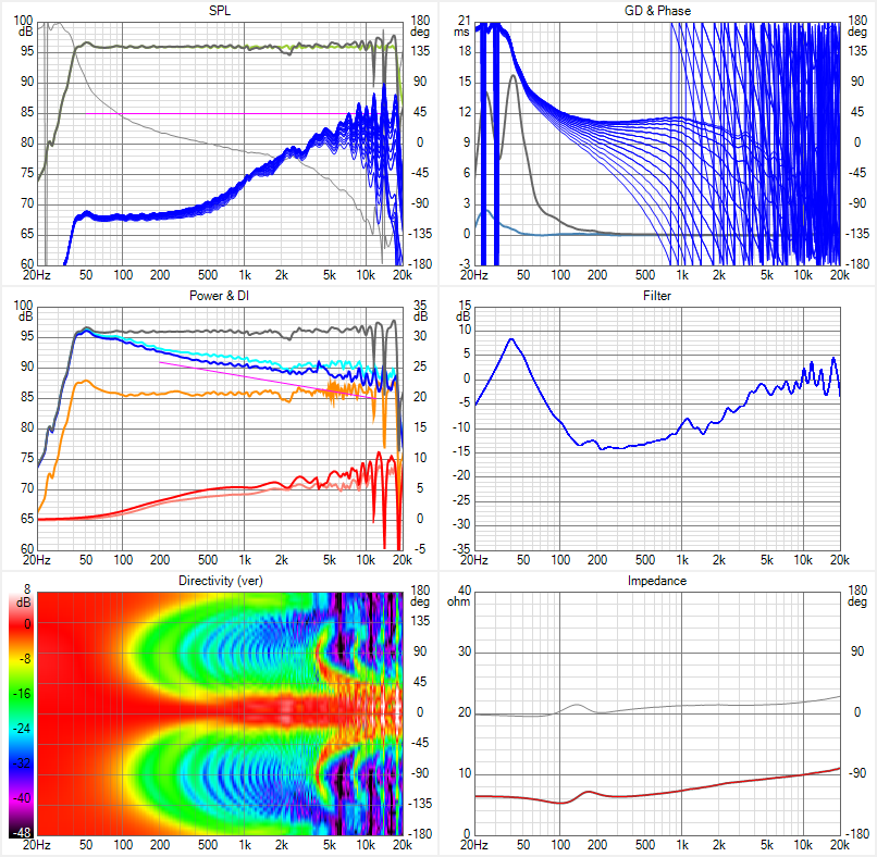

What I had, a 25 driver unshaded line array, looks like this in Vituixcad:

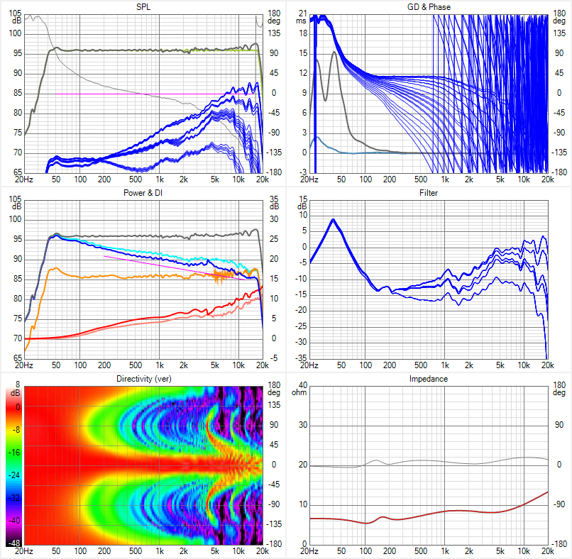

vs the frequency shaded array I have today:
I cannot tell you if this is the actual as build model, as these are old models with the same driver model as the examples posted
earlier on this thread. We later modeled my enclosure in ABEC to fine tune the driver directivity in my case.
Close up of the differences in Directivity of the shaded vs unshaded array:
Main goal of this modification: get the vertical directivity as even as possible over a wide enough area to cover seated + standing height.
Main emphasis on seated listening (the zero line) but wanting acceptable output (FR response) standing up.
As we move up in frequency, the driver group playing full power get's smaller, but as one can see in the middle right diagram above,
they still contribute at a lower level to be able to create the vertical "beam". 5 Drivers (around seated ear height) are kept full range.
