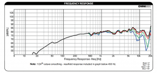

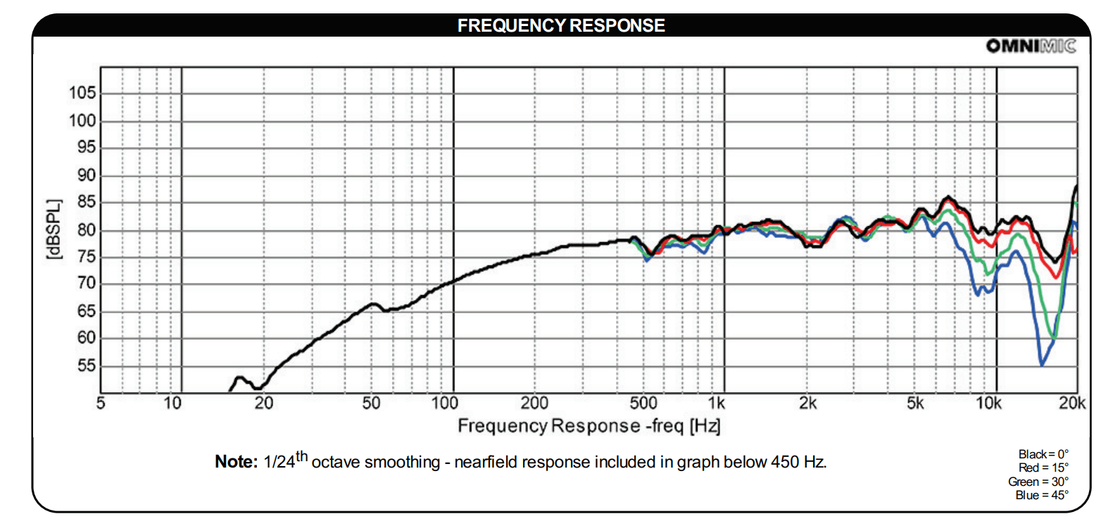

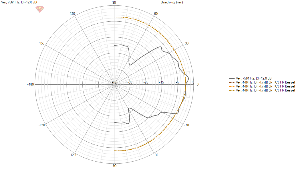

Is this a real driver? The Bessel configuration doesn’t have wider response than the base drivers. It just doesn’t gain directivity as a normal array would.
It's a Dayton ND64-16, but I didn't simulate the narrowing response. Basically I modeled it using only the on-axis data.
Attached is it's polar response

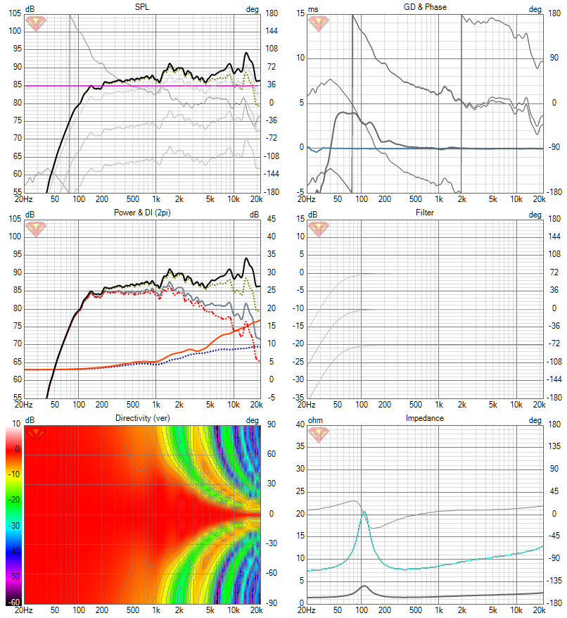

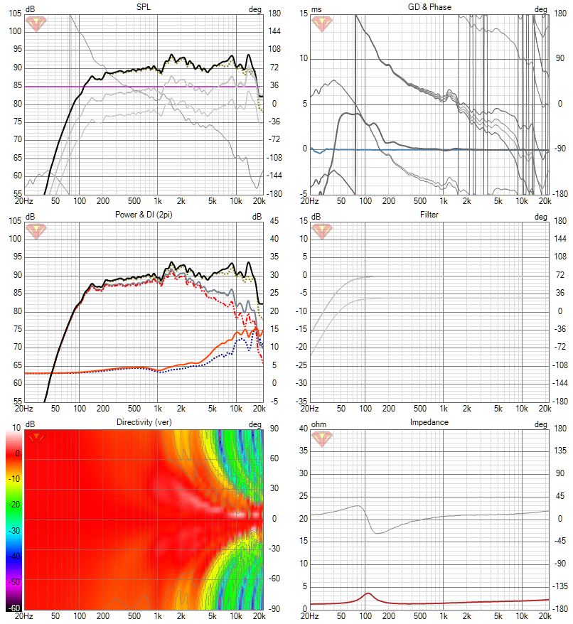

I went outside and measured my ND64-16 on a small baffle to get a set of FRD files.

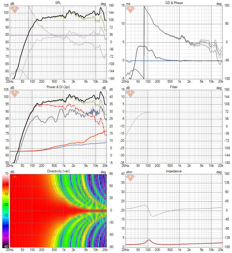

Here's what ONE driver looks like in VituixCad, when we include polar angles 0-45.
Here's what the 5x5 Bessel Array looks like, when simulated with the polar response of the elements included, at a distance of four meters.
Here's what the 5x5 Bessel Array looks like, when simulated with the polar response of the elements included, at a distance of two meters.
Here's some things to keep in mind with these sims:
I used a baffle that measures 40cm x 40cm. Way too small for a proper measurement. So I think the response above 4000Hz or so is accurate, but I'd take everything below it with a grain of salt. I purely made these measurements and did these sims to see what the impact of driver beaming is on the overall response and performance of the array.
![ZOk0Aju.png](https://i.imgur.com/ZOk0Aju.png)

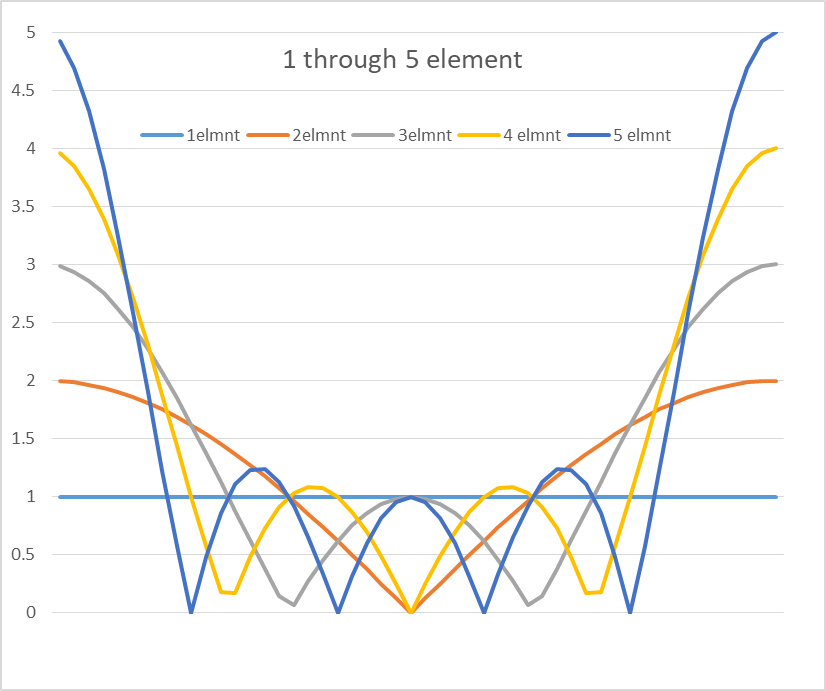

Getting back to the 5 element spreadsheet. There are a few things to observe.
If we just use rectangular weighting (each element a strength of 1) then we see a sharper beamwidth as we go up in the number of array elements. There are also n - 1 nulls if we plot one cycle of response (this is essentially a plot from DC to 2 x Nyquist. The "one cycle" requirement is satisfied by observing at a 30 degree angle with a Lambda of 5 cm and a Dee of 10 (more importantly, any 1 to 2 ratio for Lambda to Dee). The 30 degree angle has a sine of 0.5 which cuts the 1 to 2 ratio down to 1 to 1, giving one cycle of plot. (Does that make sense to anyone?)
Here is a look at playing with coefficient weightings. The blue curve is just the straight 1 1 1 1 1 weighting. Orange is 0.3 0.7 1.0 0.7 0.3 so it rolls off the outer units a little and gives a little wider bandwidth and a smoother polar at the cost of some level output. Lobe output is the sum of the coefficients so 3 rather than 5 for the rectangular (in this plot the forward response levels are roughly normalized).
The gray plot uses a little bit of negative weighting for the outer 2 elements. -0.1 0.3 1 0.3 -0.1. This really broadens the front lobe, again at the cost of level.
Of course, these only represent the polar curve up to a certain frequency and after that side lobes will form and swing towards the front (aliasing in our DFT analogy.)

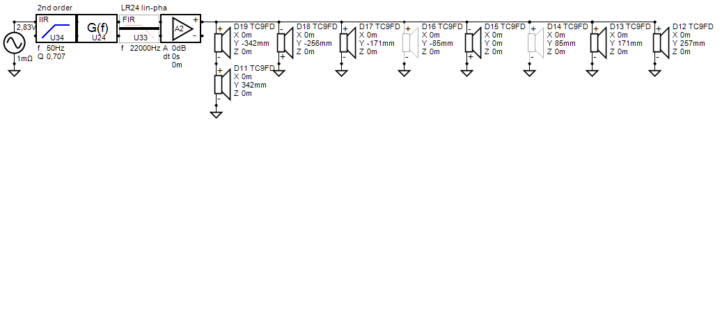

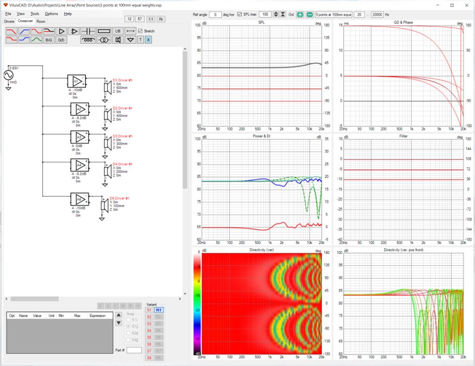

I was intrigued by the gray weights so I entered them into Vituix and looked at response vs distance and the power response curve. the two dashed overlays in the central graph are axial responses at 2m and 4m. The rest of the curves are at 8m. At 80m and 800m, the power response smooths out but I listen to my line arrays at 4m
The Vituix model has 100 mm spacing between drivers. I've linked no directivity files so I get the omni response of point sources.

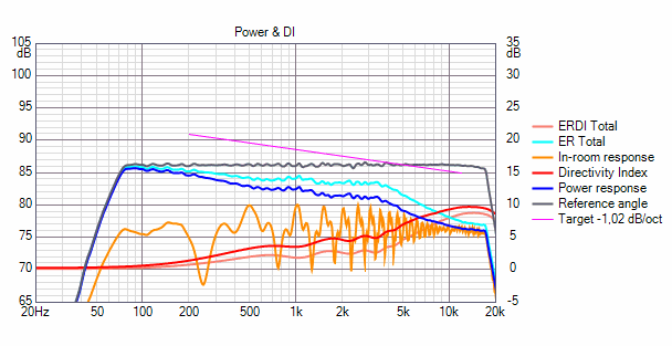

If we compare the frequency response of a single driver in a room with floor and ceiling reflections factored in,
with an array consisting of the same drivers with the same reflective settings for the floor and ceiling reflections:
Look at the orange "in room" prediction that shows the effect of the floor and ceiling reflections. (*)
One is an array of drivers, the other is a single driver (with similar enough directivity as a Bessel array).
Tell me why you'd want to pay for so many drivers, for very little increase of gain and this kind of directivity.
It may be me, but one of the main advantages of arrays for me is what it does differently from a single driver, not what it does similar.
I want to keep the increase in gain, as well as the way it works with floor and ceiling reflections in a real room.
Others may see it different though. But I haven't seen that many (large) Bessel arrays being tried out, and I'm not surprised by that.
(*) While it may look pretty wild, it's what actually happens in our rooms. It isn't a good representative of what we hear or how we perceive it, but it is happening, in real spaces. If we would apply smoothing, it would look way better

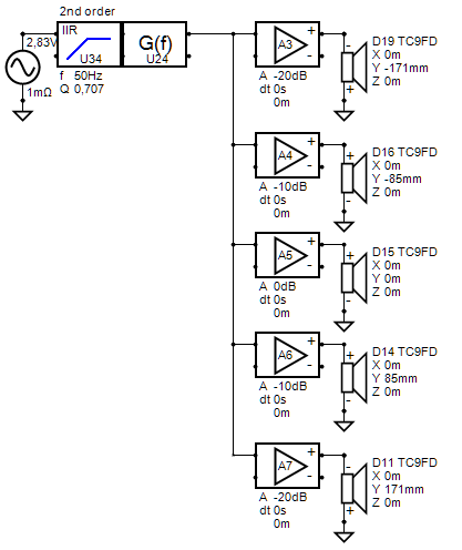

My weights are linear and only first and fifth are negative.
-0.1 +0.3 1.0 +0.3 -0.1
In dB
-20 -10 0 -10 -20. DB plus polarity of 1 and 5 flipped.
The above example with a 3.5" driver model:
Compared to 5 drivers ran at full power:
Worth it to widen the top end, but we do loose a lot of gain to get there.

Here's a 9 driver Bessel (which ends up using 7 drivers)
