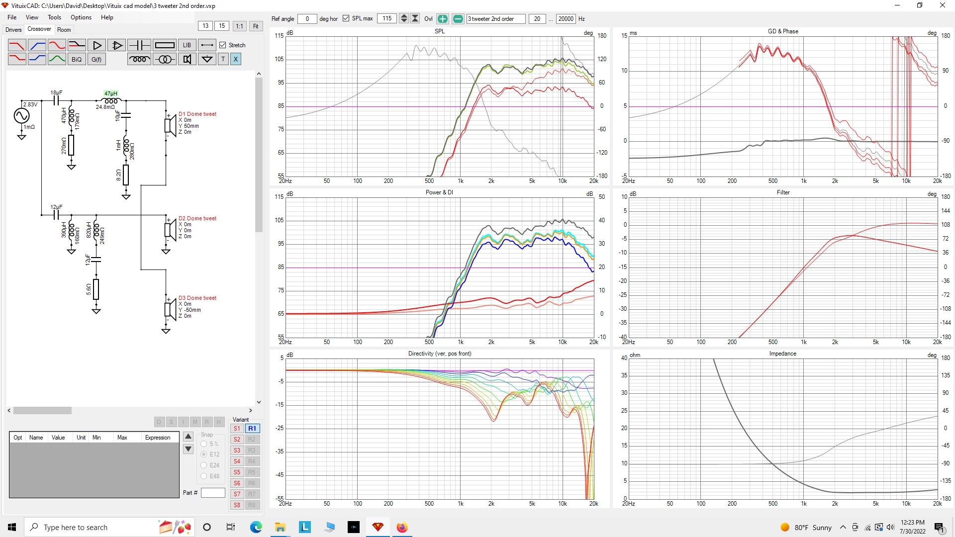

As a first stab I just did a 3 tweeter array, with the goal to achieve moderate directivity with as little lobing as possible. (Such as a THX array I did at Mac and Snell.) I've got fairly constant directivity and just a hint of vertical lobing with the usuall approach of 3 tweeters tightly packed with the outter two rolled off. You have to be careful to gradually roll off the outer two to prevent excess phase shift from messing things up.
Just a work in progress.

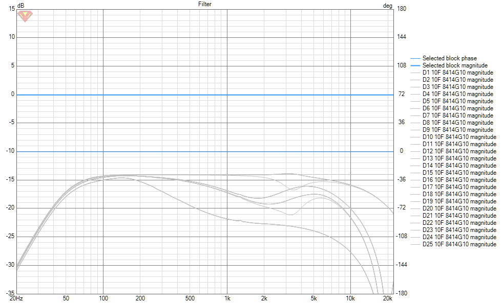

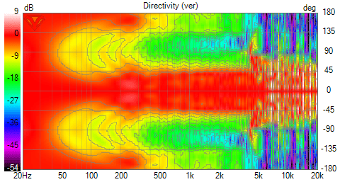

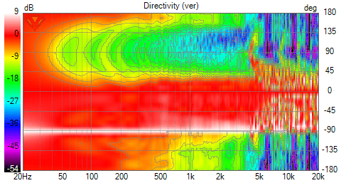

A comparison of the vertical directivity of the original unshaded array vs the frequency shaded array (25 drivers, 85,5mm CTC):
The effects of the filters I applied in a single graph (after removing overall EQ):
The drivers are divided in groups of 5 drivers, one group has no filters (moving straight just above -36), all other groups are filtered, with the first
group around the 5 unfiltered drivers divided in 3 below, and two on top. That's why you see another small division at ~3 KHz, as I've put notch
filters on the third driver to get more symmetry or balance in my results. The lowest line is the power the top 5 drivers get. They do most of their
work on the bottom end. You'll see the difference in the unshaded array center (0 - position shifting) vs the shaded array.
The filters used in one array, including two notch filters. Not included in this picture are some tweaks on the top end capacitor values I've
changed after changing my drivers from the Vifa/Peerless TC9 FD18-08 towards the Scan Speak 10F 8414 G10.

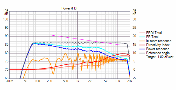

That's a slightly different point of view than what I have had, when going for arrays. My goal from the start was to diminish the floor and ceiling bounce.
Having multiple drivers in a long array helps in that regard. As it achieves very smooth vertical response, with minimum frequency response variation
when measured inside a room with floor and ceiling reflections present.
Look at the orange in-room predictions between a single driver vs array... That's my specific goal of using arrays.
They are quite unique in that behavior. Their biggest enemy left are parallel planes. Take care of that and they can be
loud and clear.

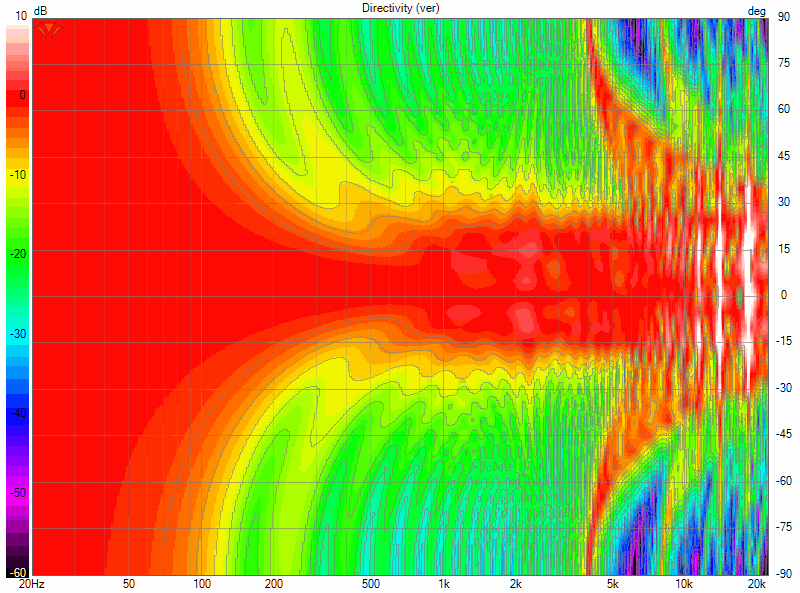

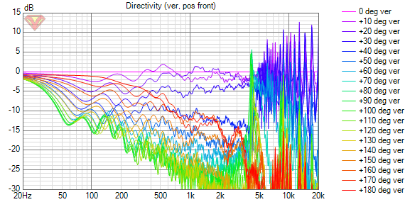

I definitely want to see more about your expanding arrays but going back to line arrays for a moment, here are vertical polar map and vertical line chart up to 45 degrees off axis for a 75xLineArray where the top and bottom 25 drivers model floor and ceiling image drivers. Here we see the wide vertical directivity we experience with floor to ceiling arrays in our homes
Reactions: wesayso

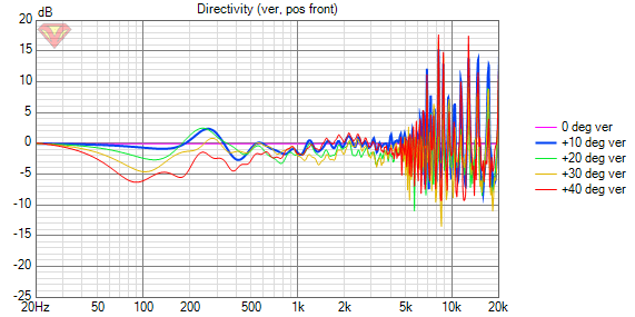

My previous post was response at Y=0, the virtual floor. Here is the response measured and equalized at 1m above the virtual floor; still a wide vertical beam.
