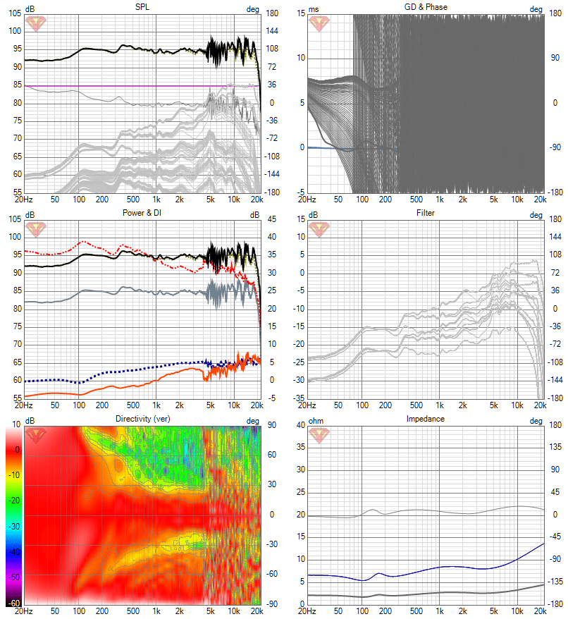

I did the model by instantiating 75 drivers at a uniform 84 mm spacing for an extent of 3x 2.1m. That is a little bit low for anything but a basement ceiling I suppose. This puts the floor at array center, y = 0. I then set a driver offset of -1000mm. Lowering the drivers by 1m is equivalent to raising the mic 1m above the floor. No gaps at floor or ceiling or modelled. The easiest way to do this would be by muting drivers symmetrically spaced about the floor or ceiling. I modelled 2 db attenuation on floor and ceiling image drivers. My 75x TC9 line array model is attached for what it is worth. Lots of room for refinement in it. I was merely seeking an explanation for the difference between the observed vertical directivity and what simulation predicts without taking floor and ceiling reflections into account.

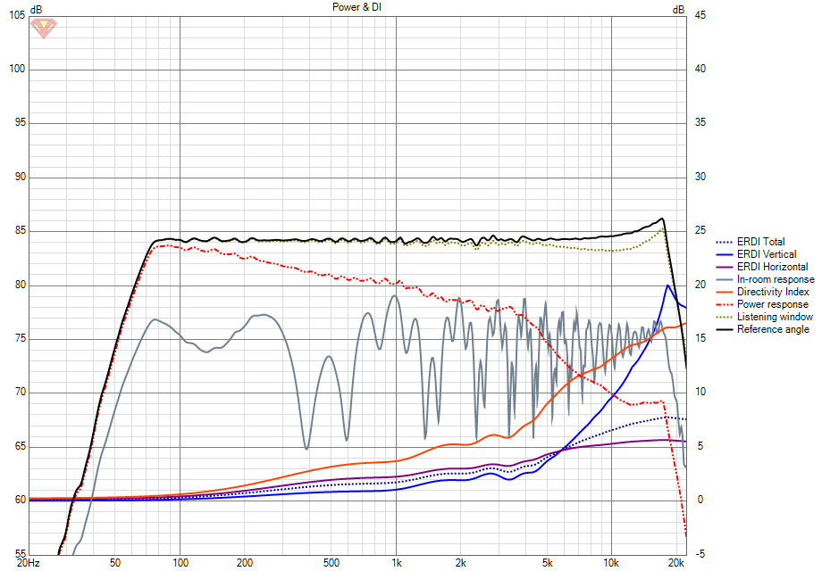

Vituixcad can present these numbers according to ANSI-CTA-2034-A, in all honesty I used 5 degree steps and a measurement
distance of 2.7 m instead of the pré-defined 10 degree and 2.0 meter. As that's the listening distance that I've used to optimize
my array results.
I wouldn't put my speaker on a Klippel and expect to see the right data come out either
be optimized to make use of the room to perform a little better and get these results. That's the whole idea. While it would be a
challenge to get that performance all the way up to the high frequencies (due to lobing), the difference I show here is just the
difference between a single 3.5" driver at 1 m height, measured at at 2.7 m listening distance, compared to an array of 25 drivers
at the same listening distance with regards to what floor and ceiling reflections do to it's frequency curve. It is clear that the array
has a slightly higher, almost similar level of reflections on the top end from about 5K up, while the array has less influence from
reflections below it.

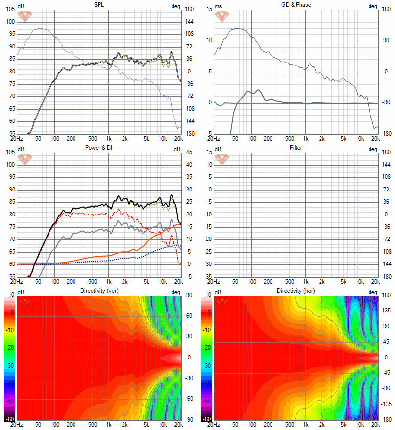

The single driver with floor and ceiling reflections set to -6 dB:
showing the calculated ERDI of both vertical and horizontal planes.
Compared to the array of 25 drivers with the exact same settings:
Basically, what is happening is that the drivers in the array average out each other's (position dependent) reflections. More drivers means
more different driver positions with regards to averaging these results. That comes with the warning that parallel planes and ridges have
about the same distance between the plane/ridge and driver from a listening point view. So there we get no averaging out off the
reflections in those cases.

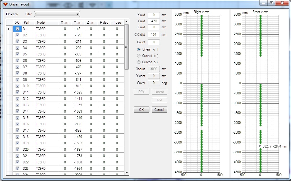

nc535 said:Vituix doesn't allow a driver offset of more than 1m so I can't see what the response is beyond the edge of the main array
Vituix will let you move it 1m if you choose relocate. It will move the drivers in the table of driver layout (permanently).
After that you can move up to 1m all over again. Press relocate again if you want to go past 2m
Here I moved up 2m24 to go above my main array height:
Top driver confirmed at -43mm (ceiling above that, floor below):

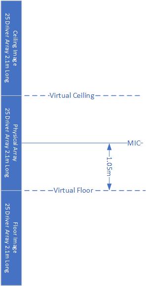

I'm not fully following the model but would make a couple of comments about floor and ceiling bounce. When I did a sim it was a pretty simple overall model. I was looking at an array in anechoic space. Too that I could add an array below and an array above in anechoic space but representing the floor and ceiling reflected virtual systems. I put in a typical painted drywall and carpet reflection coefficient to realistically attenuate the floor and ceiling bounce. I didn't feel that adding any other secondary reflections would be needed.
You wouldn't want to model the upper and lower arrays in addition to having some floor or ceiling bounce in your model as you would be doubling up on the floor and ceiling aspects.
Since Vituix seems to do a good room model I was expecting to see a large array create an extreme directivity index. Roughly I would expect doubling the number of elements to always give 6 dB more at the listener position but only 3 dB more in total power radiation. So if we go from 1 to 2 to 4 to 8 to 16 to 32 elements, you would have 5 instances of increasing di by 3 dB. That means 15dB d.i. relative to a single driver if we can assume that all drivers add in phase for the listener (not true for all frequencies...) Are any of the sims showing a corresponding increase in d.i.?
This is generally where the direct to reflected ratio improvement comes from.
My model corresponds to what you describe in your first paragraph. Floor and ceiling reflections are disabled as they are replaced by the image drivers. My reflection coefficients were -2 db which is a round up of the 1.5 db I've heard is appropriate for dry wall. Listening distance was 4m which is less than the line length and thus nearfield. (Is that right? I forgot the nearfield/farfield criterion but I recall it was related to line length)
The floor to ceiling array between reflective floor and ceiling approximates an infinite array. An infinite array has no directivity - its response is the same everywhere along the line. So the longer the array and the more orders of floor and ceiling reflections included in the simulated response, the better it approximates an infinite array and thus the less directivity we will see in the simulation.
I did see the increasing DI and response levels going from 25 to 50 to 75 drives but only for LFs. The effect decreased with frequency and was gone by 200 Hz. I guess the closeness of the approximation to infinite length varies with wavelength. Clearly all drivers don't add in phase at all frequencies. That may be a useful approximation at LF and definitely loses utility by the time we see combing, if not before.

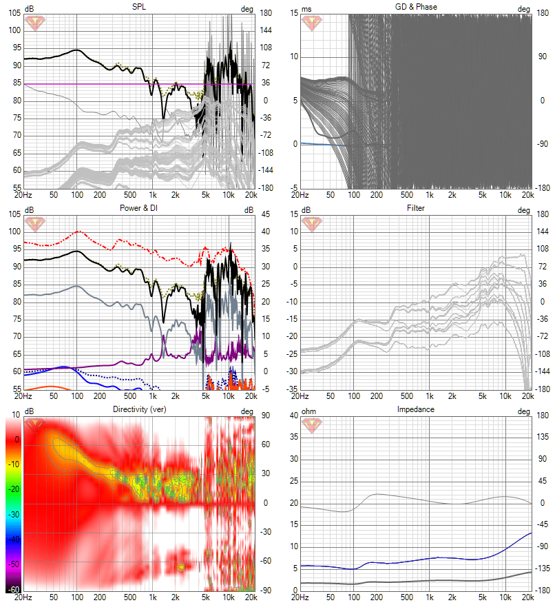

In all models I've shown here, EQ is being used to straighten the frequency response in room. Just as it is used in real life.
If I find the time I can make a one speaker model without EQ, 25 unshaded drivers without EQ and 25 drivers with their floor
and ceiling reflections without EQ. That should show the increase that is happening in these 25 driver arrays.
In fact, in the Vituix models one can see the EQ applied, which shows in the right middle window:
As you can see, in this example about 14 dB is shaved off at 200 Hz. In real life I shave about 10 dB off at the max output
around 200-250 Hz and use boost on the top and bottom end. Similar to what was done by Roger Russell on the IDS-25,
with the difference that these days we don't use an analog equalizer but do it with FIR processing based on in-room

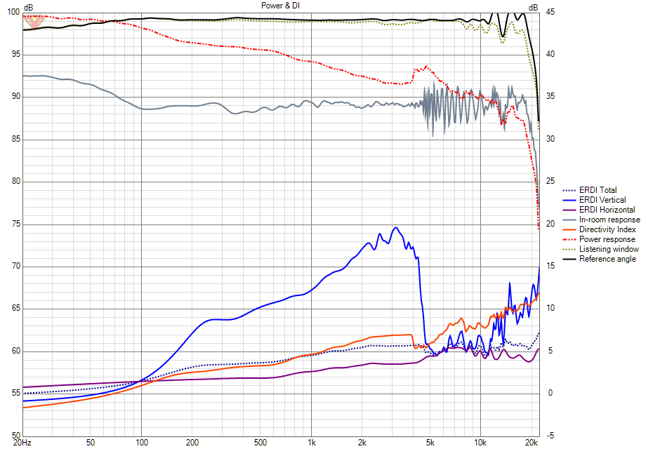

I did find the time to create the model for the unshaded TC9, first one driver, next up an array of 25 drivers and last but not least,
the 25 driver array with it's floor and ceiling reflection. I've kept the damping of floor and ceiling at -6 dB, as that has been used
in all my previous simulations that I've shown. I think I once checked the level that came closest to reality when comparing to real
measurements, which was a 4 dB drop but the differences between that and this picture are negligible. Lots of pictures I've shown
in this thread were old experiments I had on my harddrive, in those sims I clearly played a lot with the 6 dB reduction
As can be seen, there is a hinge point at 5 KHz where the single driver and the array have an near equal SPL level.
At about 250 Hz we see an increase of about 13 dB. This corresponds with theory. above it we see the ~3 dB drop per
octave that is predicted in the line theory. Above 5 KHz, where combing and lobing takes it's toll it isn't any more efficient
than a single driver. However, each driver in the line only gets a fraction of the total power compared to the single driver.
Due to that reduction, it can handle higher total power which creates headroom for some EQ.
As soon as the floor and ceiling mirrors are added (with my room dimensions, ceiling being almost 3 m high after a
recent remodeling) we see an increase of 4 dB at 20 Hz, but not much more elsewhere. Up until 5 KHz hardly anything
changes, and above that we get the effects of the lobing that creates the early floor and ceiling reflections. It's clear that
the gaps between the array and floor (which makes the distance to it's mirror driver about 300mm instead of the CTC of
the array of 85.5mm) and the even larger gap between the top driver of the array and the ceiling mirror (almost 1.5 meter)
create enough discrepancy to interrupt a further increase.

Yes, I guess there would be 3 zones of operation. For lowest frequencies the elements would all add in phase but the "more gain on axis" part goes away. If the elements are physically close to each other (wavelenghts are long) then the 6 dB gain from doubling elements occurs in all directions and no directivity increase happens.I did see the increasing DI and response levels going from 25 to 50 to 75 drives but only for LFs. The effect decreased with frequency and was gone by 200 Hz. I guess the closeness of the approximation to infinite length varies with wavelength. Clearly all drivers don't add in phase at all frequencies. That may be a useful approximation at LF and definitely loses utility by the time we see combing, if not before.
In the second group of frequencies there is a 6dB gain on axis but only an average of 3 dB elsewhere so increased d.i. is assumed. At frequencies still farther up the nearfield effect takes over and outermost elements of the array will not be adding in phase. I showed this in my paper as draw away curves from the center of a longer array and you could see a periodic ripple in level that persisted until the top and bottom most elements were largely in phase. From that distance out the array is no longer "long" and response starts to drop 6 dB per distance doubling where before it had been 3. There is a diagram in the paper that should make that clear.
I used to have a lower metal ceiling (aluminum) below the old original gypsum ceiling. I don't know what is worse, the
higher ceiling I have now or that metal ringing while taking measurements.
Your sims are starting to make more sense to me. Very constant directivity for the array from 200 on up. Spacing related aliasing at 4kHz. Not a huge benefit from adding the floor and ceiling bounce (although they are there in reality).
I'm still kind of hung up on expecting a big d.i. increase. The hinge point at 5kHz is again the frequency where the ends of the array are enough farther away to shift into random phase adding so you lose a little level in spite of the multiple elements. This is a nearfield phenom. while in the far field all elements add in phase for a straight array. The comb filter above 8k is the same poor adding from the ends of the array. This is the cause of the "sis sis sis sis" effect from raising or lowering your observation point that I notice on the Mac arrays, at least on pink noise.
Seeing the huge low/mid gains shows, to me, the big benefit of such a multielement array.
I'd say making it act largely independent from floor and ceiling was my goal and the unfiltered array almost got me there. Wanting to try if I could get a bit more got me on the simulation bandwagon with @nc535. That's when I ended up filtering the array at higher frequencies, you get rid of the comb filter nulls, however the lobing will still be present but reduced.
It's slightly less affected by floor and ceiling reflections than the unfiltered array and the top end is almost comb free. Even throughout the midrange, the effect of reduced floor and ceiling energy is noticeable and it results in even less frequency deviation if one moves up, down or left and right. Which can be seen how closely the listening window follows the main frequency curve (the dotted olive colored line slightly below the frequency curve).
